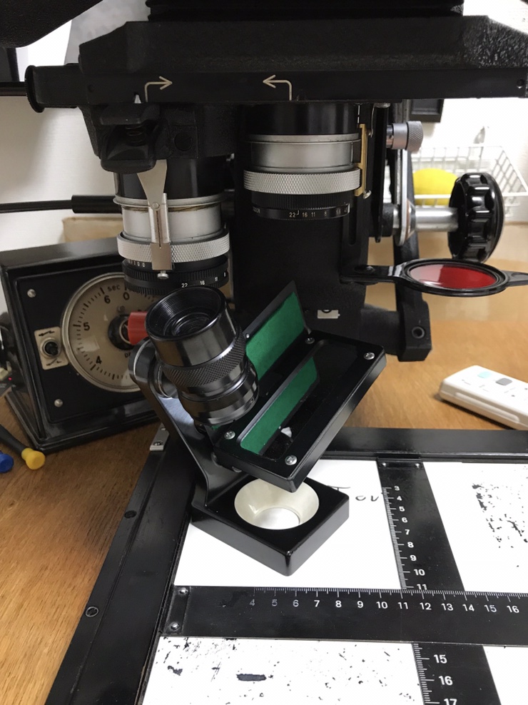

I am wondering how to adjust the autofocus on a IIc? I noticed that with the V-Elmar 100 lens the focus doesn't keep from small to large magnification like it does with the 60mm lens or my other Focomat Ic.
If I lift the head high up and adjust the focus it is good for about 70% of the length of the AF range but when I get to 5x7 inch printing size, the focus is noticeably off. If I then set the focus at that size with the pin and then raise the head, it is off again.
I looked through the manual but don't see this mentioned. I know it should just keep focus as it is but it isn't the case with me.
I use a 2.5cm tall easel and the column is set correctly - moreover AF is keeping very well with the 60mm lens.

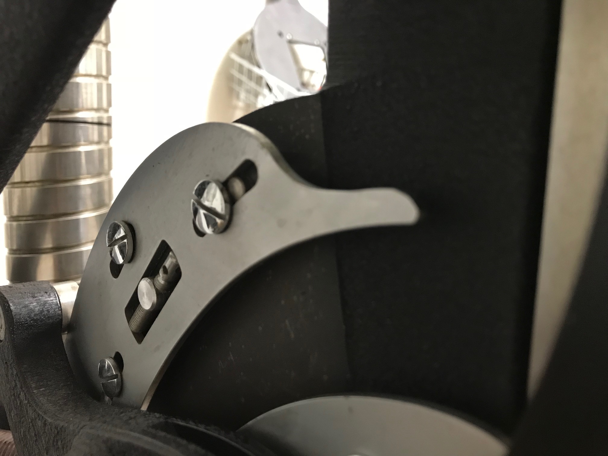

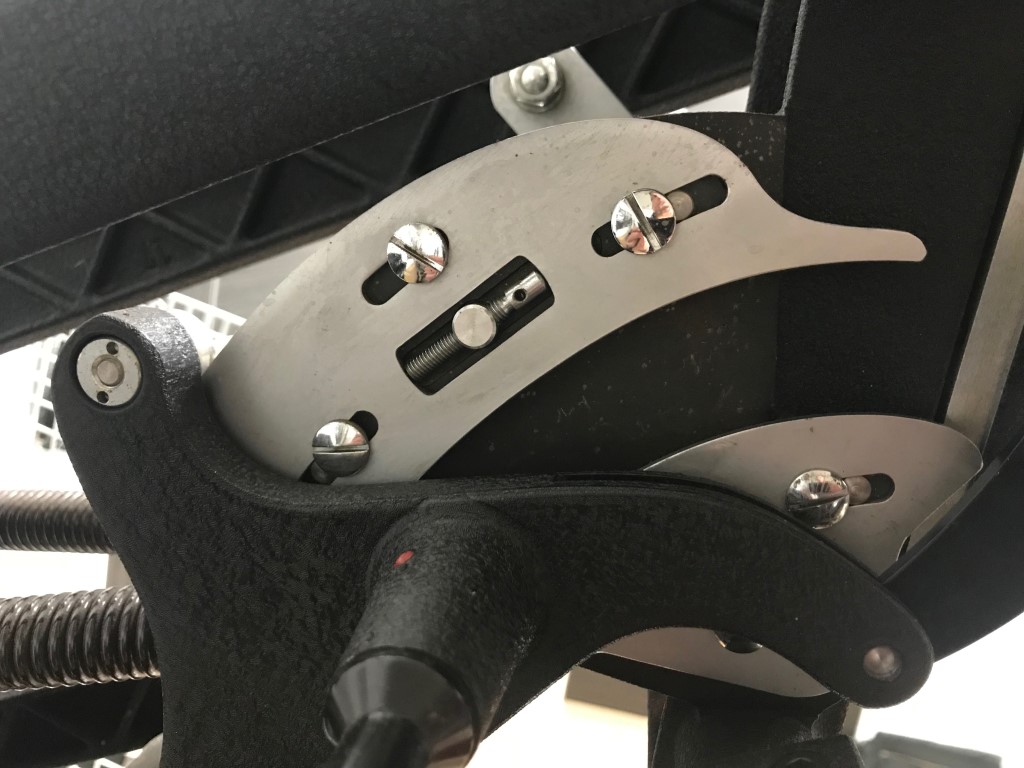

I found this dolphin shaped cam on the left side and I assume the little vertical screw is the one I need to adjust?
Has anyone done this before? I searched on Google but found nothing.
I assume the 3 screws need loosening and then vertical one to adjust the fine focus at the small enlargement? That is how it's done on the Ic so I am just assuming here.

So I am now done, below is what I did.
First of all I am either seeing ghosts or shimming the column to get full rectangular prints helped but the original V-Elmar is now working.
Yesterday I decided to finally take it apart and put shims under the column as the projected image on the baseboard wasn’t totally rectangular.
Today when checked focus again just before starting to play with the dolphin, I saw that it was spot on with the original lens.
I then tried with another V-Elmar and with a Focotar II (yes I got a bit crazy and shopped) and both those were off. The V-Elmar a bit and the Focotar II a lot! Neither was surprising.
I decided since I already made up my mind, I’ll install th Focotar II and adjust the cam to it.
It was a lot simpler than what I thought and just followed the Japanese blog I posted above.
First put the head up high to roughly the 10X mark and changed over to the 100mm cam.
I then focused and set the sliding pin to the place where it hooks in so the lens is in full focus.

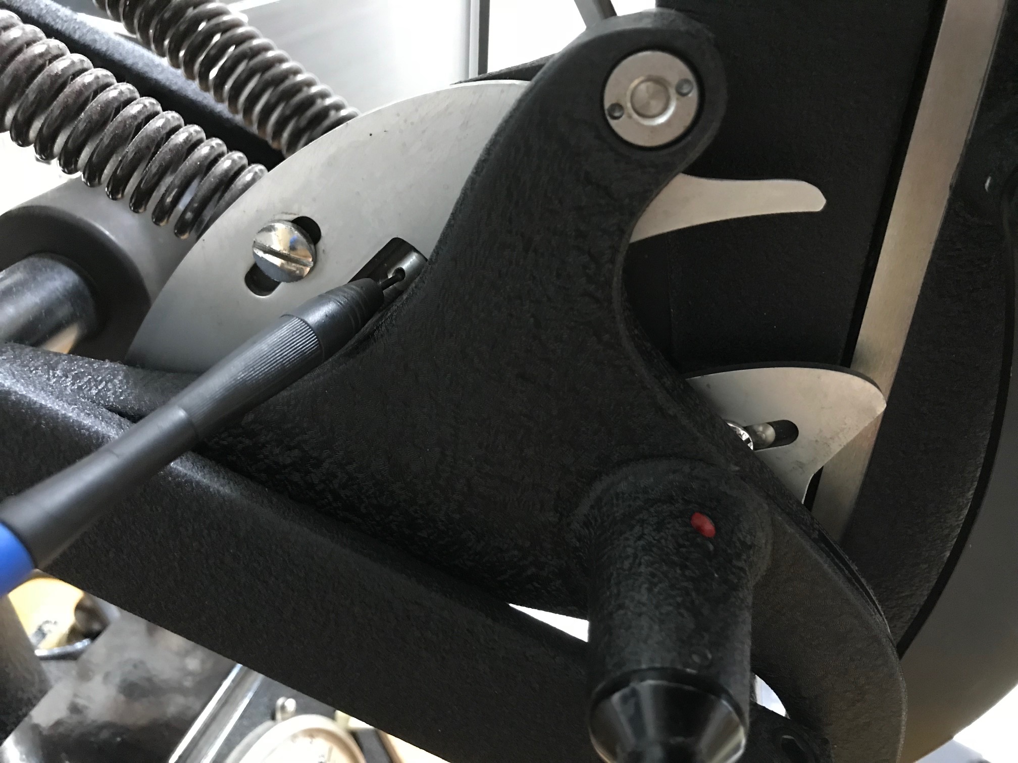

Raised the head all the way up so the Dolphin fully shows with all 3 screws accessible and loosened them just a bit:
This is what it looks with slightly loose screws:

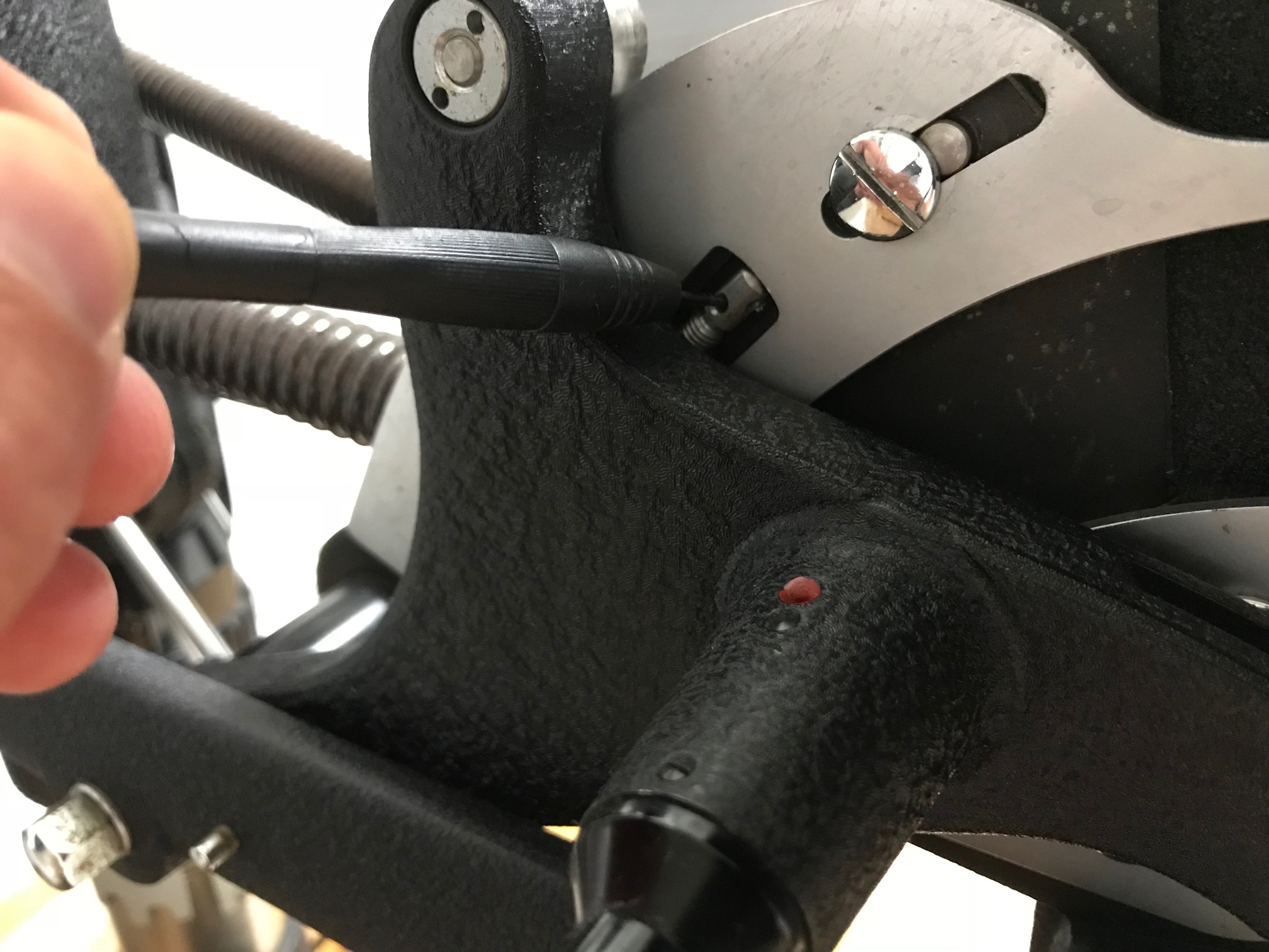

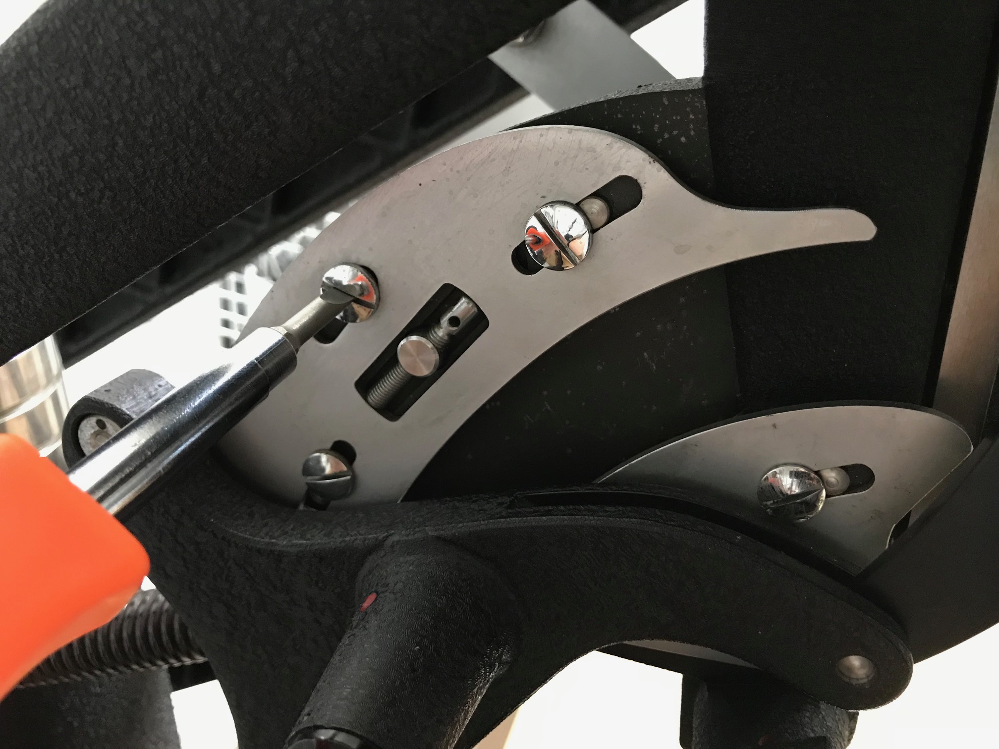

I then dropped the head about halfway down - just until the horizontal screw is still showing and put a tiny screwdriver through the hole and started turning it downwards until i saw the focus come in. This took a while, first of all I didn’t know which way to turn, second of all turning it is extremely tidious and third of all I had to get the light every time I wanted to find the tiny hole to keep turning it after I checked focus.
When it started coming into focus I dropped the head further down almost all the way until the horizontal screw revealed itself again from under a metallic arm and then kept turning it until full focus was achieved at this minimal enlargement size.
Once all done I checked again focus with the head up and middle and down and it was all spot on. I then tightened all 3 screws with the head all the way up and rechecked just to be sure.
It is now great and spot on at every level of the heads movement. So happy I went for it and tried, it is now not just nearly perfect but totally perfect, just the way it should be.
This is what it looked like at the minimum enlargement where I did the final adjustments.
Hope this might help someone else trying to do the same. It takes max 5 minutes so not a big deal.
