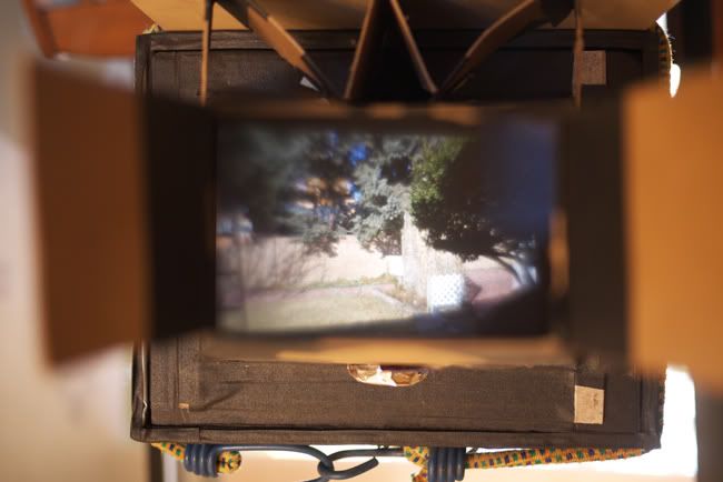

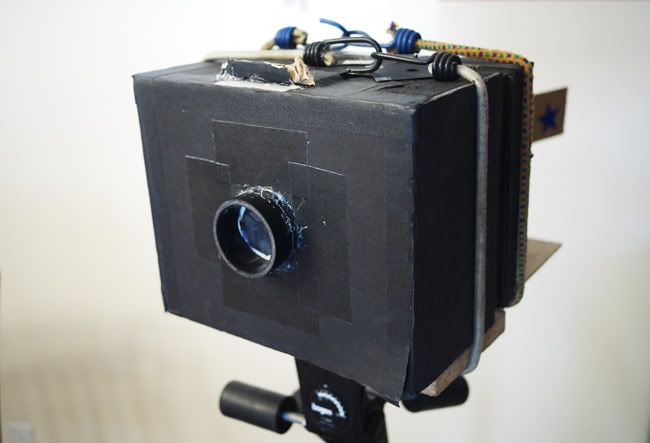

Finally finished my 8x10 that's been sitting idly in a press for quite a while. I spent ages trying to assemble some sort of complicated clever way of holding in the ground glass and film holders, eventually I settled on rubber bands

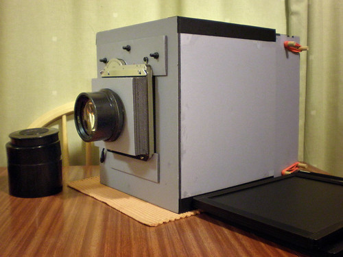

Takes normal 8x10 film holders, 300mm Industar 37 in front of a Sinar leaf shutter, all bolted onto nested foamcore boxes that do the job of focusing. Unfortunately shooting it and developing the subsequent sheets is a bit time consuming so I've only really had a chance to go through a couple of shots just to verify it was actually working. Nothing quite like a negative 8 inches by 10 inches in size
Here's the beasty itself, more notes on the flickr page if you click through.
