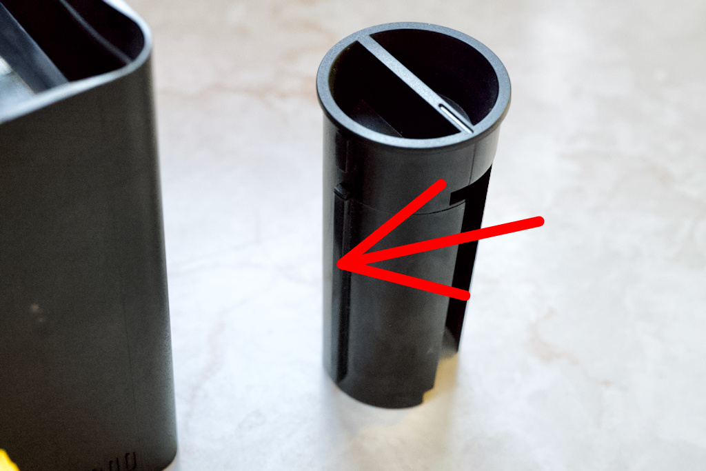

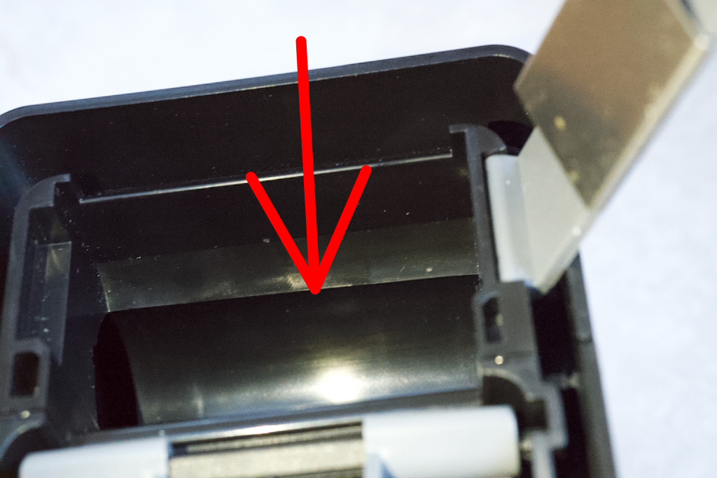

Light-piping is an issue with PET films, but there is also an effect from the fact those film bases are thicker and tougher. The rotating cylindrical shutter of the 120 tank's temporary storage spot for the film as it is stripped off the paper doesn't seem to make a good seal on the film. So while you can get wild and woolly effects from light travelling through the base material, there tends to be fogging beginning just before the first frame, most strongly just where the ridge on the outside of the cylinder is supposed to press against the film and keep light from getting in. It's hard to describe, but if you haven't seen one, the ridge on the outside of this cylinder
is supposed to rotate anticlockwise and push up against this ridge:
This deforms the film into an s-bend to a small degree and discourages light from getting past the chicane it has created. Thick and tough film bases don't deform as easily, and are springy enough to hold the cylinder open slightly sometimes.

Thank you very much!
I was not aware of this latter effect. Thus my wild guess, which I even considered far-fetched, actually applies on this tank.
Thank you for the detail photos too.
