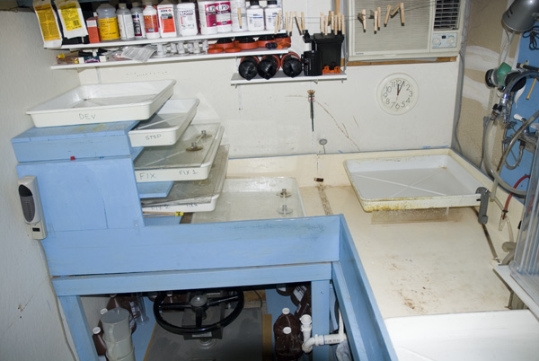

Tim, I built a "shelf" system to stack 20x24 trays. I have dev, stop, fix 1, fix 2and permawash all stacked. Then I have a 20x24 syphon tray, then a 20x24 selenium tray with a "suspended" 20x24 printwasher all in the sink at the same time. The printwasher is placed horizontally on glass blocks on each end that allow a 20x24 tray (selenium) to fit fit underneath.
I have plexi over the fix trays, the perma wash tray and the toner tray.
This stacking system allows me to print 20x24 prints from beginning to end and never move anything.
Michael

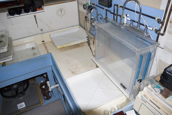

This is a very functional very unpretty darkroom. Definately not a "dream" darkroom. I print a number of 20x24s every week and needed a system to work efficiently.
I stand on a one foot high stool to put the print in the developer. From there I can just stand on the floor.
I can have all the trays working at once. From fix 2 I go to the syphon wash for 3-5 minutes then into perma for three then syphon for 3 then toner. The toner is under the archival washer. When I work it's covered with plexi.
Michael

Good set up Michael, it looks a very efficient use of footprint space.
I would find it difficult to operate for some processes though, but for straight B&W/Selenium it looks ideal.
For lith printing it is necessary to interrupt the rapidly accelerating infectious development by swiftly moving into stop bath at the precise moment, so having then next to each other is better for me. Similarly, for bleaching I like to have the bleach next to a deep sink with a hose so I can hose off the bleach fast at the right moment.
I like the raised washer over the Se though. I could definitely use that idea for one or two things I do. Thanks for showing me.
Tim

Tim, the tray on the bottom of the stack is permawash and can slide under the "shelf". So there is room for an extra 20x24 tray on either side of the siphon wash. When I do sepia or the rare time I do lith I change things around a bit.
The syphon wash is elevated by a plexiglass "stand" because the drain is under there. For the archival print washer I just bought a couple of glass blocks ( the ornamental ones people use instead of windows) with a fairly thick piece of plexiglass under the washer. A 20x24 tray fits under there with room to add and remove a plexi cover.
Michael

Michael, what's the thing with the steering wheel under your sink? It looks like a dry mount press, but I've never seen one like that. Looks like you could press small animals under that (not saying you collect flattened animals or anything...).

It's called an Ademco Press, made in England I think. I had one that I bought used in my studio in Canada, I found one here in a photography store that was used also for $400. It does 20x24. Instead of a handle to press down it has the steering wheel that you spin down to press the print. I printed hundreds of prints with them, as well as canvas mounted prints. They work great and weight a ton.
Michael
