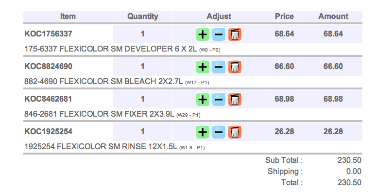

Ok...Last check. Here is my pfsny.com cart and the total is $276 including shipping.
Does anyone know how much I'm saving by doing this?:blink:
