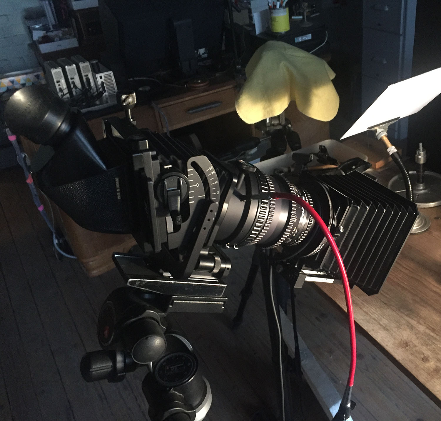

I couldn't do without them, as I use my flexbody mostly in close-up with a120mm.
A while ago I saw a set on eBay, rather expensive...
