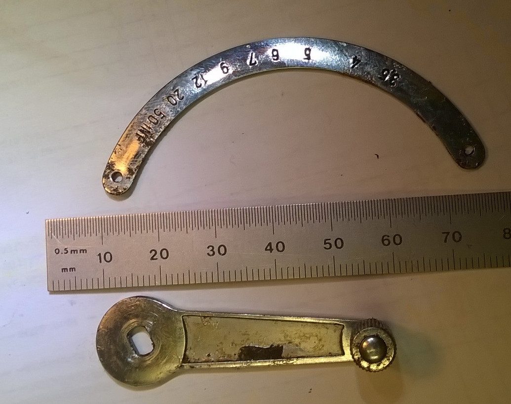

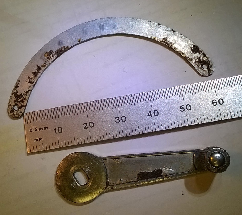

Hee are a couple of photos of the worst of the corrosion. I thought that the range scale was chrome plated, I'm not so sure about the film advance lever, does nickel plating come off in hard flakes? I'd like to have them look nice and to have the range scale to be readable, and the biggest obstacle to that it seems to me is removing the corrosion and the old finish without damaging the scale more than it already has been.

Try the acid bath method. I've used household vinegar (10% acetic acid) overnight, then next morning I've used toothbrush to scrub off the rust. Hard flakes sound like chrome plating.
I'll try that, no problem finding acetic acid. If I get all of the plating off then I must decide what to put back on in it's place.
