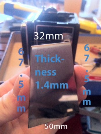

If you want to brighten the viewfinder, you can probably get get a new mirror cut by marty1107 on the bay.
I don't have any connection to him but I needed a mirror for my Ikoflex II/III. I pulled the old one and measured with digital calipers, sent Marty the measurements and he was able to send me a perfect replacement. Very affordable as well.

You can email Marty at martywaw@gmail.com. I emailed him the measurements (see attached) and he cut the mirror and created an auction for me to buy it. Now he has the measurements and offers the mirror for others who might be looking for the same. I attached the measurements I sent him.
