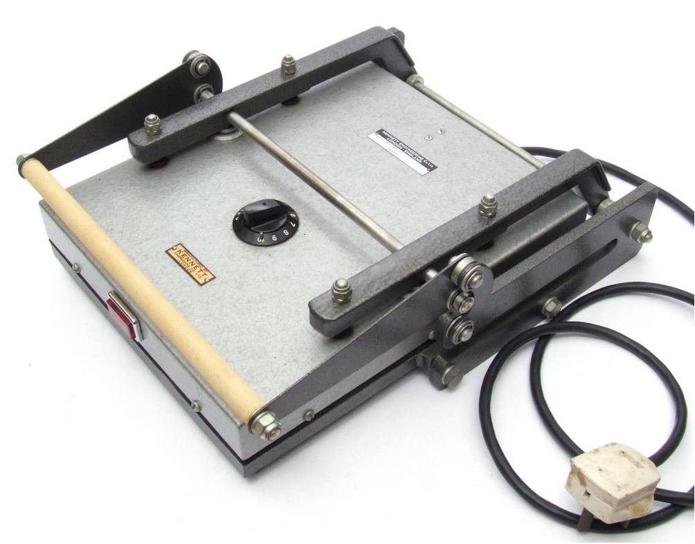

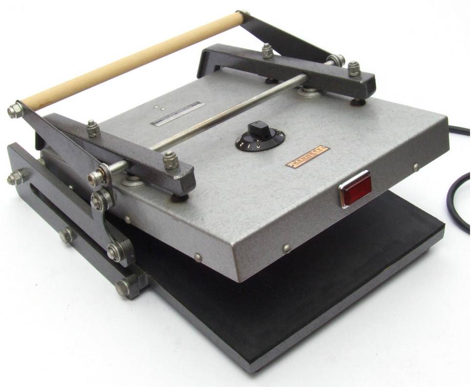

Hi all,
I will buy a Mounting Dry Press
I will flatten my Carbon Printing on Aquarell paper but i don't how process.
Are you help me how process
Can you explain me how to flatten a Carbon Print on a watercolor paper with a press gelatinized
I just bought this release
Thank you for your advice
Philippe
