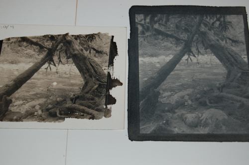

1.The test strips - that look so nice - are on the B side.
2.The FeOx was mixed in April, and has been refridgerated when not in use. Last year was the year I dealt with old FeOx, dumped it, got powder that wouldn't dissolve from a Canadian supplier, got my money back, and got good stuff from B&S.
3. Developer is ammonium citrate. I'm not sure how old it is, but it was filtered before I put it back in the bottle the last time I was printing pt/pd. I forgot that I've got a bit of Pot Ox. I've not used it, as my sources say it is less contrasty. I assumed it wouldn't solve the problem.
The test strips were done this afternoon, just before the crappy prints. I realised this problem has been going on for awhile, and was just very striking and obvious today. I've got lots of crappy prints frrom sessions this year, where the test strips had looked promising. I was thinking I was making errors - poor (too thin) application of solution, not counting the drops properly, or not crossing my fingers and whistling at the right time.
I'm thinking of the clearing bath as the big difference between pretty test strips and flat prints is that the tests, in their previous incarnation, have been through the developer, EDTA, and washing. I'm not complaining that the EDTA is not working. I'm wondering if it is doing something to the paper that makes it work better.
I'm including a side-by-side digisnap of a test strip and a nasty print. They're still wet, but cleared.

I think you've changed the paper on your test print. You've acidified it, broken down the internal sizing somewhat and I think there is a surface sizing on side A.
I really like your test strip, lovely warmth & contrast. So you could try giving it a soak in EDTA, but that seems like a shame to pretreat a fine paper like COT.
My guess would be that your test print would allow the sensitizer to absorb more deeply and hold on to the moisture better. So short of pretreating maybe a bit of tween or humidification.
