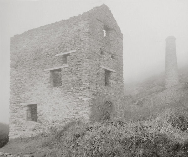

It's also useful to learn how to make the most of flat lighting, you can get mazing images. Can't get much flatter than fog, or sea mist.
Cornwall in the fog.
Ian

For example, in Ian's shot above, he could have given less exposure to achieve deeper shadows, and then developed longer to achieve similar highlights. That would have created a different mood in the photograph however, and that may or may not be what you are after.
