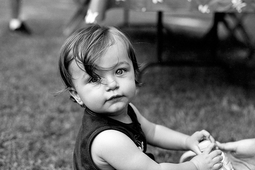

This photo came from a roll that popped open when I dropped on the sidewalk. I had just rewound the film and was taking it out of the camera to put it into a canister. I fumbled the camera and, the moment the cartridge hit the ground, I knew by the sound that the cap had popped off.
Luckily, the film didn't fall out of the cartridge. Only the end cap came off.
I have a few of the old, metal film canisters that Kodak used to ship film in. I quickly picked up the cartridge, stuffed it into one of those metal canisters and screwed the lid on tight.
When I developed the film, everything up to the sprocket holes was toast but only a very thin strip along the bottom of the image was burned. When I made the print, I was able to crop it out.
It ended up being cropped a hair bit more than I wanted but it worked out anyway.
A half second is a long time for film to be exposed but, I agree, develop it anyway. You might get lucky.
