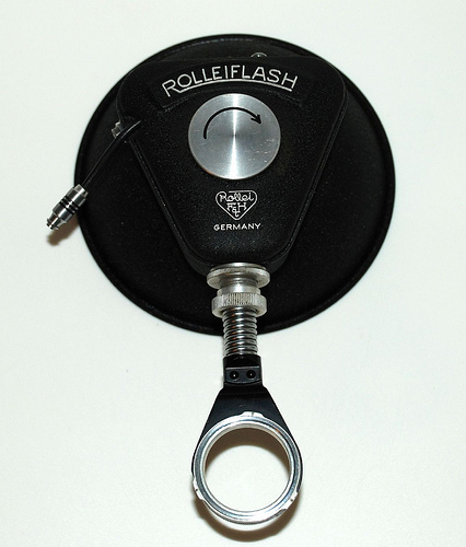

This is the flash that I want to end up with, except I don't have the lens mount for it. The threaded part is 3/8-16 to give you an idea of scale, I forget the diameter of the reflector as I just received them Friday. It originally used a 22.5 volt battery that is square and the size of an AA cell. I will probably have to build a custom handle to mount it to the bottom of the camera, and that can probably hold the power source.
I also have a newer style that did not use a battery and does not have the coil up cord. This will probably be the prototype housing since the one with the coil up cord has more character.

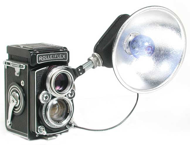

I'm reviving this thread because my wife Melanie
wants a flash for her Rolleiflex. Has anyone since
this thread began tried to convert a Rolleiflash?
Or is anyone aware of the folks who have made
or are making the conversions?
