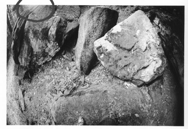

This thread is probably useless without an example of the type of work I am doing with the fisheye. This is one of the better images but you can still see an aura on the upper left edge from the flash. I presume from illumination of vapor and dust in the air and/or flare. Potato-masher flash on a bracket to the left with a dome diffuser.
Yes, my feet are supposed to be in it, that is what this work is about it is an extension of self portrait. As an aside, I have a long-running body of work since the 1980s dealing with self-portraits, however, since the advent of the 'selfie' I have either given up or moved away from anything that even remotely resembles that heinous style.

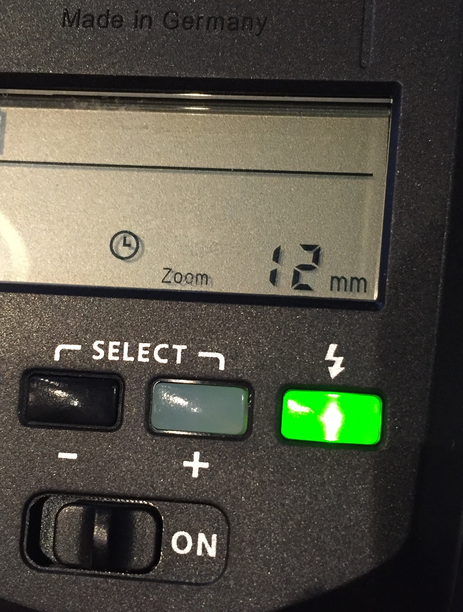

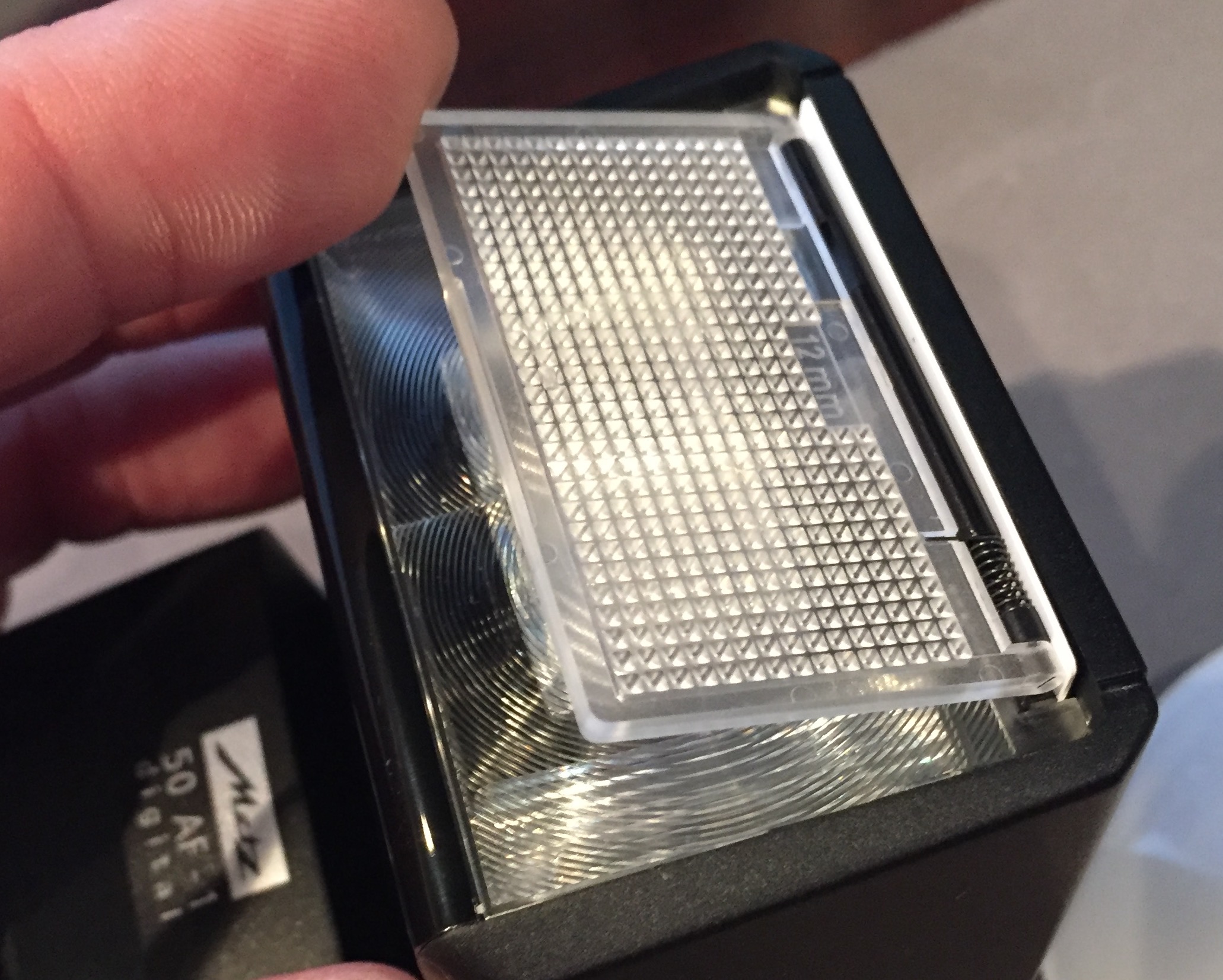

Re-visiting this issue. I got a Metz 50AF flash with some other stuff. It does not work TTL with any camera I own and it is not an SCA flash. However, it works fine on Manual mode and is quite powerful. It looks brand new also.

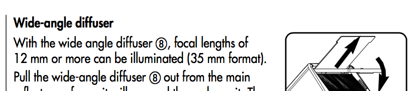

It came with a nice diffuser and even without the diffuser it has a zoom setting of 12mm (full frame 35mm format coverage). That 12mm coverage is pretty remarkable, I have never seen a flash that covers that wide and I can't think of a full-frame 35mm lens that short (any one??)
I did a few tests at the 12mm setting with no diffuser and with the diffuser. I did the tests on Instax film (in a Polaroid back) I think the diffuser covers the 180 degree fisheye view just a little better.
Not 12mm FL, but 24mm FL. Only with the built-in optical diffusor 12mm is achieved.
But nevertheless that is remarkable. The classic AE electronic flashes of the past got a coverage equivalent of 35mm FL. Only by accessory optical diffusor 28mm was reached.
However those optical diffusors use all emmitted light. The diffusor you show is the milky, extreme diffusor spreading even some light beyond 180°.
That is a very interesting flash that somehow slipped my attention. Should I come it across for cheap I shall take it. It yields FP and 2nd curtain mode and even in full manual that extreme coverage is outstanding.
