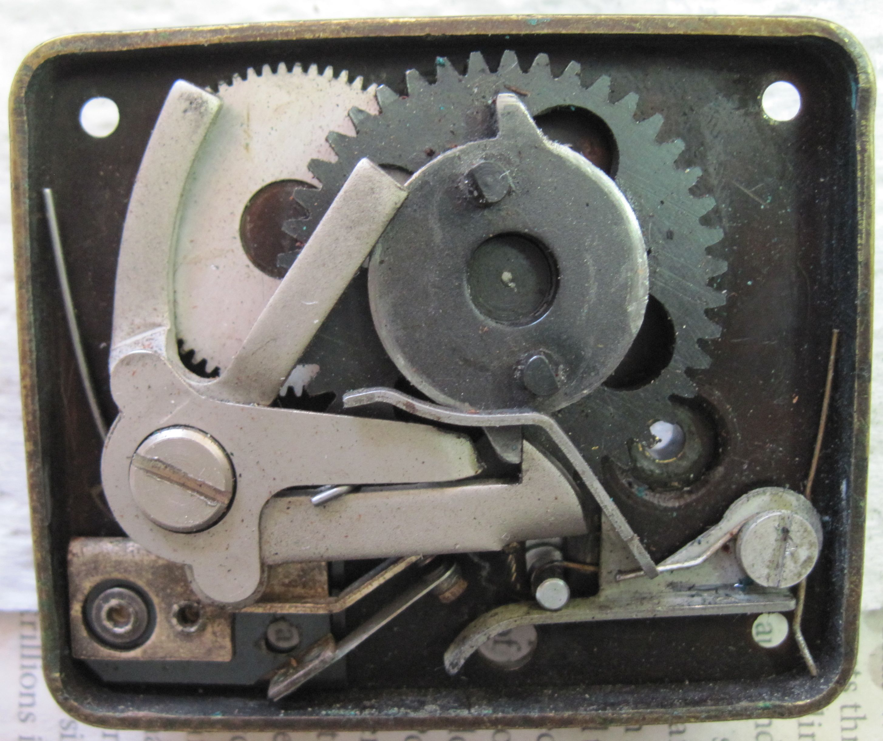

I have seen a 3rd party flash sync on vintage Graflex SLR's that was a metal housing with Bi Post pins mounted on the side of the body so that the H lever would make the switch contacts when it reached the top of its travel. (the H lever is what is used to set the mirror to the closed position) The sync was period correct for the camera.
The average speed for an aperture opening to travel across the 4 inch dimension of a Graflex SLR is 45 to 55 milliseconds depending on the condition of the shutter.
This is the wind plate from a 1947 Super D 4x5.
The flash sync contacts are bottom center.
It fires the flash on curtain opening. Curtain at O, tension at H (highest tension), tripping the shutter gives about 1/5 second for a flash exposure.
http://graflex.org/RBGraflex/
