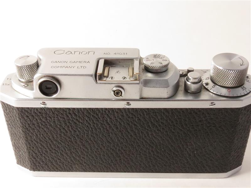

Here's a pic of the camera's PC socket. From what I can determine from pics of other IIb's, they removed a screw, and put the socket where the screw was.
