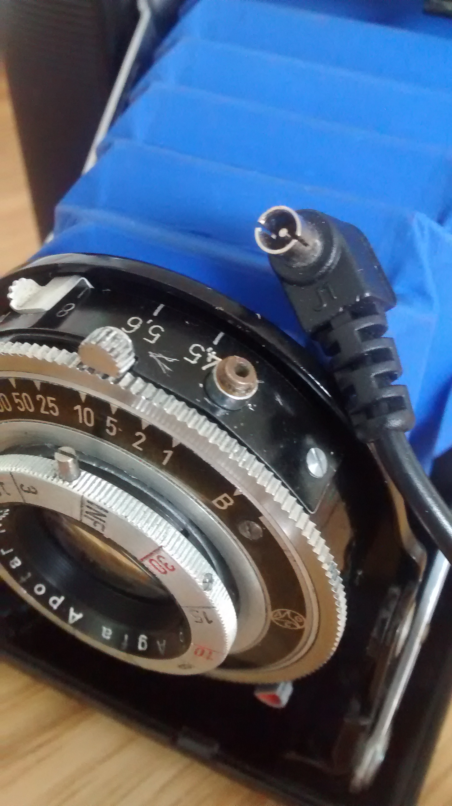

Greeting apugers,
I have a question about sync cords for my isolette ii prontor s unit. The manual on butkus and every google search indicates that the camera has a standard 3mm sync terminal. I used a standard sync cord and it doesnt seem to fit. The cord fit fine on all my other gear but just wont go in on the isolette.
Please advise if the port shown in the picture requires me to pick up something other than a standard cable to get flash on this beauty

The standard german synchro-connector is of the "PC" (Prontor-Compur) type. Your male plug is the right one.
Your female connector does not look like an original PC one. But rather like one hampered with or even something different. In any case nothing like I have seen. In the original the outer contact tube is about as long as the inner contact tube, and the isolator at level or slightly protruding. But then not as far as in your case.
If there is a chance to easily manipulate a PC male plug to make the connection, you could look at a rummage box for a short PC hybrid-/extention-cord and modify that into a custom-made adapter.

Thanks agx. This unit was purchased as serviced and ready to go a week ago. I will investigate if the sync terminal was modified or changed during repairs.

The cord is right. I've never seen a flash connector like the one on the camera.
I may have led a sheltered life.

Mystery solved by jurgen from certo6.com
Apparently I have a pre-war lens with the older pre 1949 flash post which preceded the modern format. Jurgen said that these posfs are common on lens measuring in feet instead of metric.
TLDR: port is old. Get a camera thats metric next time if you want flash.

And what male connectors did those posts take?

If you want to mount a standard PC synch post it should not require much work. I have a nice pre-war Agfa Record that I was able to retrofit. It doesn't look wonderful but it works. If you aren't comfy diving into a Prontor shutter you could have someone do it for you.

no idea what connector the post takes, perhaps Pioneer can show us his?
