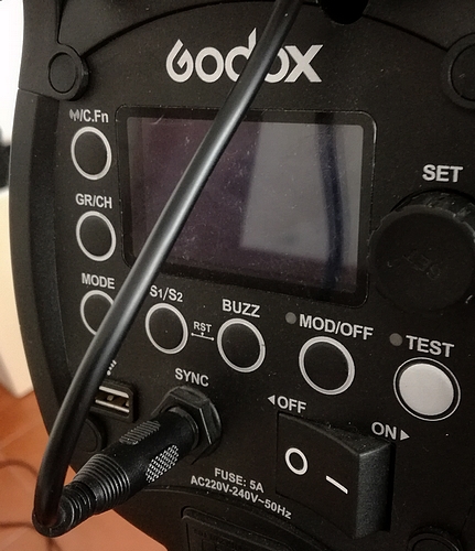

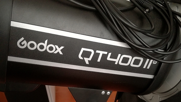

I have access to several modern Godox flash units. They have a cable that allows them to sync with a camera.

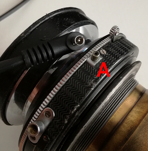

And I have a vintage mid-sixties convertible Symmar lens that I intend to use for in studio photos.

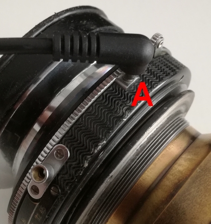

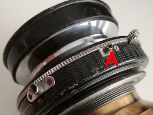

That lens has a connection that (I believe…) allows the synchronisation between the lens and a flash unit- connection marked with the red A. The cable from the flash seems to fit the A connection
My questions – can I use that cable reliably ?? Is there any possible incompatiblities between a vintage lens shutter and a modern flash unit ? Any risk of damage to the flash ??
As the Godox flash units do not belong to me I want to know the risk of this conecction - if there is any risk…
Thank you for your advice

What you got is the standard german female "PC" synch connector.
You hardly can do something wrong with it, whether concerning the flash or the shutter.
Such connector leads to a simple mechanical switch closing an electrical circuit inside a flash, of whatever kind.

That is in fact a PC (Prontor-Compur) flash sync connector. And yes, old mechanical shutters are completely safe to use with modern electronic flashes.
Yes, there was a period when electronic flashes had high voltage (in some cases, up to 600 V) present on the sync terminals, and those are capable of damaging unprotected electronic sync shutters (like those in some of the late generation film cameras and early DSLRs), but even among those, there were only a couple obscure models that I'm aware of having damaged the metal mechanical contacts in a mechanical leaf shutter.

As "B" stands for BIRDIE...
Can you show an example with that "A"?
But of course at german leaf-shutters "A" stands for "Automatik", but this is so obvious that I can't believe you are referring to to such. Thus my request for an example you have in mind.

I was going to say, take a photo and see if the film is exposed. My understanding is "M" was for flash bulbs that took time to reach intensity, so it triggers a little earlier, to give a few extra milisecods to reach full intensity. Modern flashes are faster so X sends the pulse much closer to maximum opening. I'm not sure, but the lever CCW from the PC socket in the OPs photos looks like it might be the flash speed. If the shutter is reletively modern (i.e. all black Copal for instance) I suspect that X is all it does.
