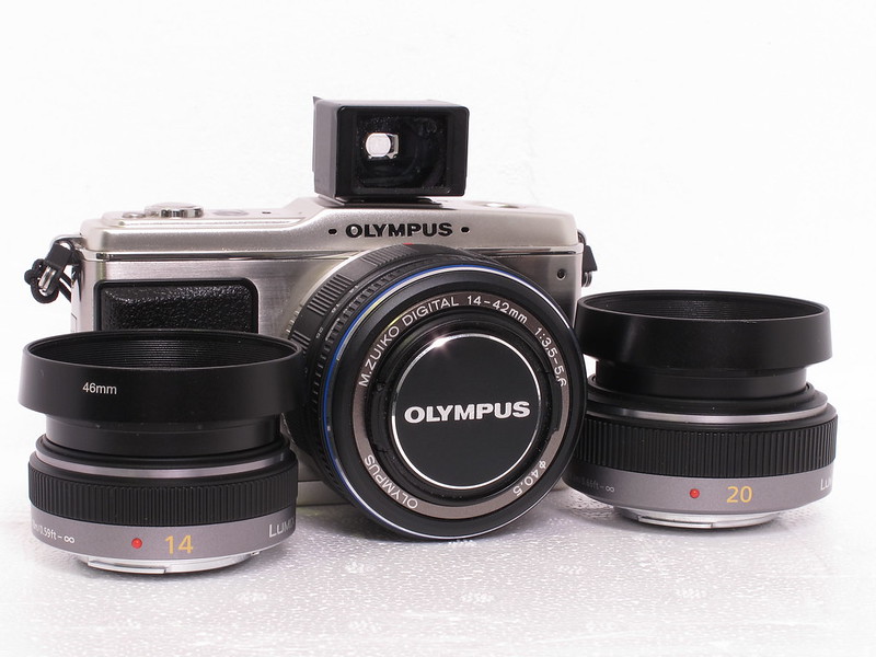

The lens is roughly 35mm, so that's quite standard. The problems are that (1) the format is 6x4.5 rather than 3:2 ...
The 645 aspect ratio is the same as a micro 4/3 camera.
Mounted on the micro 4/3 camera below is an Olympus VF-1 accessory viewfinder. This viewfinder was originally designed for a micro 4/3 lens with an angle-of-view that was equivalent to a 35mm lens on a 35mm film camera.
Olympus E-p1 by Narsuitus, on Flickr
