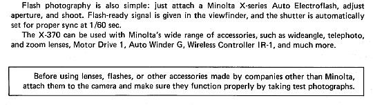

From what I can work out from the manual, the extra contact is to tell the camera that it has a Minolta flash fitted so I expect the flash either puts a voltage onto this pin or connects it to 0v. The camera detects this and sets the shutter to 1/60 (flash synchronisation speed). If the flash is putting a different voltage onto this pin it may well confuse the shutter. Probably not much potential for damage though.
Steve.
