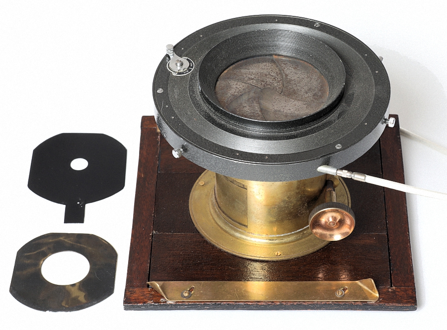

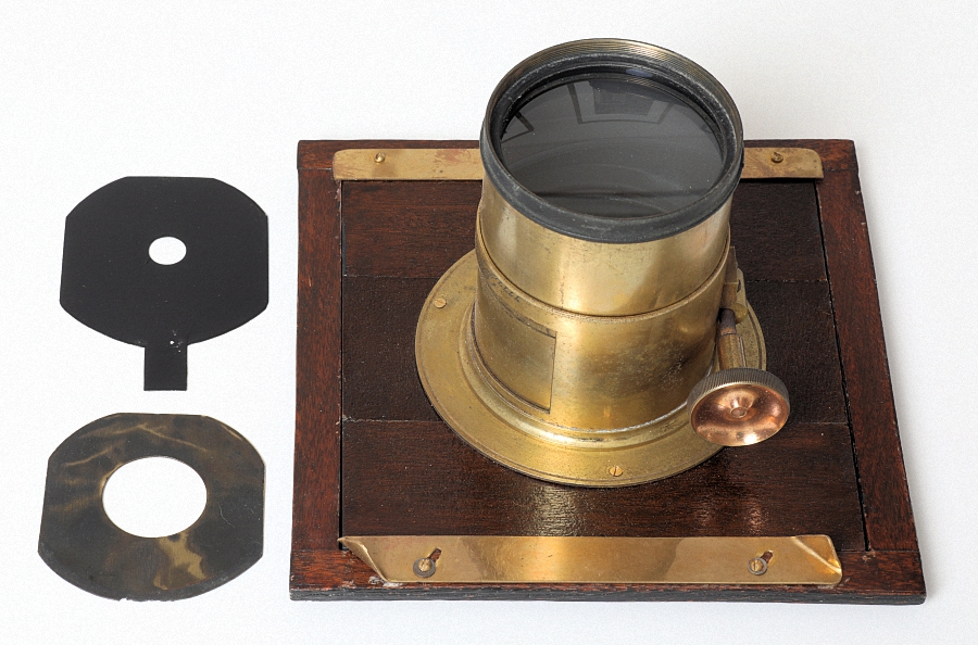

I have single speed front mounting shutters with flash sync, I was using my largest a Gitzo with my 1863 10" f4 Dallmeyer Quick Acting Portrait Petzval a couple of weeks ago, works well. I have Thornton Pickard roller blind shutters for regular shutter speeds, or mount the lenses on a Speed Graphic.

My 1863 10" f4 Dallmeyer Quick Acting Portrait Petzval, with the original f8 stop, and a quickly made f16 stop, which is what I used.
With the Gitzo shutter which is a perfect fit, I have removed the lens hood :D
And a couple of image made with this combination on 5x4 sheet film, a reducing back on my 10x8 Agfa Ansco Commercial View, the lens will just cover Half plate/7x5
