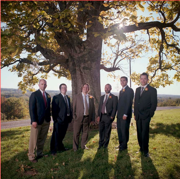

Nikon and other flashes off camera, normally unmodified, bounced if available. A voice activated light stand helps greatly with things like holding lights on a boom, adjusting output on manual flashes, wrangling stray people into the frame, etc. Normal assistant stuff.
Here is a shot for a wedding a few years ago- backlit from sun, main light was camera left and high, Nikon SB26 on ~1/2 power zoomed all the way out and on a boom being held by an assistant. Portra 400, Bronica SQ-a 50/80mm?

When using flash for fill light, like in the pic of the men under the tree, on camera flash is fine. One does not (usually) want fill light to create a secondary source of shadows, which can look unnatural.
