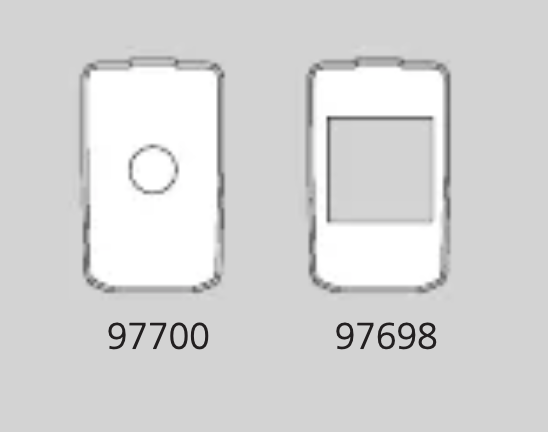

I always wondered if these metering backs were nothing more than the rear body protectors with circle or square on them.
Likely, the backs have necessary interlocks to fool the camera into thinking there is
  • back is mounted, darkslide is removed
  • film advanced to fresh frame
  • ISO setting for meter

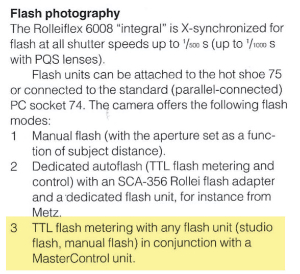

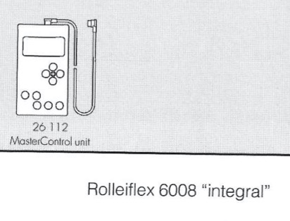

I consulted both 6008 and Hy6 user manual for accessories used with the cameras, but the Master Control Unit is not listed. There is a 64872 LensControl S, which is used in conjunction with the X-ACT2 monorail camera
There are a lot of models of the 6008. The 6008, 6008 Professional, 6008 Integral, 6008 Integral 2, 6008 AF. Plus the original, the 6000. The Master Control is only for the 6008 Integral as far as I know. Ditto, the flash meter FM-1 is only for the 6008 Professional. The Lens Control I think will work with the 6008 Integral, but it is a different animal altogether. I think it may be necessary for the Xact2, but I don't know a whole lot about that set-up, just that it allows you to remotely control Rollei lenses & shutters.
The 6008 manual which I downloaded from Rollie was for the 6008AF and the Integral 2.
Paging thru all pages, there is no reference or photo of an optional Master Control unit....all flash metering functions were self contained to the camera body (apart from SCA TTL flash metering.
