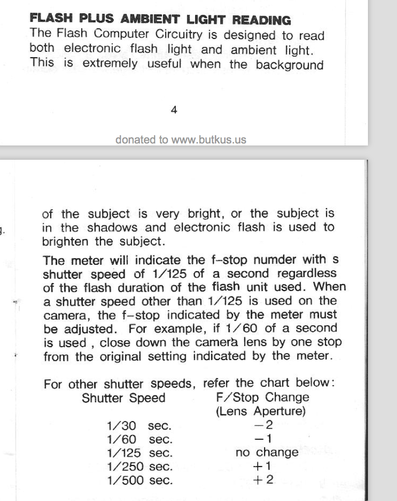

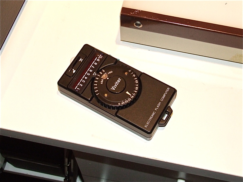

This is my Vivitar meter, does you meter look like this? It was sold under different names. The manual is on Butkus under "Shepherd FM800." Here is a clip from the manual on existing light measurement:

ic-racer,
That's the one! Your post is very helpful. No other info I have found talks about the 1/125 second shutter speed.
Manual must've been written in a hurry (or by non english-speaking persons)...a few typos

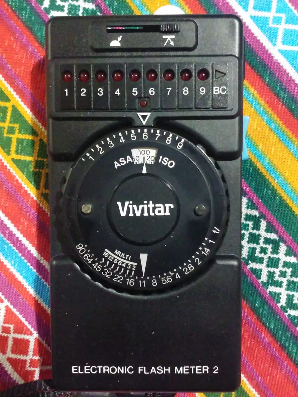

I have the Vivitar Electronic Flash Meter 2 and it measures flash and ambient light. The speed for ambient light is 125. It is not just a flash meter.

Pieter12
Aug 20, 2017
7,594
Magrathean's computer
Super8
An ambient light meter that just meters at just 1/125 its pretty limited in application. It seems designed to take into account ambient light when it is quite bright and might contribute to a mixed light exposure, like fill flash. Not something that seems ideal or easy to use. I would shop for a proper meter, like a Minolta Flashmeter.

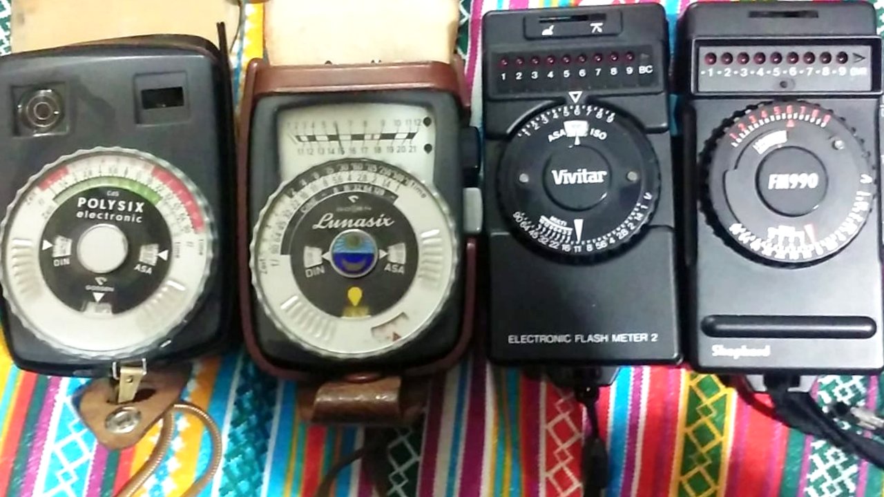

They were the first flash meters to measure flash and ambient light. From this model Shepherd took out several imitations. Today I compared them all to each other with a gray card in iso 100. The winner was Polisyx Gossen. And the Lunasix too. Vivitar and Shepherd had to change the iso to compensate for 1 or 2 stops. Also compare with Lightmeter for android. That very dangerous !!!

ic-racer
Feb 25, 2007
16,544
USA
The reason that I have the Vivitar pictured in post #10 AND a Sekonic 588, is that the 90% of all my flash phogography is under conditions where the INCIDENT meter of the Sekonic 588 is impossible to use. I need a averaging REFLECTED flash meter. As nice as the Sekonic 588 is, it can't do reflected average flash metering.
