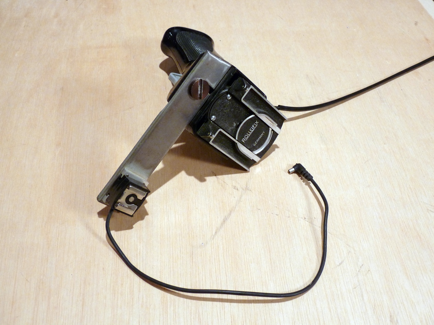

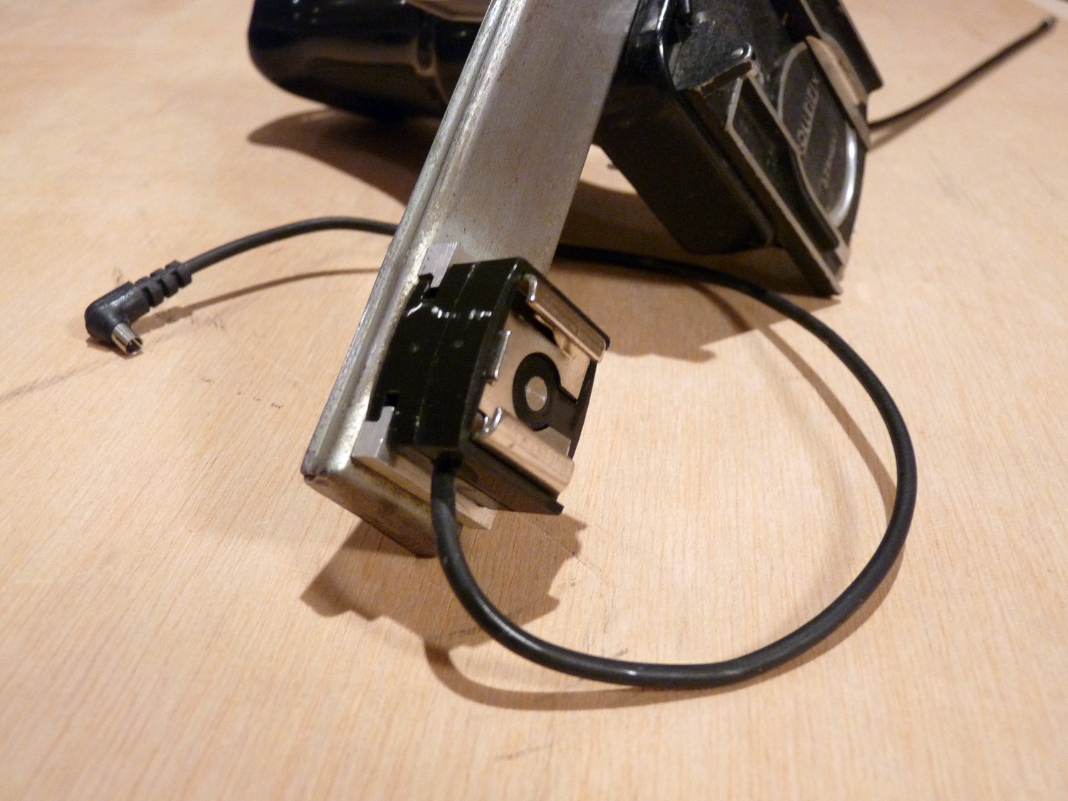

I made one about 40 years ago from a metal channel from a drawer slide. I used an adapter to convert a non-hot flash shoe into a hot flash shoe. I just used it to mount one of the flash units for my 35mm cameras (currently an SB-80DX). I hardly ever use flash for MF, but this comes in handy for doing ceiling bounce flash using the auto features of the flash.
MF seems obvious to use flash for, given the somewhat more deliberate use and the relative slowness of the lenses.
I almost always use som kind of flash or at least bring it, for any kind of photography.
Shaping light, even with a light (sic) touch is part of what photography is about to me.

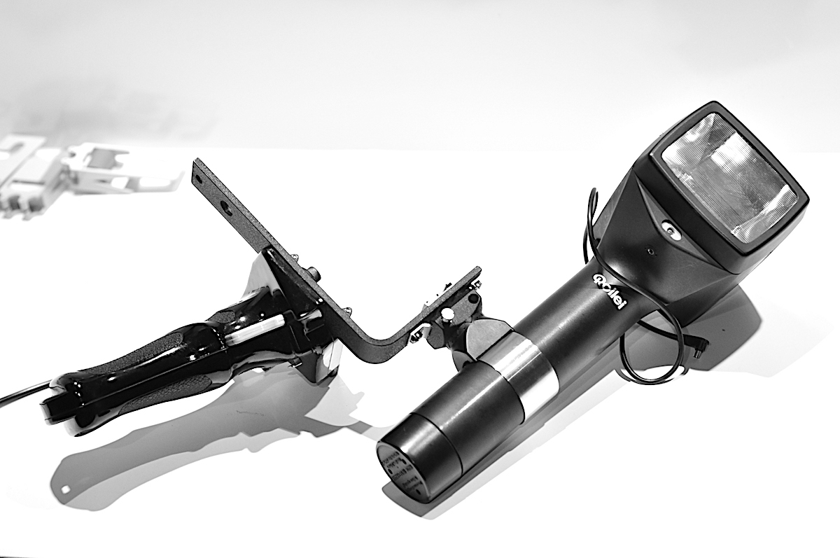

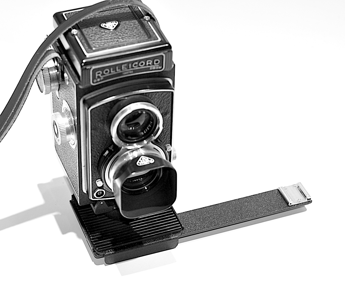

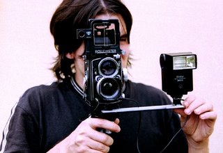

These are the two flash brackets I use with my TLRs:

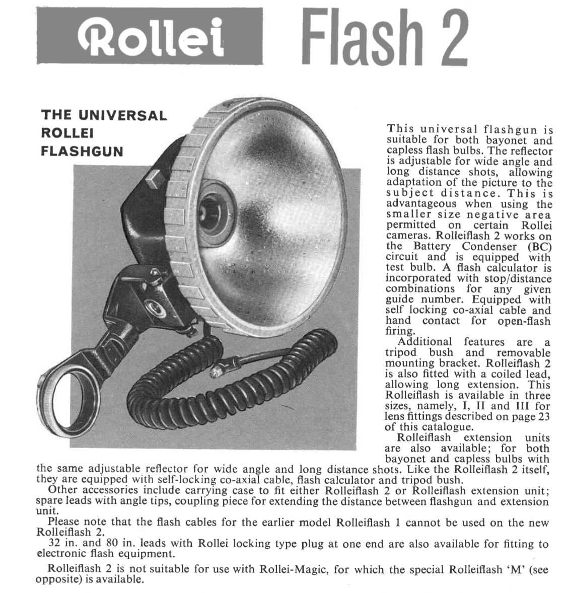

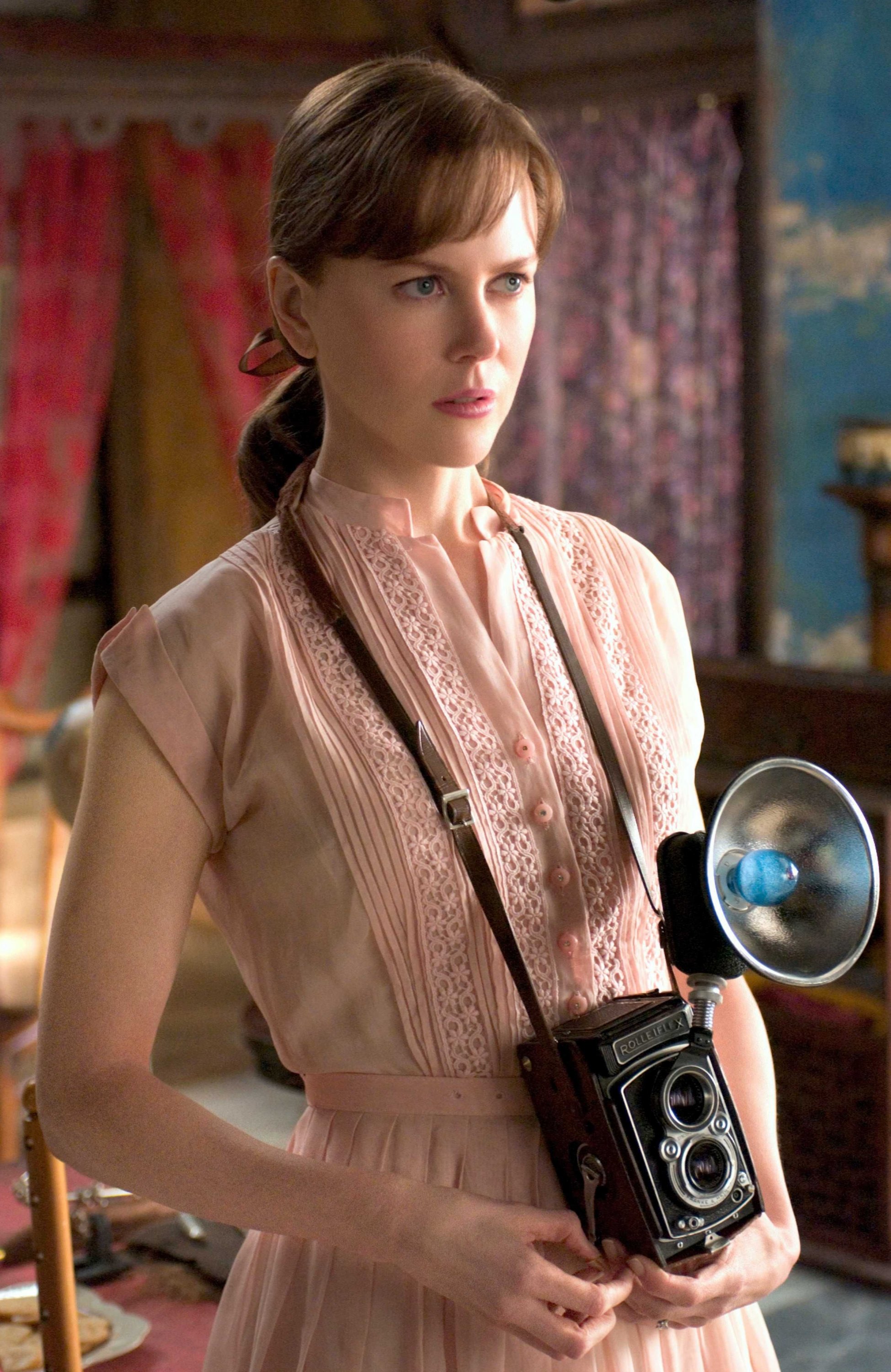

For flash bulbs you might consider the attachment that goes on the bayonet ring of the lens
Seems like madness to attach a relatively heavy flash to the bayonet on the taking lens.
Giving it a lot of leverage to wreak havoc if you should bump it or just twist or turn the camera a bit enthusiastically.
It seems the only right place for a flashgun is on a bracket coming out the track on the pistol grip. You’ll need a handle to grip with a flash mounted on the side, and what better place to put the handle, than underneath the point of gravity.
Are there model numbers on the two brackets you posted pictures of? I seem to have trouble finding them in catalogs and descriptions.

As I recall that bulb-flash attachment is pretty light weight. This one is spring-loaded in case it gets bumped.

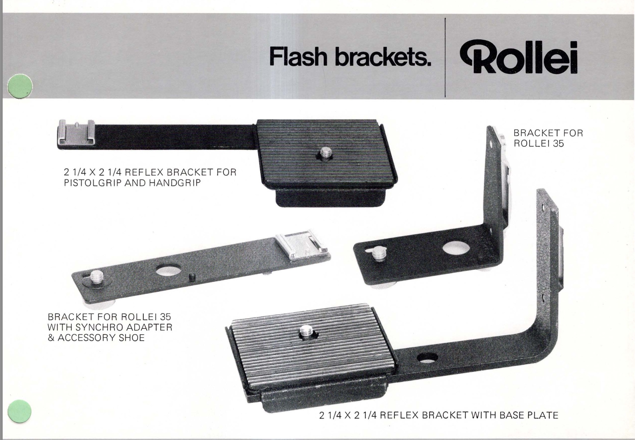

Curious, this brochure does not give any part numbers.
Awesome IC! That will get me going.
I want to tilt the flash up or to the side. In fact that is my default way. Direct on camera flash is the last resort, even for daylight fill. That is also impossible AFAIK with the bayonet flash.
The Rolleiflash is intended to attach to the bayonet of the viewing lens. Not much of a difference, I know. If there was a substantial risk it seems that Rollei wouldn’t have sold it over so many years. Today, in addition to not having features you desire, there is the drawback of a very hard to find, and expensive if you can find, 22.5v battery. At one time that battery was very commonplace but hasn’t been for quite a while.
Helge
Helge
Jun 27, 2018
3,938
Denmark
I don’t know about that.
1. People where more diligent, had better dexterity and simply took much better care of their things back then. I aspire to be like that.
2. Rollei in all their greatness and knack for good industrial design, made some real faux pas once in a while.
The flash on Kidman’s camera above, which I have, is the most well designed bulb flash I have ever seen.
Solid and well designed to a tee, apart from the mounting.
The battery is a problem. Not because 22 volt battery’s are not existent, but because the ones that are sold is just a millimeter or two too wide to fit this flash.
Should not be a problem doing a custom battery with two 12V standard cells though.
