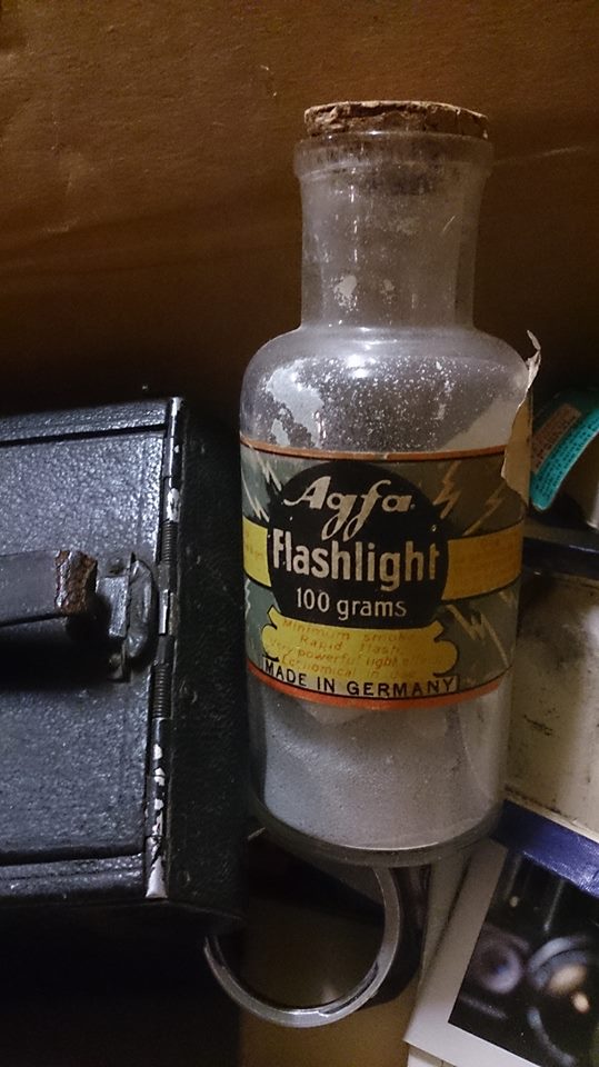

Hi Folks,
Today I got a call from someone, offering me a whole bits and pieces that they wanted to get rid of. In the box I found a flash bar and a partially full bottle of Agfa Flashlight powder.
While very cool, I am concerned what the powder is and whether it is dangerous. Can anyone fill me in?

I found a reference in one of my old books, Handbook of Photography by Henney and Dudley, 1939
"Flash-light powders usually consist of a mixture of magnesium powder and an oxidizing material like potassium chlorate. Since these mixtures oxidize rapidly with almost explosive violence, they must be handled with care. They may be ignited by means of an open flame, a fuse, or an electrically heated wire."
The magnesium powder is dangerous in that it burns with great heat, and ignites relatively easy compared to many metals, but otherwise is probably not particularly more dangerous than a magnesium machine part.
I have no idea about the potassium chlorate though.
As a first step, I'd probably seal the whole bottle in a plastic bag so as to exclude air and moisture, though from the looks of the cork, it's probably had plenty of exposure to air and humidity for a few decades.
I hope this helps.

Very cool; VERY. But I'd probably treat it like black powder for guns - an explosive that any spark could ignite. Dumping the powder and displaying the empty container may be the prudent thing to do. VERY COOL.

Hmmm, yeah. I have googled properly disposing flash powder, which in my area means contacting the police. I am sure the bottle won't be returned.
EDIT: Found the following information here - http://www.archive.org/stream/agfabookofphotog00barrrich/agfabookofphotog00barrrich_djvu.txt

I found this at the link you posted, "The complete book of flash powder", which has some guidelines for handling, etc.;
https://archive.org/details/The_Complete_Book_of_Flash_Powder
FWIW, my book does state that aluminum powder is sometimes used. From your link it seems that your Agfa product may not be magnesium and potassium chlorate. The complete book of flash powder appears to have a whole chapter on ingredients though.
Do you know anyone interested in model rocketry?:whistling:

Yes, "Properly disposing" via the police will probably mean the bottle will disappear. I'd dig a hole, pour it in, fill with water and fill in the hole.
My understanding of the generic "proper disposal " guidance is to protect against bad choices like burning that could cause harm to the fool holding the match.... Or using to make homemade fireworks, etc.

magnesium + water seems like a bad idea.

Burning Magnesium will split Water, the resuluting Hydrogen gas is the cause for the explosion.

I think the formula for disaster is a bit more complex than "magnesium + water". It is magnesium + match + water = disaster.
At room temp there is no such hazard.
