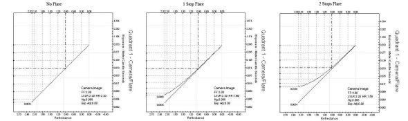

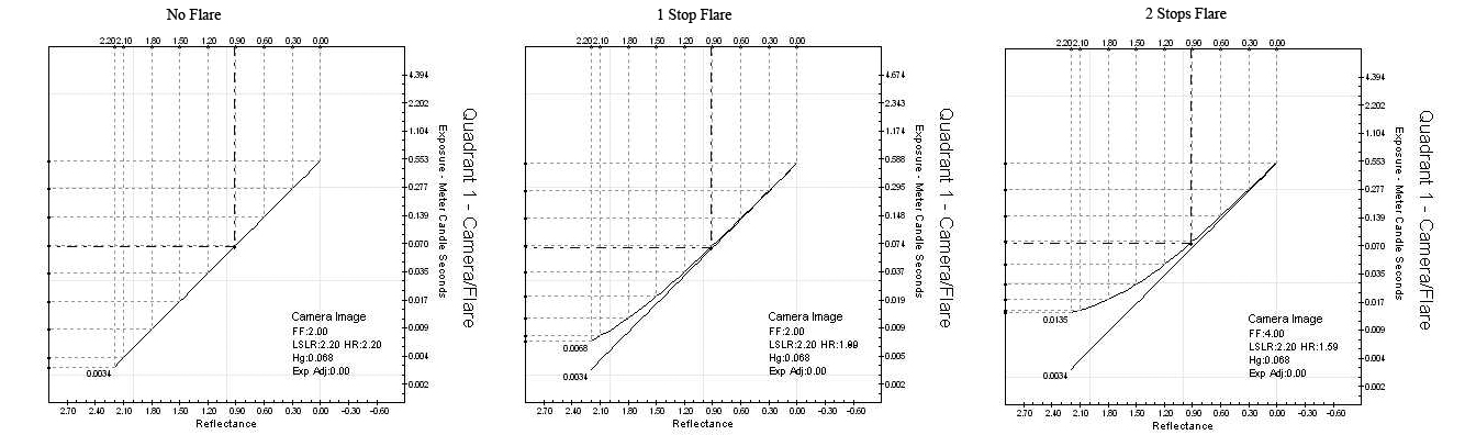

Mark,
You seem to be jumping around a bit on what type of flare you're interested in. I have a feeling this isn't it, but I put together graphs of 3 examples of camera image flare to compare: no flare. one stop flare, two stops flare.

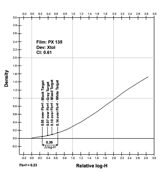

BTZS teaches how to shoot a "black hole". It's a large-ish cardboard box spraypainted black inside with a shade like a lens shade over an opening cut in the front. You put this in your pictures, like a prop, and shoot away. The theory is it is pure black. No light that goes in comes out. So any density over base+fog on the
I did a test like that some years ago while working on an article about flare and the film speed. The set-up consisted of the black box and four cards, white, grey, black, and mixed, with holes cut out of the middle to go over the black box opening.
I based the exposure on a grey card. I then made exposures of the four different set-ups. Being me, I then exposed a sensitometric strip to run with the black box test. I read the density from the area of the box opening and placed the density on the film curve.

So the light reflected off the target bounced around the lens and contaminated the black box area kinda like my doorway to Chimayo messed with my metering.
Like pre-exposure, I assume this particular type of flare would actually help get the shadow areas up off the toe a bit more.
Is that a fair thought?

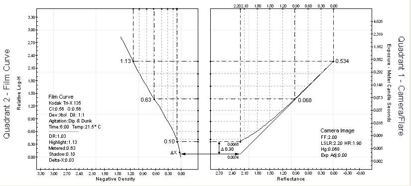

In general 80% of flare comes from the subject which leaves only 20% coming from stray light. In the black box example, flare added 0.38 more log-H exposure with the white card compared to the black.
Flare works exactly like pre-exposure. That would be a good way to look at it.
If you look at the two quad example, you'll notice the camera image has two curves. One is a non flare curve and the other is a one stop flare curve. Look where the non flare curve intersects the film curve. Without flare, film would be one stop slower. The ISO film standard factors in one stop of flare into the speed calculation. So, you should assume that you will always have around a stop of flare in most average shooting situations. Higher flare will add more exposure to the shadows effectively making your film faster. A good rule of thumb is 1/3 stop more or less flare per stop increase or decrease in subject luminance range.
Down side of flare is the compression of the shadows.

Mark,

Flare makes it impossible to determine where the shadow exposure will fall. If you look at the very bottom of film curve in the two quad example, you'll see a Delta X notation. That point indicates the fractional gradient speed point (found using the Delta-X Criterion). The fractional gradient point is the minimum point of exposure that will produce an excellent print (determined from the Loyd Jones First Excellent Print testing).
Even if it was possible to shoot a scene and experience zero flare, the exposure will still fall at a point where an excellent print is still possible. This also means that there is about a stop safety factor built into the film speed standard.

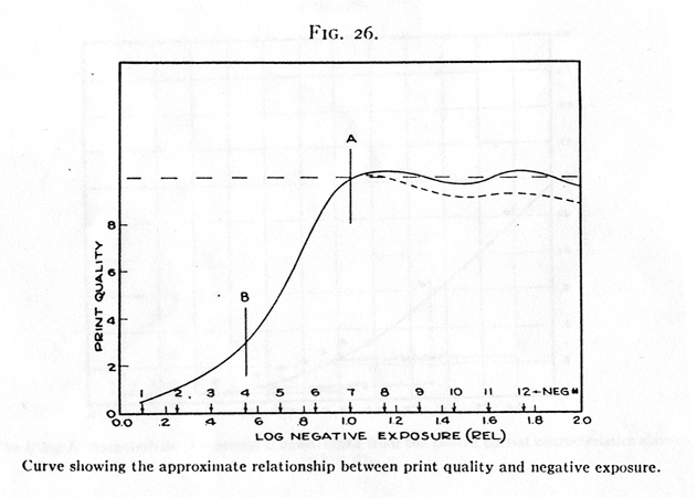

As flare varies considerably depending on the tonal distribution of the scene, the idea of film speed and proper exposure is about finding a placement that allows for the variance without sacrificing quality. There's a misconception with some that there are specific densities for specific "Zones." According to Jones, negative density isn't an important factor in the determination of print quality. The critical factor is gradient.
You've probably seen this graph before, but this is an good time to review it. It shows the relationship between the negative exposure and the perception of quality in the finished print. Point A is the First Excellent Print which has it's exposure at the fractional gradient point.

I think Mark and I are going to be satisfied with "rule of thumb" and "at least the right direction" kind of estimates.
That's what I'm saying. Rule of thumb is all there is. You can't be certain where the shadow exposure will fall because of flare.
