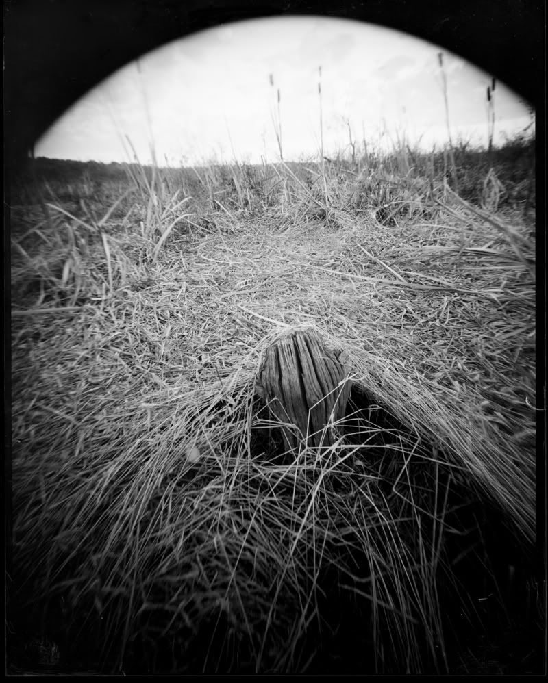

Soeren,
is it similar to the smal spot to the left of the stump in this picture?
(taken with a Caltar 90 f8 on 8x10)
erie
Soeren
Nov 5, 2004
2,675
Naestved, DK
Soeren,
erie
Kind of, but it is bigger it covers most of the lower part of the image.
