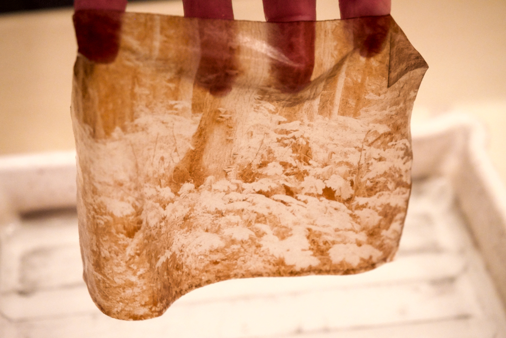

How about thin papers? Some people print on Washi thinner than shown in photo below (handmade Gampi sold as 21gsm so actual weight can vary a bit)
