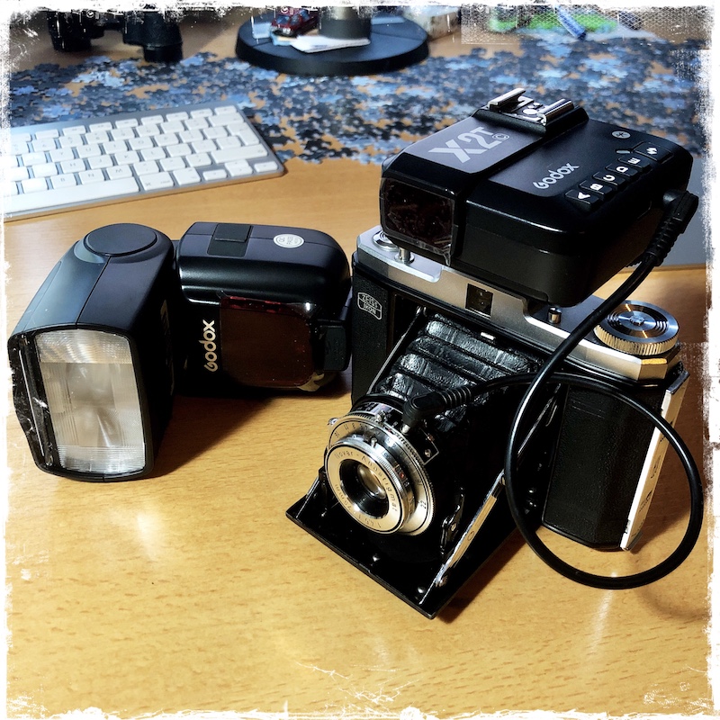

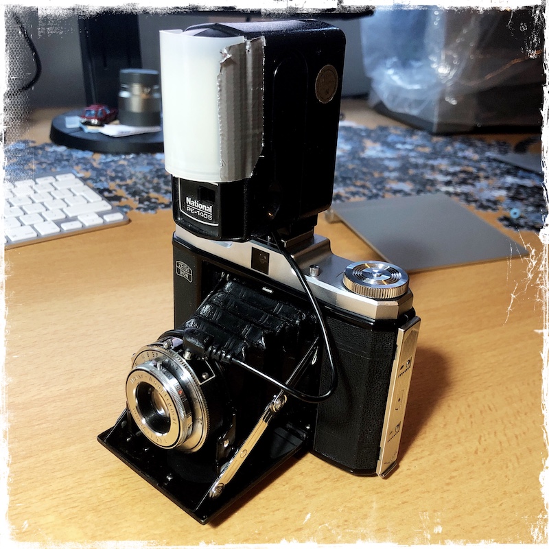

Great suggestion, thank you Dan. I fired the flash at all times, placing it under the camera and with the back open so I could see if the shutter opened. Turns out that it opened on all shutter speeds, including B, which is very good news indeed. This was with the small National PE-1405 flash unit in the first image which has a handy built-in PC sync chord (very useful mini flash in case anyone's looking for one). I tried it with my Godox trigger and flash and that works brilliantly too.
