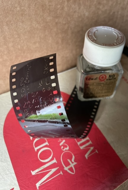

The old recommendation for this was "nose grease" (honest) - oil that you get by wiping the outside of your face. Not snot! The idea is that oil roughly matches the index of refraction of the base and makes scratches less obvious. Edwal made a product "No-Scratch" which somewhat remarkably still exists - Freestyle has it. I've never used that.
I would not use anything permanent like nail polish or super glue. It seems like it would be hard to get even, and then it would be on there forever. At least with nose grease, Vaseline, or similar, you can always wipe it off and start over.

There was a fluid you could get at photo stores. Edwal NO Scratch.

It’s mostly turpentine. Doesn’t dry (quickly).
