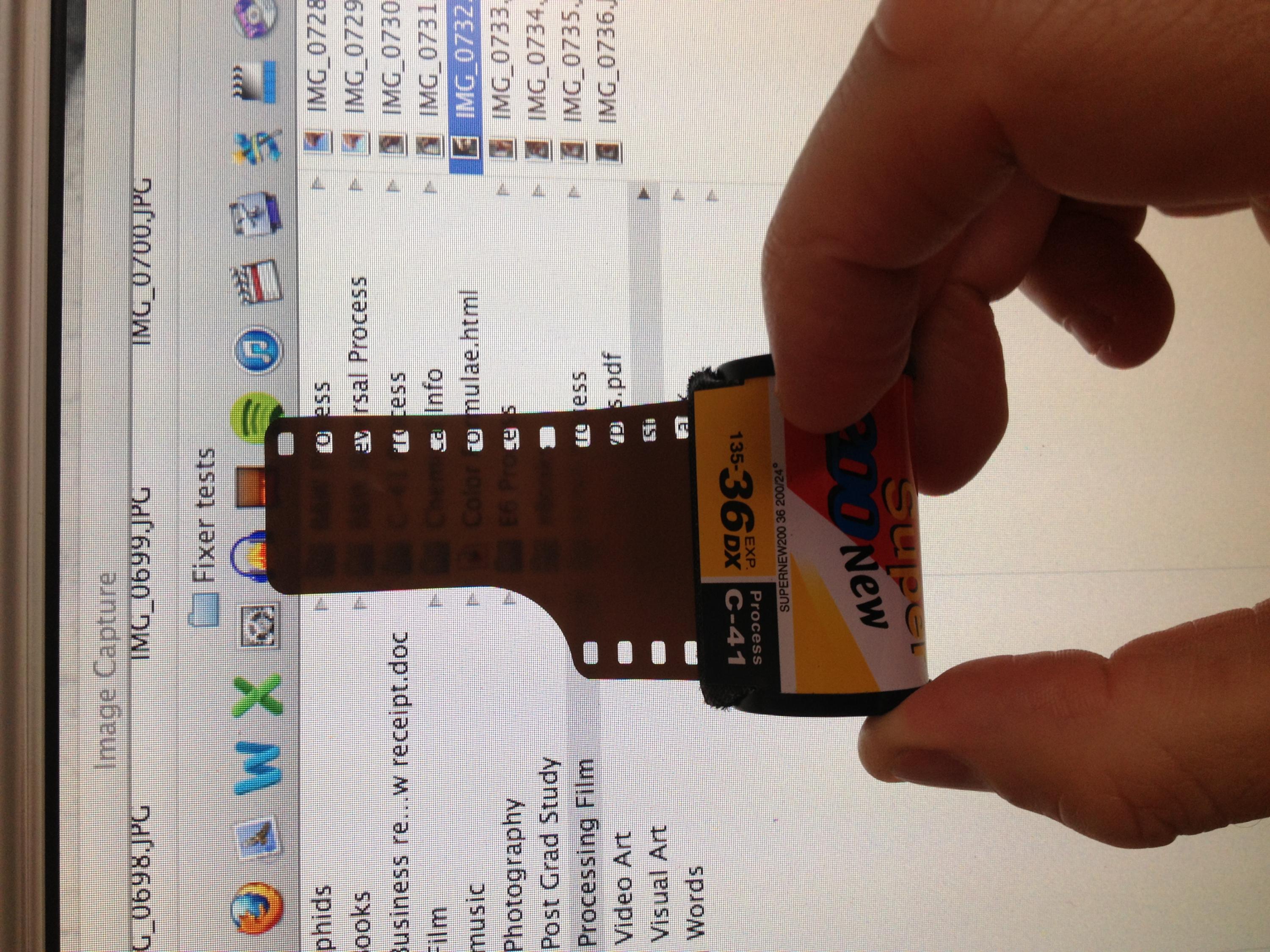

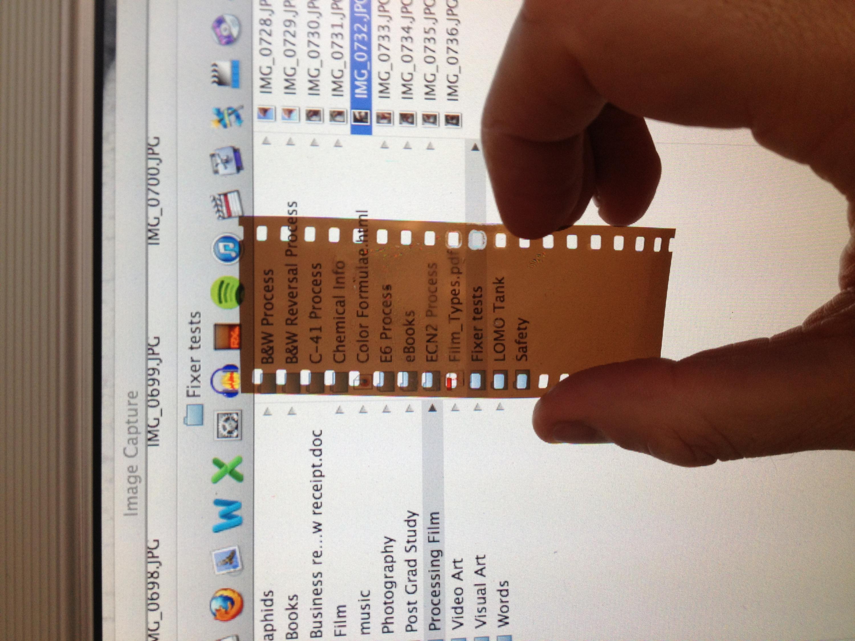

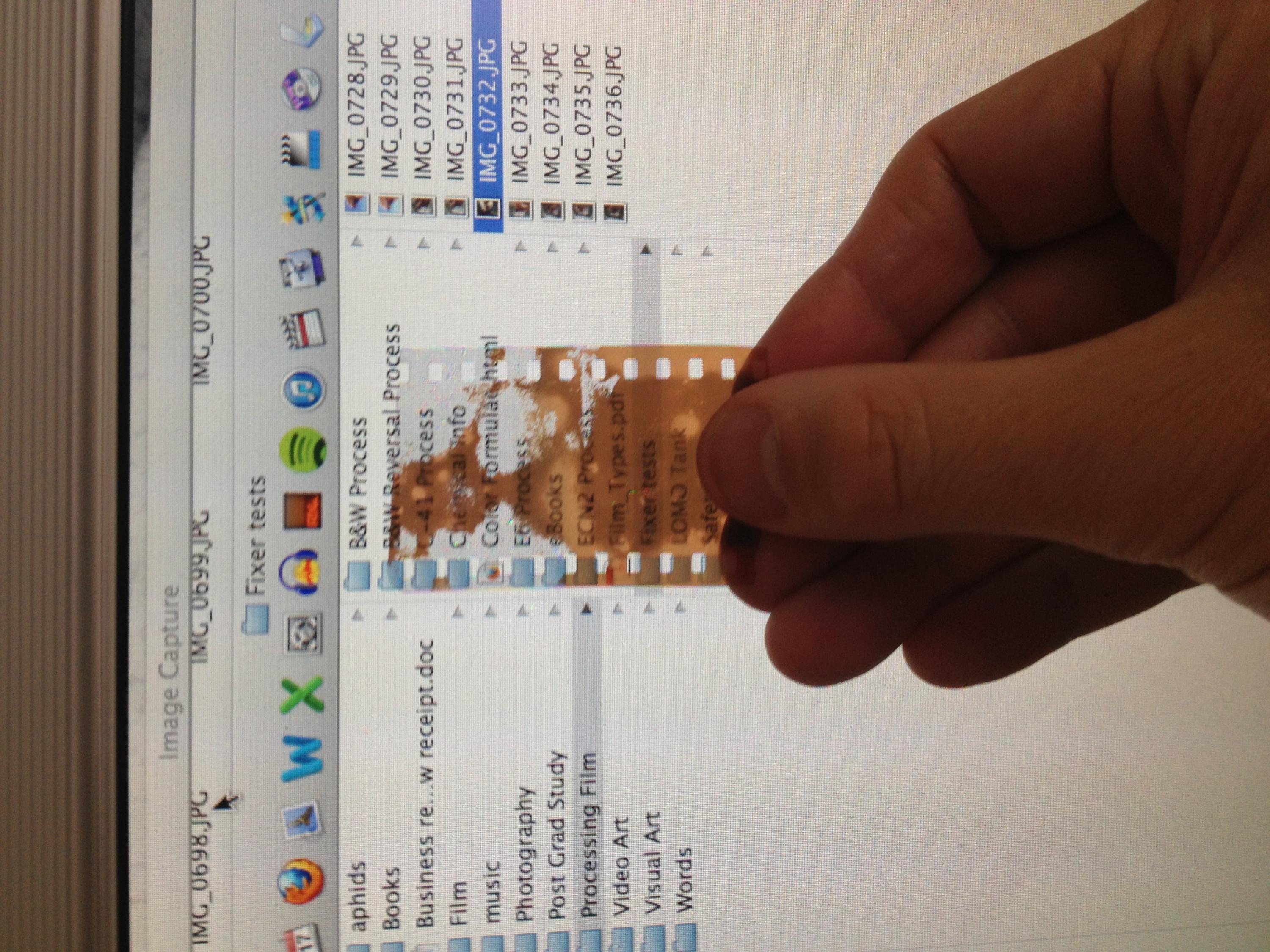

Thanks for the replies. Apologies...I'm still a bit confused.
The pics attached:
First one - untested
Second two - tested
With respect to "clear" am I looking for the 2nd or 3rd result?

look at the files on the computer - maybe he fed it to some aphids to get the third picture results?
Excessive fixing can bleach away the lighter tones of the image, but I have never seen evidence of the orange layer coming out of the film base.
