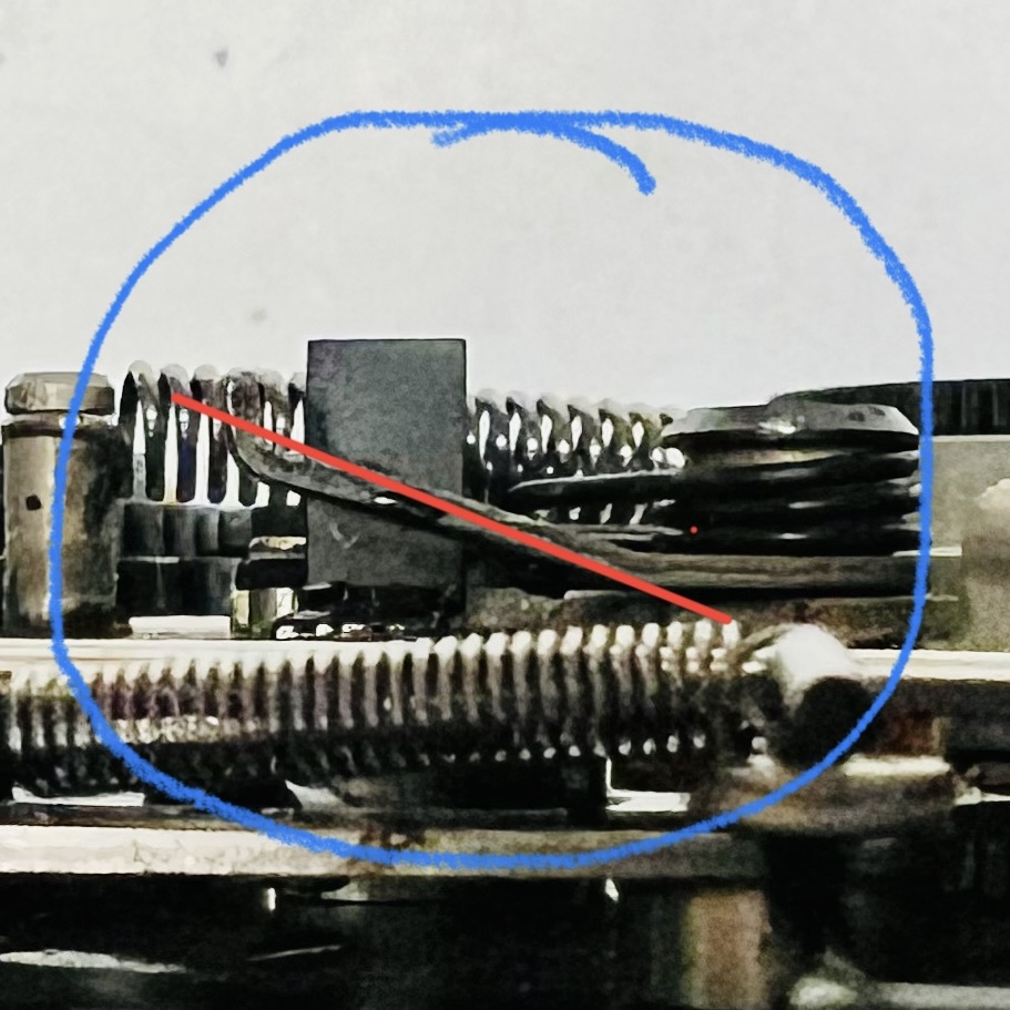

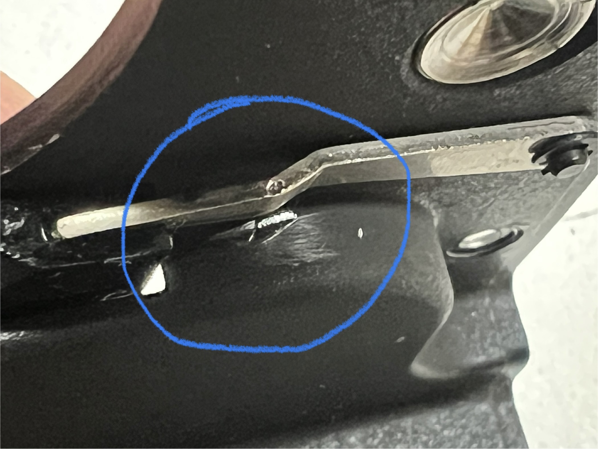

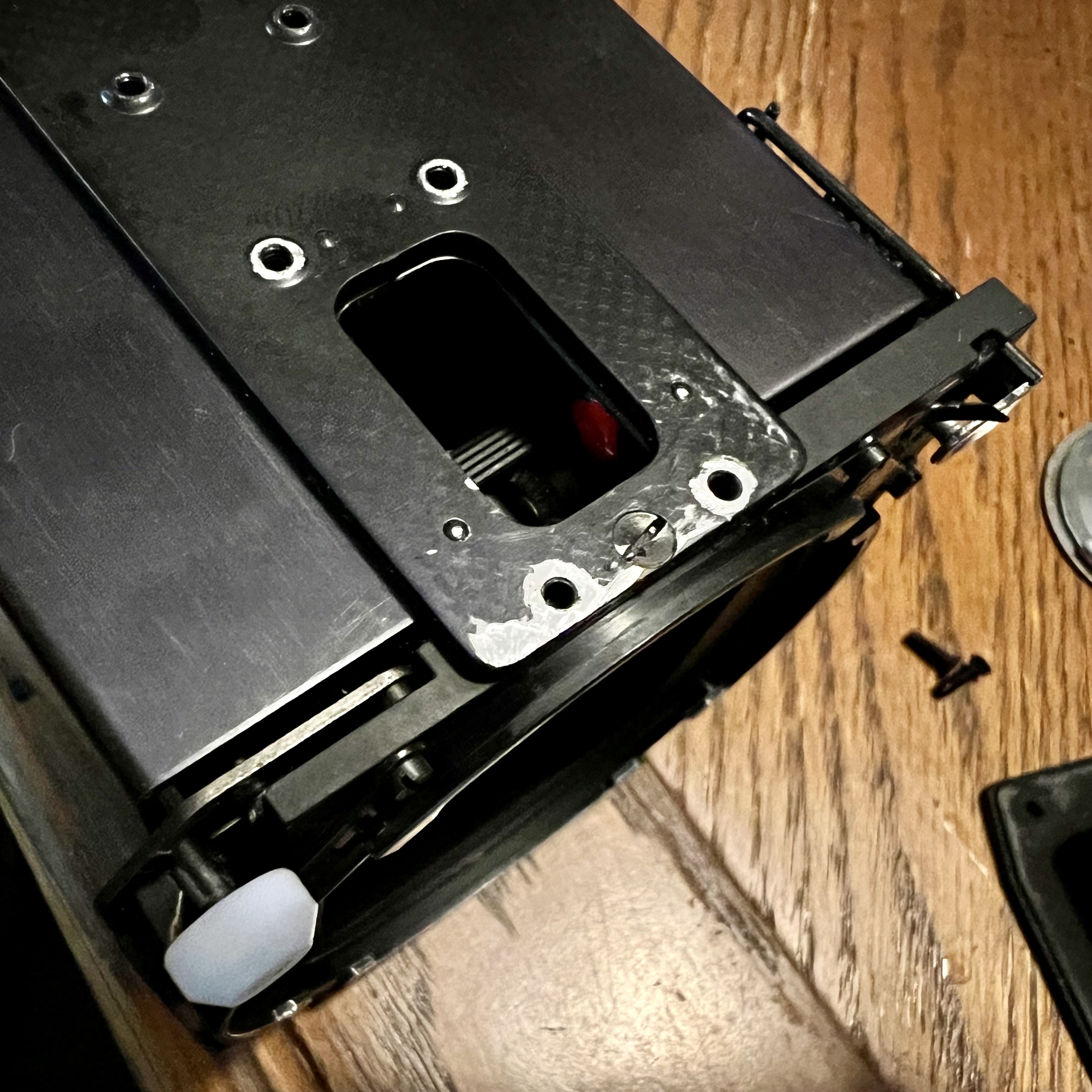

Both! The screws holding the tripod plate (which also hold the shell onto the body) were loose, as was the bottom screw holding the bottom of the bayonet plate.
In concert with the scratches near the barely-functioning MLU lever, quite a bit of scraped-away metal on the forward lower edge of the body, and the missing spacer washers for the front two tripod plate screws, I think a previous owner rather clumsily attempted to repair something.
The camera now works better than when I bought it, as the actuator for the MLU (the “S lever,” I think the service manual calls it) was bent inward, which ended up jamming the camera my first couple attempts at reinstalling the body into the shell. I drew a line on the picture of the bent S lever showing how far off of straight it was.
It now has no discernible lens movement relative to the body, and a functioning MLU!
