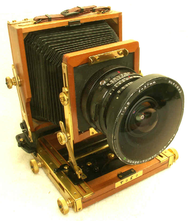

MXV Photographic in the UK have a "Mamiya 37 mm fisheye/adapted into Copal" for a mere £750 should you wish to try it out.

Of course it's been done, but why anyone would put a Mamiya 37mm on a Copal shutter (as suggested) since the Mamiya 37 has a BUILT-IN shutter, can only be explained by the idiot who came up with the idea. For more details, check out: www.subclub.org/fujinon/gonefishin.pdf
To answer the other naysayers, the results are SUPERB. The f4.5 aperture makes for easy focusing on the groundglass. The incredible DOF makes movements somewhat irrelevant, but not completely. The image circle barely fits in the 4x5 format, but since little additional extension is needed for close-focusing, you can usually stay within the frame.
