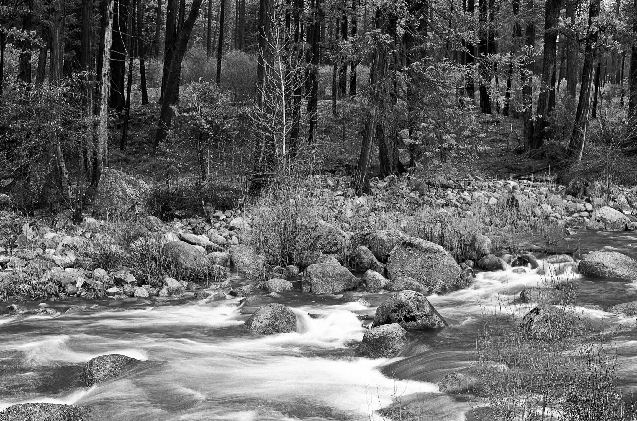

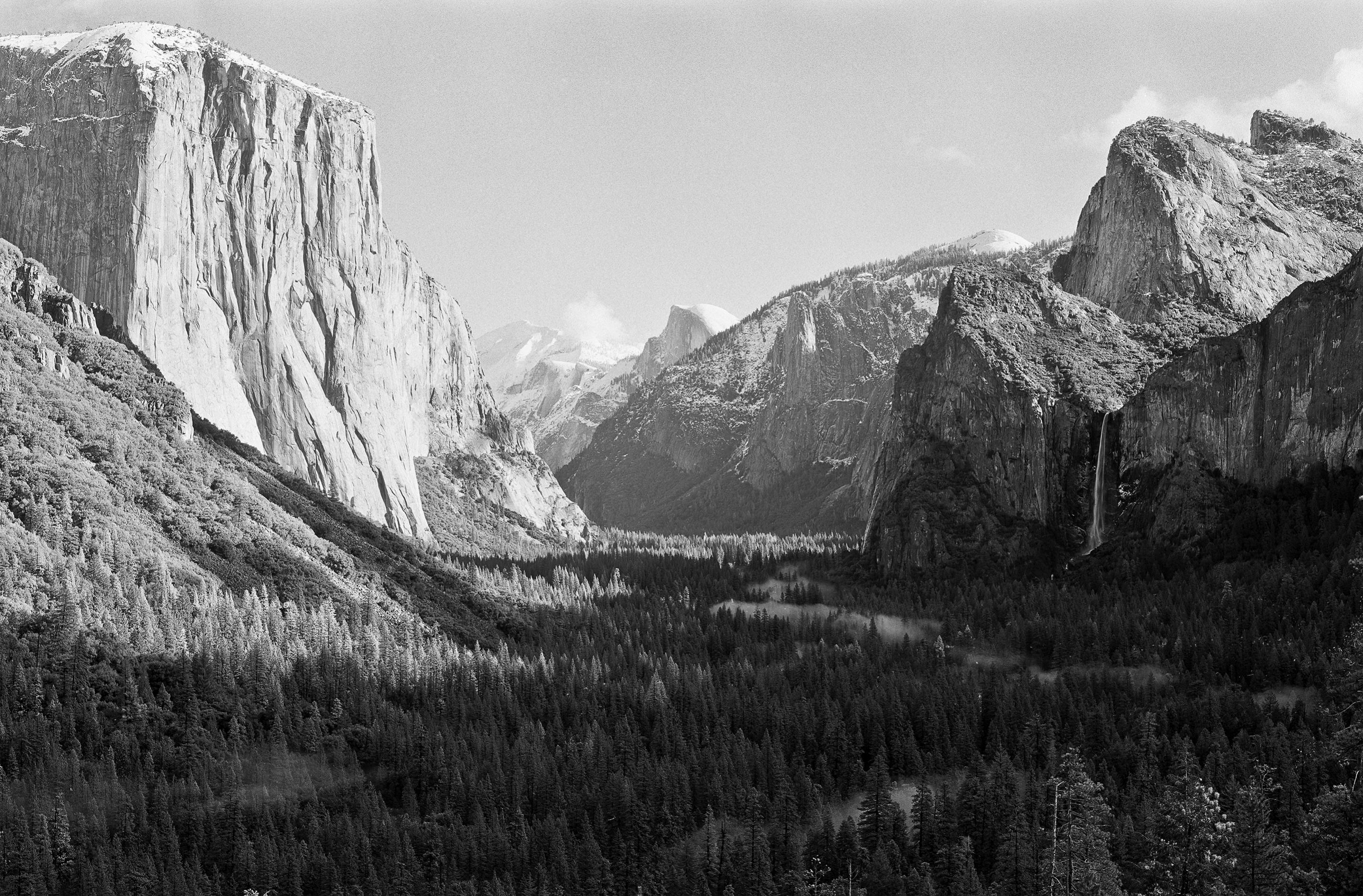

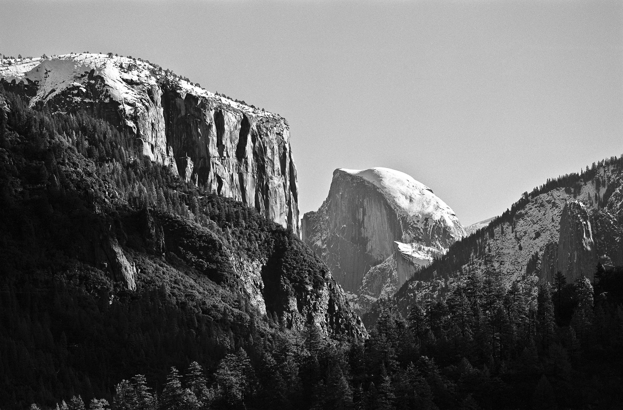

Let me get this out of the way first. I was given the film and developer, from a friend who is rich and friendly. He told me to give it a try. I have been very happy with the films I use but hey, free film that is supposed to be great, why not give it a try.
Of course I was skeptical of using a document film or whatever type of film this is. The results I have seen are soot and chalk, ultra high contrast with nothing in between. But my friend said, you gotta try this film! I did a little digging and people claim that it can be developed as a normal pictorial use film if you use their developer. I have heard this story before, so why should it change now? I gotta admit, after scanning them (will be wet printing them in late january) the results shocked me. yeh the film is a little higher in contrast, but the negs seem very similar to pan f. the tonal range is very good and the sharpness, wow. the grain? what grain. the first 35mm film I ever scanned that had no grain on a 300% zoom. Cant wait to print them.
So I must say, that this film in the matched developer, the claims seem to be true as far as I can tell. I have 4 more rolls to try. But I figured that the high contrast scenes would be a problem for the film and I was wrong. I only brought 2 rolls with me as i was planning on using my pentax 67ii for all my shots and to just try the CMS film. but the dreaded pentax 67 e-20 error (caused, guessing from cold weather and static electricity, odd as its the only cameras I have ever used that has given my issues in the cold weather) made using that camera not possible. its just too bad that this films developer is so expensive, but given the results it seems to be a specaial situation combo so maybe not that bad. I just have to wait to see a print to judge if the cost is worth more film.
anyway here are 3 quick scans from my Yosemite day trip yesterday.

Great pics. Hard to go wrong w/ that subject matter :]
There seems to be something a little funny going on w/ the middle tone tree area on the right side of the first photo. Might just be a result of scanning, or localized glare.

not sure about the right side of the first pict. I will judge them when printed as scanning can be hit and miss. I did shoot a few rolls of 6x7 acros and rollei retro 80s before the pentax quit on me. the 35mm cms seems to me, on the light table, to match them in quality. it was strange light for the day. clear with a few patchy clouds turned to fog and snow later in the day. really harsh light. I expected the CMS film to really block up but it did not, it delivered in spades. I have not developed the velvia 50 sides I took with the mamiya 6, and that will give me a good baseline to judge the other shots against. wqhen trying out a new film I try to shoot some slide film to check the original scene against the new film results. but as i said before, the sms matched the acros and RR80s pretty well.
this was just a test, not an endorsement of the film. Im always willing to try out new things, especially things that seem to have a highly regarded reputation from some. just have to wait for a print to get the final results.
