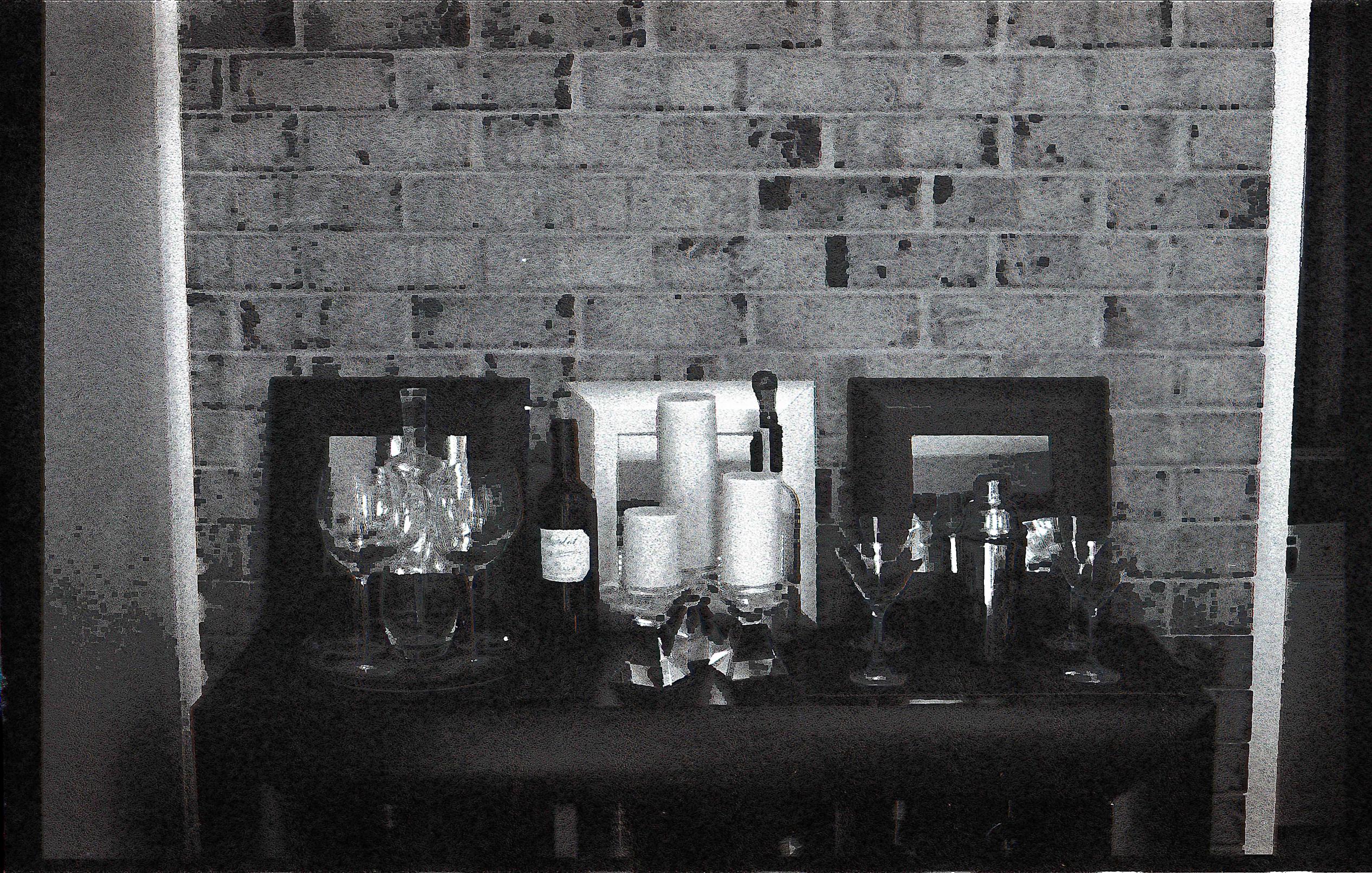

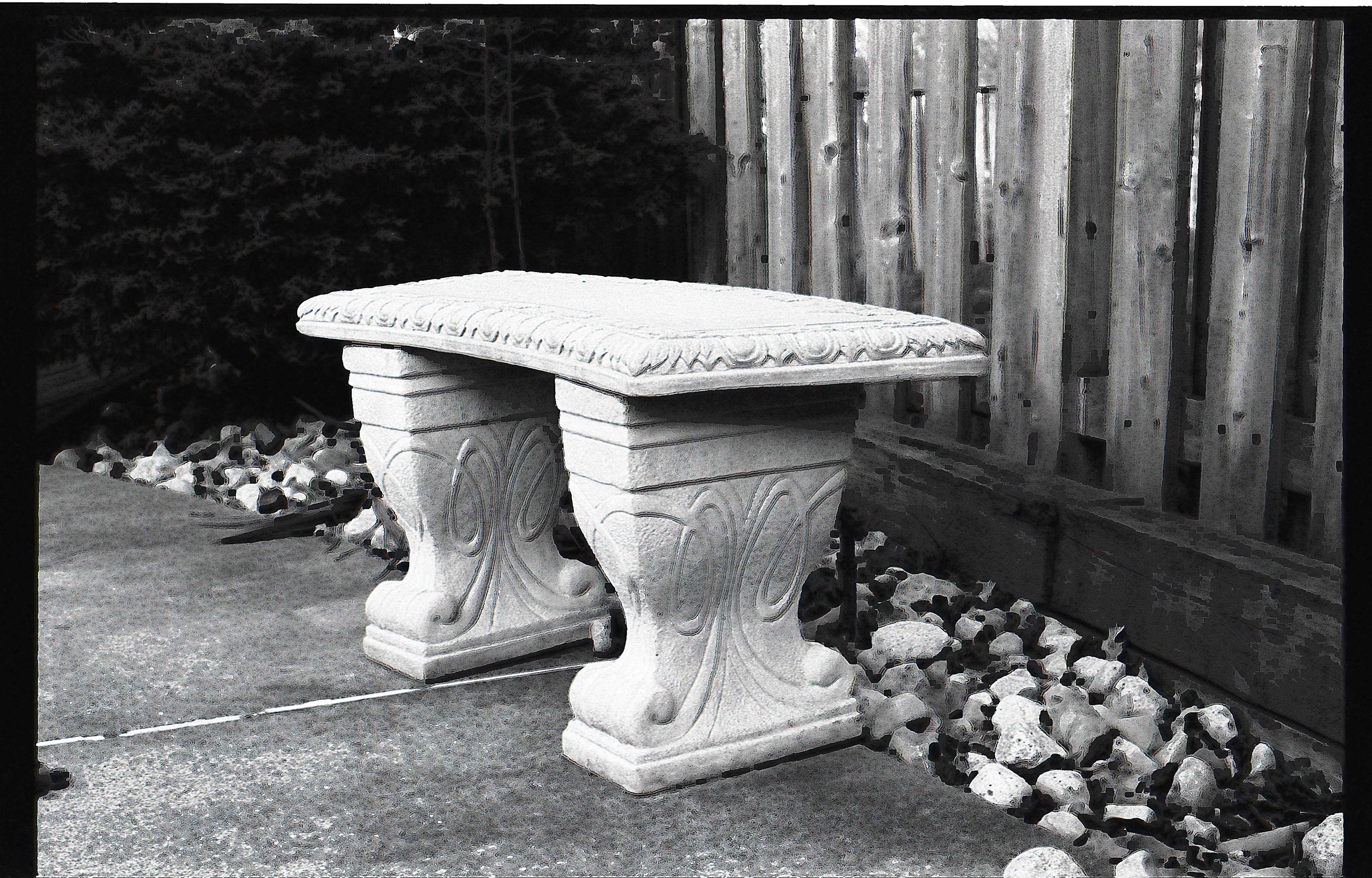

This is my first post here and my first time developing my own b/w film. In this case one roll of Tmax 400 and one roll of Ilford Delta 3200. I followed the instructions on Ilford's site and am using Ilford developer (Ilfasol 3), Ilford stop bath and Ilford fixing agent. I was careful to mix my solutions properly and follow the developing instructions closely. Dust hasn't proven to be a problem and my negatives are pretty straight after hanging to dry, very little curling at all. However, both rolls of film don't look right when I scan them. The negatives look normal to my eyes but when I scan I get mush, kind of like the watercolour paint effect from Photoshop. Even the grain looks very mushy. The first photo is the Ilford, the second is the Tmax.
Has anyone encountered this before? Am I doing something wrong or is this a scanning issue? I don't think it's a scanning issue because I scan my store developed negatives all the time and they almost always look very good. I've tried different scanner settings to no avail. I think I'm screwing up something in the developing phase. Any ideas for me?

I think that since the negatives look good to the eye, this is a scanning issue. I cannot help you with this because I only do optical printing. Someone else will have to help you.
In the second photograph I see ghosting and other scanning artifacts in the fencing. I would bet that those are not seen on the negative.

Are your store developed negatives colour or black and white?
I ask because I see a bunch of scanning artifacts when I magnify your images.
Scanning black and white requires different settings and/or techniques compared with colour.

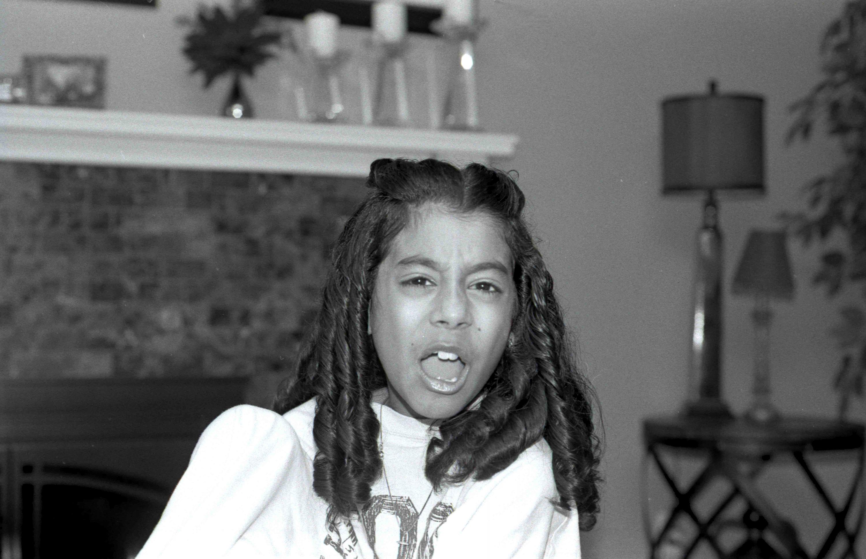

I've scanned both b/w and colour negs in the past without this issue. One picture from the Tmax roll turned out good. I've included it here. It's not the greatest image but it does show a proper or acceptable result, so I don't think it's a scanning issue...is it possible that I did not agitate correctly? Perhaps I created too many air bubbles? I made sure to tap the tank after every cycle but maybe I was too vigorous during agitation? How would 1 photo out of 24 be ok and the rest the same?

There isn't a processing defect I am aware of that can cause the artifacts in your first two thumbnails.
They appear to have been introduced electronically. I used to see something like this when I scanned Kodachrome... Does your scanner have Digital ICE?

Yes I use Digital Ice and it is very effective. I've never seen this from any of my previous scans so I assumed it was something I did when developing my film. I suppose I can't rule out a scanning issue just yet.

Digital ICE causes these artifacts. ICE is good when scanning color film, but for B&W it is best to leave it off and use noise reduction only if you must.

Good call. Digitial ICE can cause the silver to glow.

It was indeed the Digital Ice that was the culprit. I'm using an Epson V500 to scan and I had forgotten to switch to 16 bit grayscale in addition to b/w negative. This was leaving Digital Ice activated, ruining the scan. My negatives look really good actually. I'm quite pleased this being my first attempt to self-develop. I'm probably going to be switching to shooting film almost exclusively now that I know I can develop my own film...it's quite enjoyable actually, and very rewarding to be responsible to the entire process. My next step is to learn how to make prints from my actual negatives instead of scanning and printing. I'm probably picking up a medium format camera soon too. Currently I'm using a Nikon FE and 50mm 1.8 series E, or a Nikon F90x when I want autofocus.
Thank you everyone for all the help. I'll be using that camera lens trick as well to examine my negatives :smile: I expect I'll be more active in these forums now that I have an idea as to what I'm doing. Probably lots more questions too.
I attached one of the proper negatives so you can get an idea what they look like. Not a great shot by any means but I was just blowing through this roll of film with the knowledge that it would be my first attempt at self-developing. It's Kodak Tmax 400. Thanks again.
