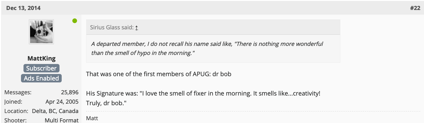

There should be no strong odor.
Maybe it sounds strange, but I like the smell of pyrocatechin while preparing the part A, although I always use mask and nitrile gloves when dealing with such powder chemicals.
I'm not addicted to them, but the odours of the various chemicals we use always brings back fond memories for me. It has for 50 years. I hasten to add that I don't use acetic acid or acid fixer!

From the past:
