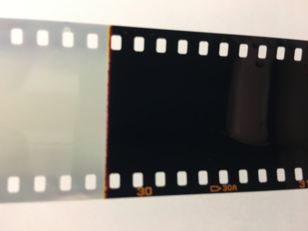

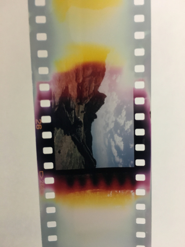

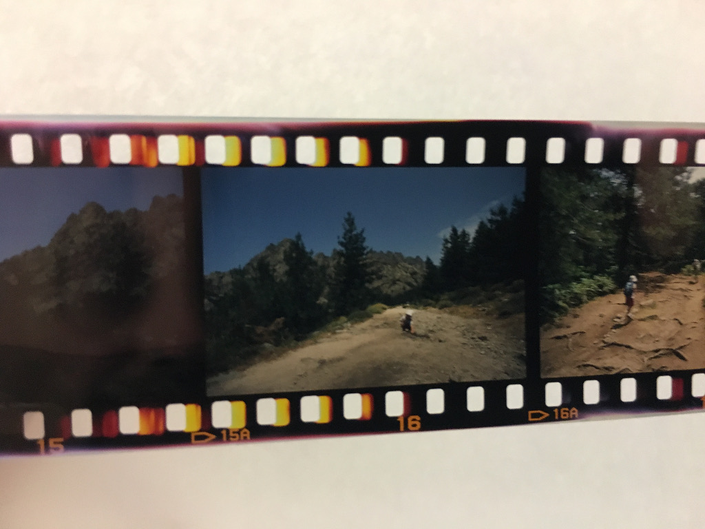

OK, I am a bit calmed down as not all is lost.
Towards the end of the film, some images are fully or partially lost. I assume do to some kind of a light leak.
However, towards the beginning of the roll, photos get progressively better. Even on about 1/2 or 2/3 roll there are usable images. What's interesting is there are sprocket marks, as if there was a contact copy made.
However, the last few shots are completely black, I assume I changed the film mid roll (although not sure why I'd to that at this point in time, as we were mid-travel).
The only reasonable explanation seems to be that I opened the camera with the film still in. I don't remember doing it, and this was almost a year ago. Neither very dim leak in the darkroom or tank leak could explain the last unexposed part. Thoughts?

I recently had those weird sprocket hole marks too, it was a light leak caused by using the wrong tube that connects the reels in the tank. It was only slightly shorter but it did let enough light in to ruin half the top roll.

Hmm... I don't think a tank light leak could cause something like this. For start, the unexposed (black) part of the film was at the outside part of the reel. So light would have to leak in the middle of the reel only. That would be quite a defect, wouldn't it?

Fogging of film in the inner section of your reel could well happen if the spindle is too short or not in place at all, as suggested by noeru.

I did another batch today and it turned out fine, which further confirms my guess.
