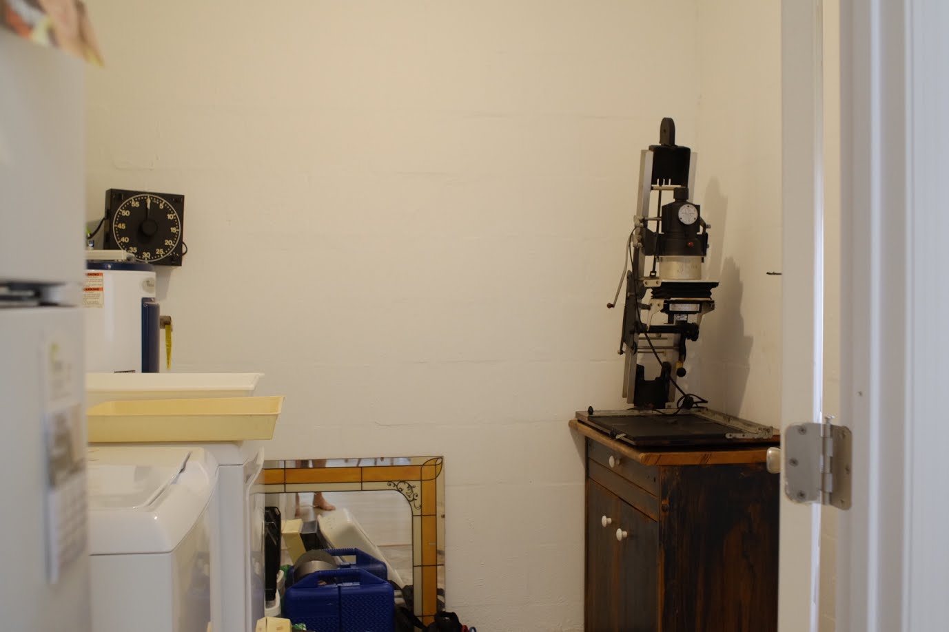

I just moved into my own place Jan 1 of this year. It is a small rental but it has a 7.5'x7.5' utility room with the washer and dryer in it, so of course that now plays double duty to the darkroom. Printed for the first time in about 2.5 months last night.
I mounted two safelights on the walls, covered the window with a black trash bag, and I was good to go. Plenty of space in there for one or two people to process. Enlarger sits on its own cabinet and processing trays go on the washer and dryer.

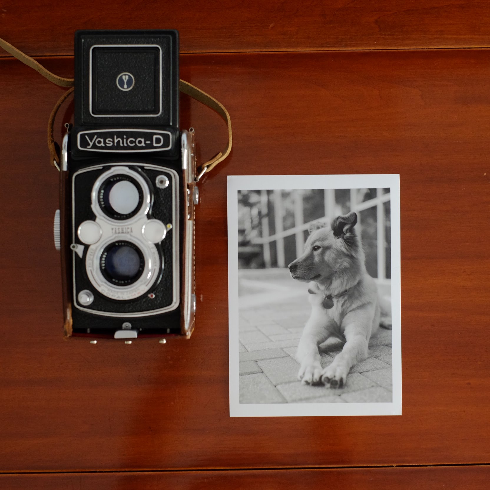

I only spent about an hour printing and made two prints from old negatives. One 5x7 from 6x6 Ilford FP4 shot while I was testing my girlfriend's Yashica D:

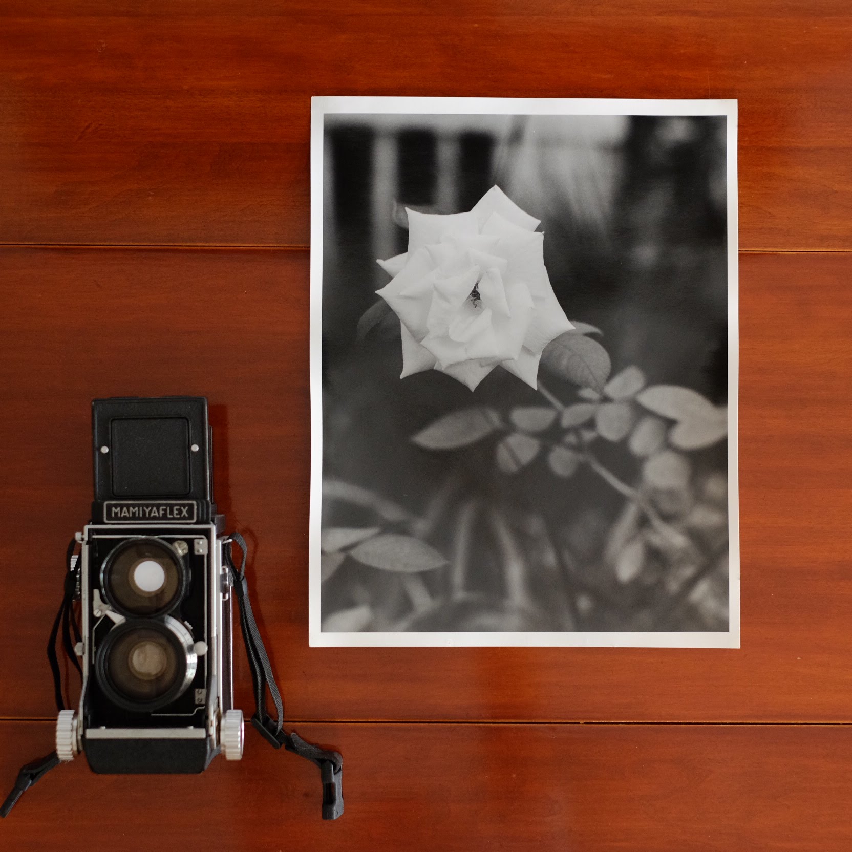

And one 11x14 from a 6x6 Ilford FP4 I shot with my Mamiyaflex and 135mm lens:
8x10 was the largest print size I had ever made, so I just wanted to print something big and someone had given me a box of 11x14 paper. The print of the dog (Scout) is destined for the fridge, not sure where the flower will go. Excited to finally have my own space to develop and print in!
