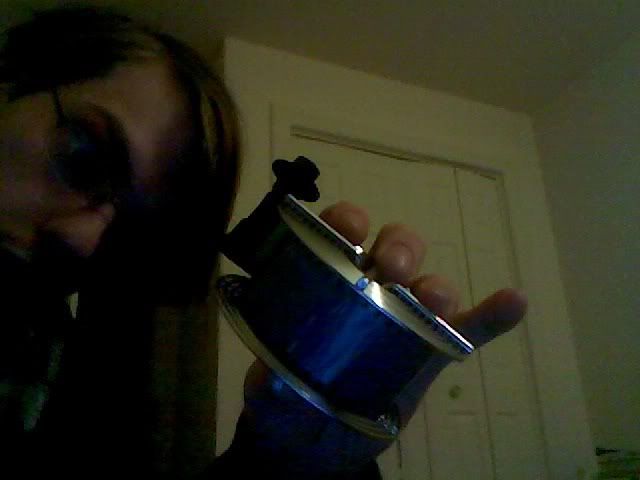

Hi guys,
I went ahead and started loading a 35mm reel for the first time, out of sheer boredom - Plus I have a few weeks to go before the "wet side" of my dark room is set up.
Anyways, I forgot to trim the leader - and managed tearing the film, so I had to trim some off. That went okay. So, around I go - film snags. Rewind! Film snags again... You get the idea. Then I remember that it's probably a good idea to BEND the film... Suddenly, I had it. All of it.
Anyways, I had expectations it was going to be easy, and reminded me I really am just a beginner!
I got so stressed out I almost gave up, but my persistence paid off. Mind you this was a blank roll of film in the first place!
Reminds me of a girl who was using a 35mm camera, and asked me, when she opened the back, why there were no photos inside... hehe! At first I was dumbfounded, but then I have to remember that not everyone has had the advantage of using film in their lives. (yes, I am pretty young).
Alright, off I go again, for another run at that reel!
PS. This is my inspiration for all of this: http://www.atelierfenetresurcour.com/prestation.html I guess I got the "bug" yet again... The first time was firing off the shutter, and to my delight, there was a very real, solid mechanical click. I still love that SLR sound, or even the slight "ping" of a rangefinder... :wub:
EDIT: Anger has taken hold of me as I todd the unused roll aside. The preforations are ripped a bit in spots and make loading unbearable. Practice roll #2 it is.
EDIT2: I now present you with... VICTORY: http://i92.photobucket.com/albums/l1/Sherab0/101226-203331.jpg
Although I feel like the film should go all the way to the end of reel.. how will the film keep it's tracking once it's cut from the "spindle"? should I just tuck it in? (i mean in a realistic setting with actual used film in the reel.)
