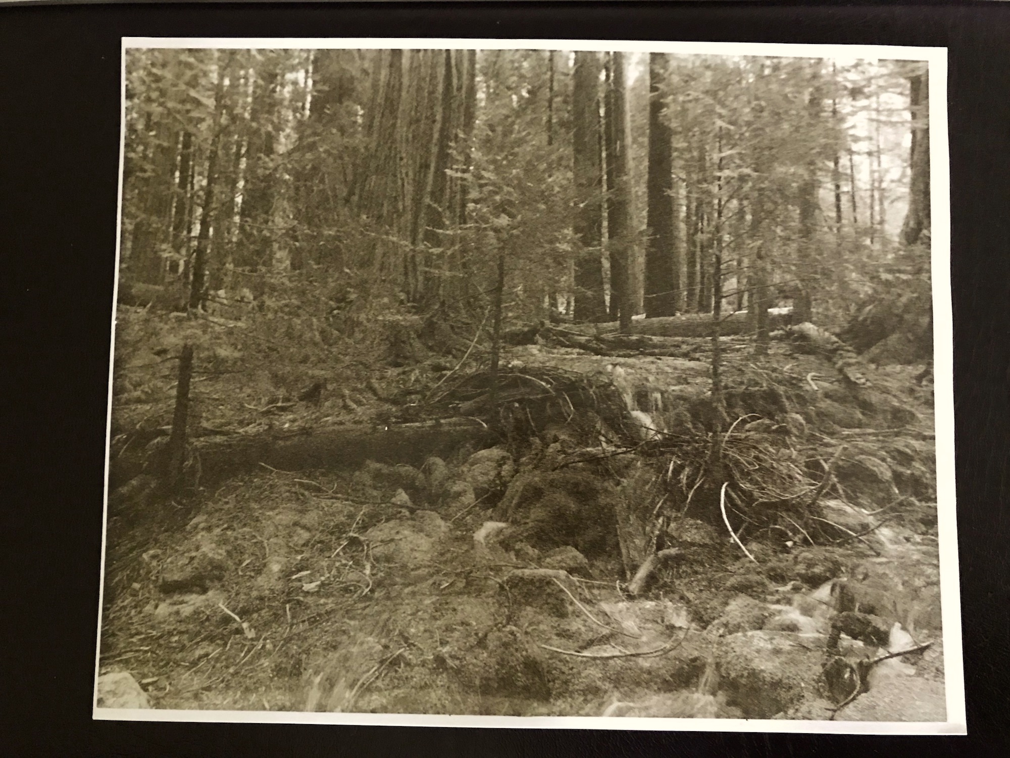

Well here is my first disaster. Your criticisms welcome.
Interesting that the best print scanner I have is not the HP flatbed but rather the iPhone 7. I have played around with digital sliders to try and get this the same as the print so it is sort of close in colour but maybe a bit much sepia.

I am by no means a lith expert but you a full range of tones here. Not easy to get in lith prints. As to why do it, do we really need a motivation other than the development of our craft? I think lith printing is a great way to get out of the rut of just another gray scale print. :smile:

As to your example lith print, it does not look very much like a lith print to me. I would suggest that you Google Anton Corbijn who used Lith printing a lot for his Star Trak project. Simply put the following into the search field “Anton Corbijn + Lith prints” or “Anton Corbijn + Star Trak" and then view the ‘Images’ tab and then you will see some fine examples of what good Lith prints look like.
The trademark ‘look’ for me with lith prints is to pull the print when the blacks are very gritty with a stark graphic look and the highlights are rendered in very subtle and soft shades of beige, yellow or red/brown. Selenium toning lith prints also produces wonderful results.
