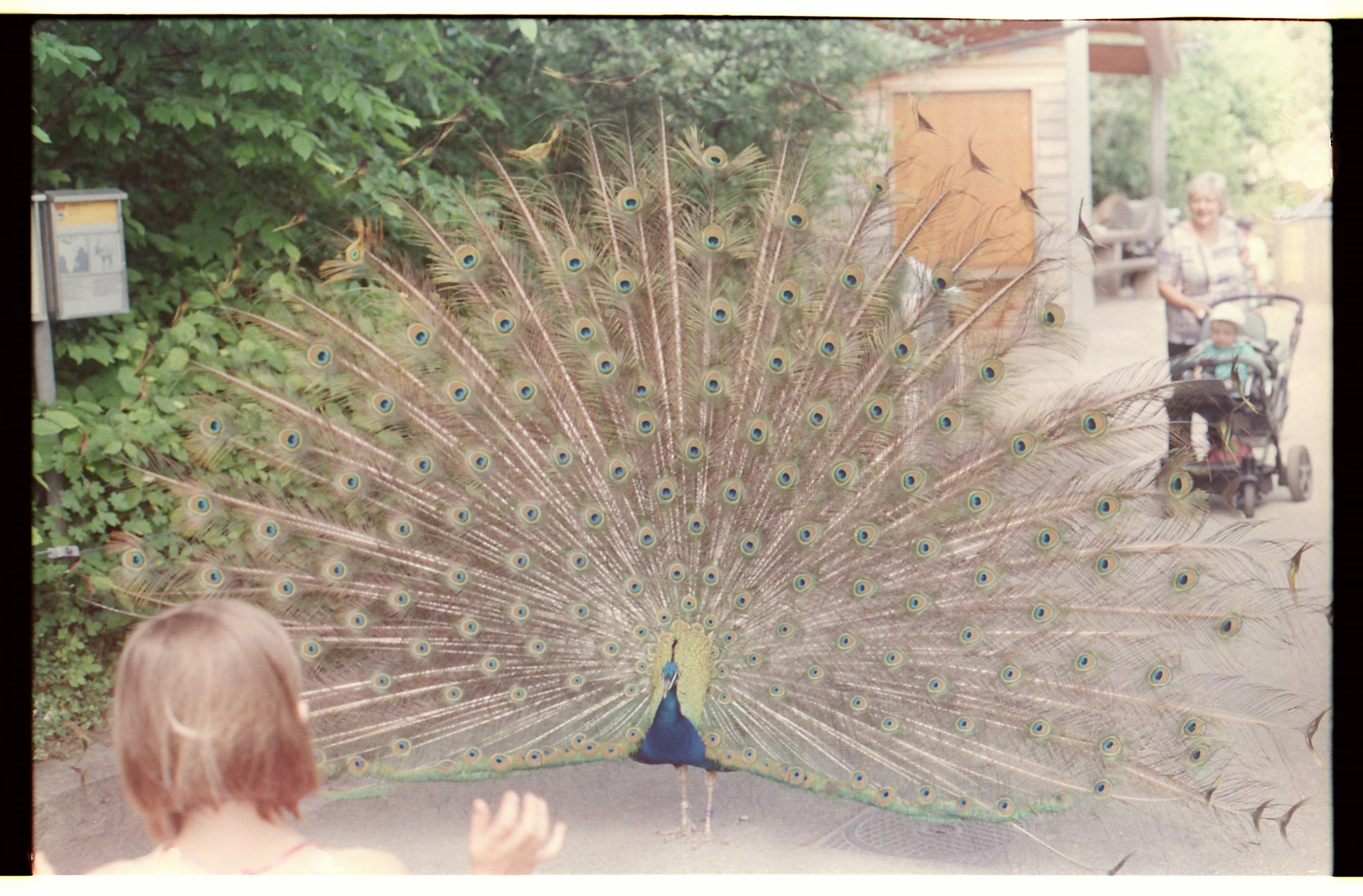

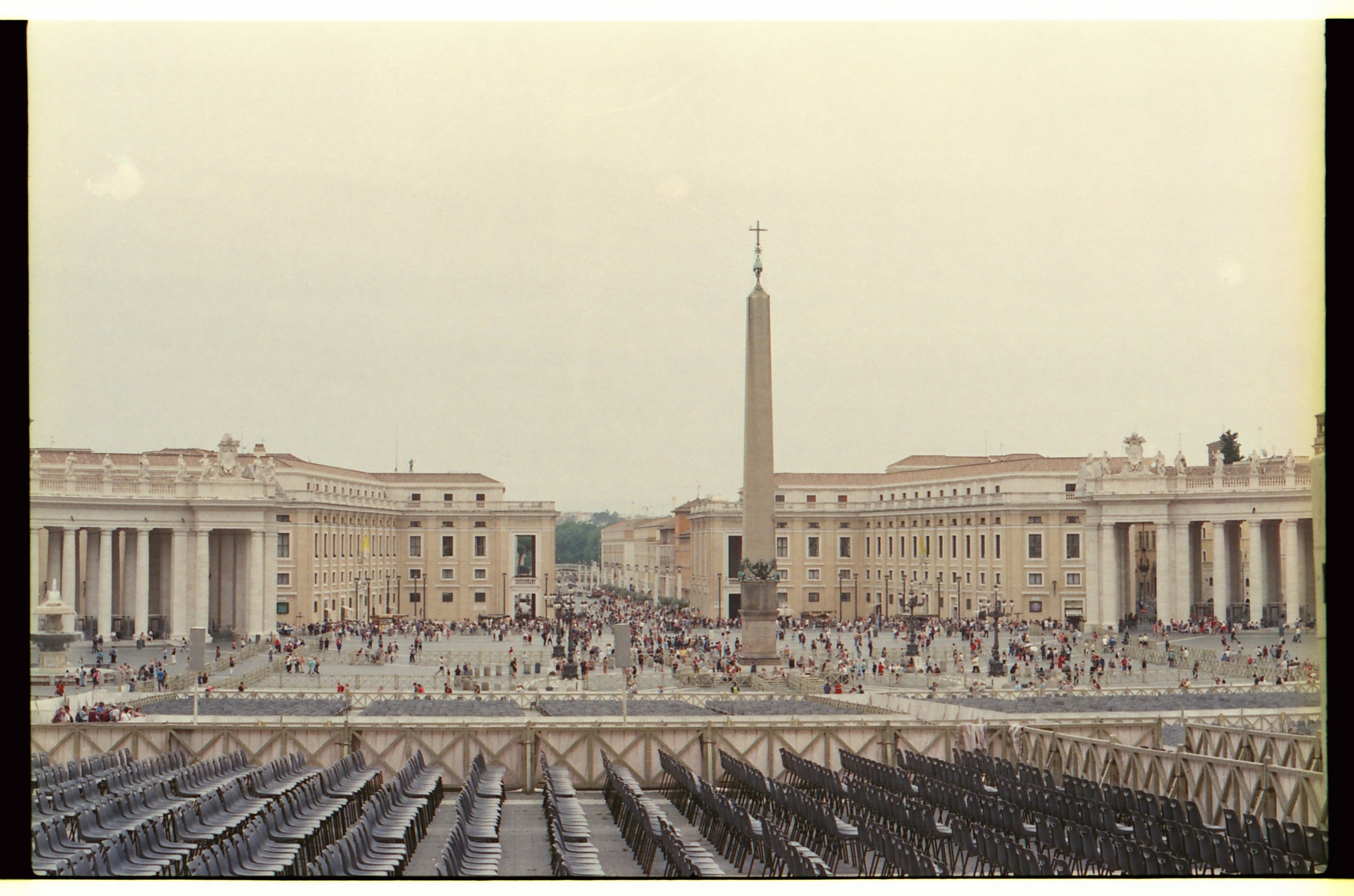

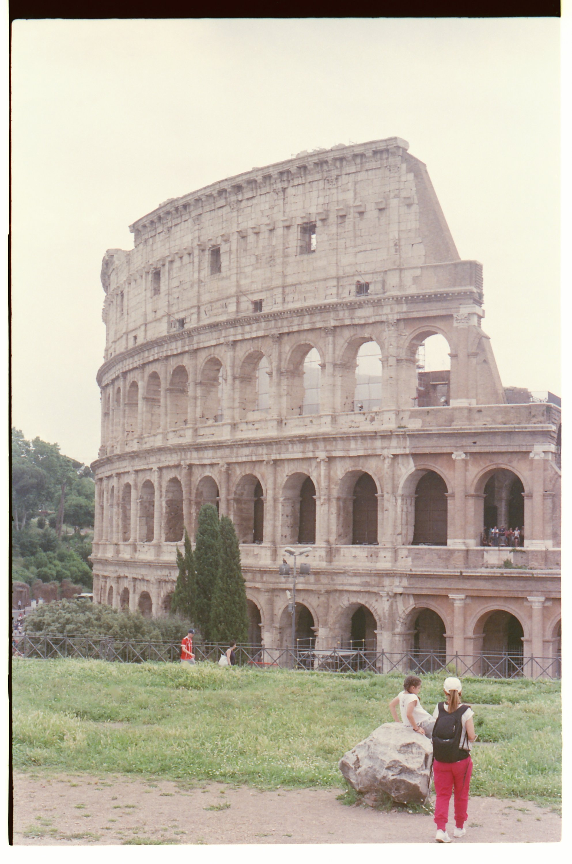

I tried C-41 developing for the first time. Did everything just as the kit told me to do it. All of my photos look "off". I can't tell if there are "flat", or the color temperature is off as I am inexperienced. Other photos I had professionally developed came out much better in detail both color wise and sharpness wise. Any one have any idea what I am doing wrong?
The method of development I am using is as follows:
  1. Pre soak with 102F water for 1 min
  2. Developer at 102F for 3.5 min. Agigate for the first ten seconds then agitate every 30 seconds
  3. Blix at around 102F for 6.5 min. Agitate for the first ten second and then every 30 seconds.
  4. Wash with running water around 102F for 3 minutes
  5. Stabilizer for about a minute at room temp.
  6. Air dry
The positive you are seeing here is after being scanned with a Canon 9000f. The pictures that I had professionally developed were also scanned with my scanner (Canon 9000F) and the quality was still much better than the negatives I developed myself. This is why I suspect the issue lies within my development process. I am thinking maybe the developer is too cold or maybe I am not leaving it in the developer for long enough. The troubleshooting guide in the C41 kit says if your pictures are "too flat" this is an issue if underdevelopment. I don't know if the pictures I have are considered "flat" but that's what they seem like to me. I can provide more scans if that helps.

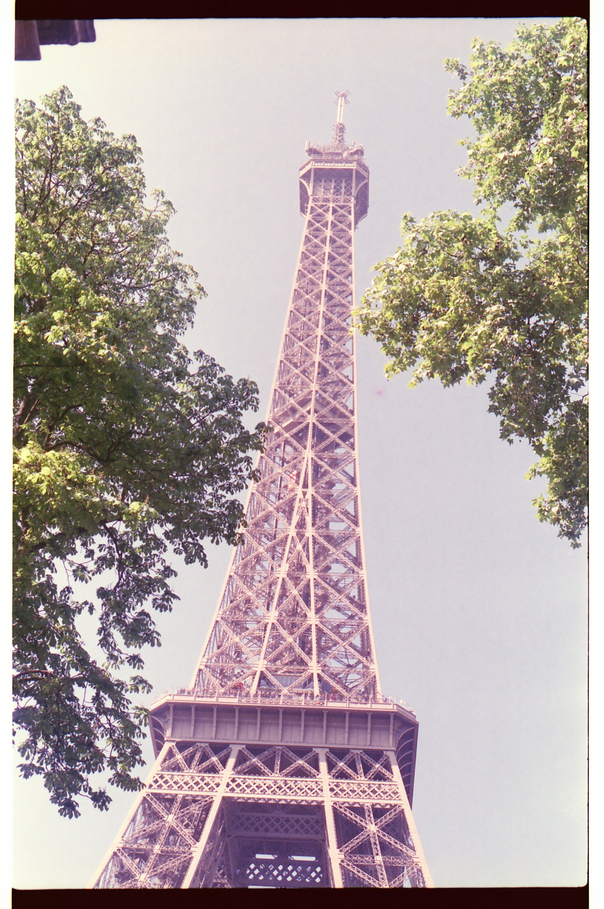

What kit are you using? The C-41 standard is 3.25 minutes at 100F. If anything the film should be overdeveloped. Hard to trust scans, but it looks like you may have some crossover, a difference in contrast of the three emulsion layers, which results from improper temperatures and other causes. How do the negatives compare with lab negs when viewed directly?
I would not trust any kit that told me to develop at 102F, or one that used a blix instead of a separate bleach and fix.

They look underdeveloped or underexposed to me. Or maybe a scanning issue, have you gone back and scanned a commercially developed film to compare?
On the 3:25 vs 3:30 issue, 102 vs 100 temp and blix vs separate bleach and fix, I don’t think that will make a noticeable difference. I use the Arista C41 kit with blix, I drift from 102 to 99 degrees in my Unicolor Film Drum for 3:15 development (constant agitation) and I get great negatives that wet print easily. C41 is forgiving. Something is more wrong here than a couple of degrees or a few more seconds in the developer. I do wonder if the developer has gone off— maybe try another kit from a different seller and see what your results are.

I have scanned the negatives developed by the commerical lab with the same scanner and the color is better. So I definitely think this has to do with my development process. The kit I am using is called FPP C-41 Development kit (filmphotographystore.com/products/darkroom-supplies-fpp-c-41-development-kit-1-liter)

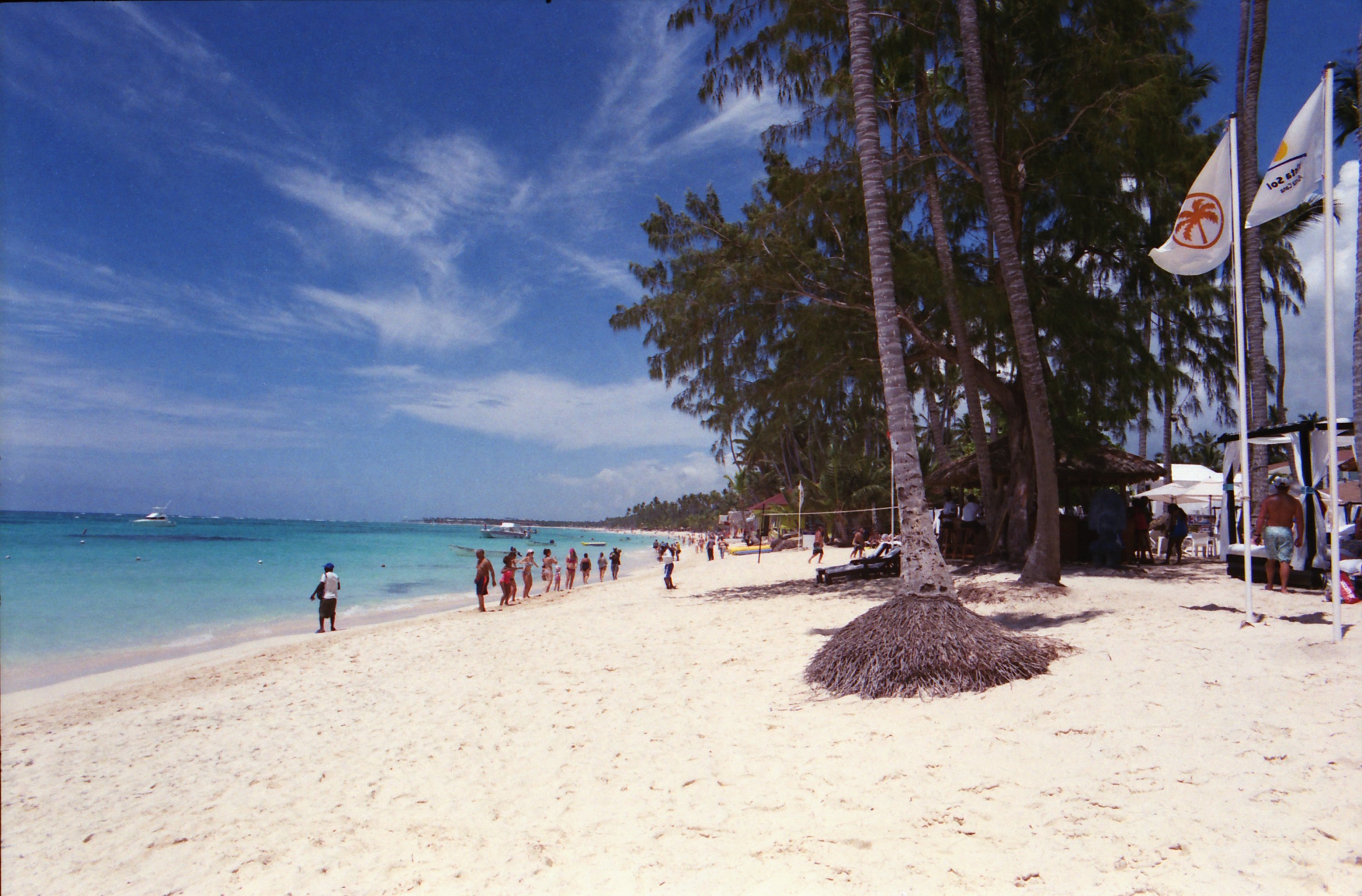

I'll attach a picture of one of the pictures that was commercially developed for comparison

Temperature does make a difference, but what a person sees and the level of acceptability varies from person to person.
In this case of your pics, I don't think the temperature or blix is the major problem per se, but a quick look at this kit online shows it to be a non-standard process. As I said earlier, I would not trust any process that uses 102F, and the description of this kit and your results seems to justify this lack of trust. I always use Kodak chemistry for optimum results. On the other hand I would suggest developing another roll as a test, being very careful with your processing.
Is the pic in your last post the lab's pic? If so, it to doesn't look quite right to me, but could be the scan, or a simple color balance issue. Is your film fresh?
Is this a reference to the beach scene pic in #4? If so what is wrong with it?

Both sets of negatives are scanned with the same settings on my scanner with no post processing. They are exactly how the scanner scanned the negatives. What do you think is off about that beach picture? Looks fine by my standards and if all my pictures came out like that I would be more than happy.
Maybe if someone has had experiance with this specific kit before I would be able to get a better answer as to what is going wrong here.
To me it seems like the contrast is too low. Is that what a "flat" image means?
To me it looks a bit blue, but it certainly is better than your scans from the kit processed film.

Just as an illustration, I copied one of your images and spent a half minute doing some quick post-processing on it. I see some crossover problems, but this may be closer to what you want, and should be easily obtained with some minor adjustments:

As Matt King says, my screen shows post #4 to have a blue or blue/magenta appearance compared to what I normally see on my screen, but could be largely fixed by simple color balancing. Contrast and density look good.
What minor adjustments did you to this photo to get the color issue corrected. Also what do you mean by crossover problems?
How do I go about taking this picture? Straight from my phone camera or something else?
I used Fast Stone Image Viewer to do my adjustments.
In the "Adjust Colours" mode I tweaked the gamma and contrast and brightness - just using the sliders until it looked better.
In the same mode I added small amounts of blue and green. Then I adjusted the saturation to taste.
The crossover problems - crossover happens when the contrast of the different colour layers goes out of synch. Note how the sky (a highlight area) has gone just a bit yellow green, while the shadows are slightly blue. While some of that is common when parts of a scene are illuminated by sun while others are illuminated by (blue) open sky, it looks to me like the mismatch is greater than that.

I did some quick adjustments to all of them. I'm not sure what's going on with the Eiffel Tower but the trees look right. I think it's most likely that the red and a little bit of the green channel are clipped in the highlights.
Have a look at this. http://www.coltonallen.com/getting-the-most-from-color-negative-film-with-your-epson-flatbed/
Basically all I've done is used GIMP (photoshop will work) to crop to just the image and then brought the edges in on the levels tool to the edge of each colour channel's histogram. One has a bit of an s curve added.
This looks most likely a scanning issue, but posting a pic of the negatives will still be useful to confirm.

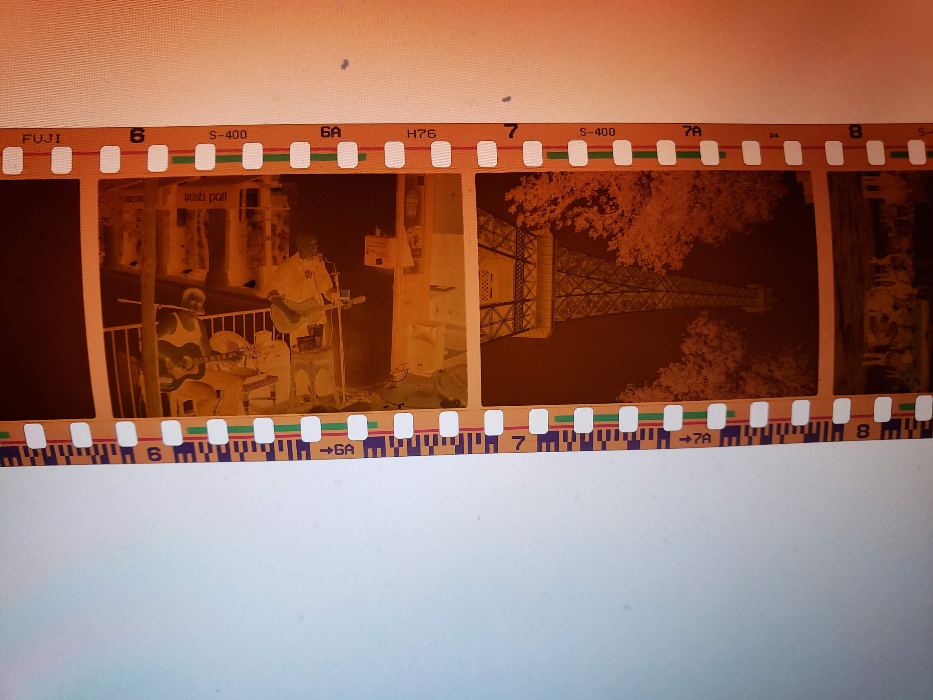

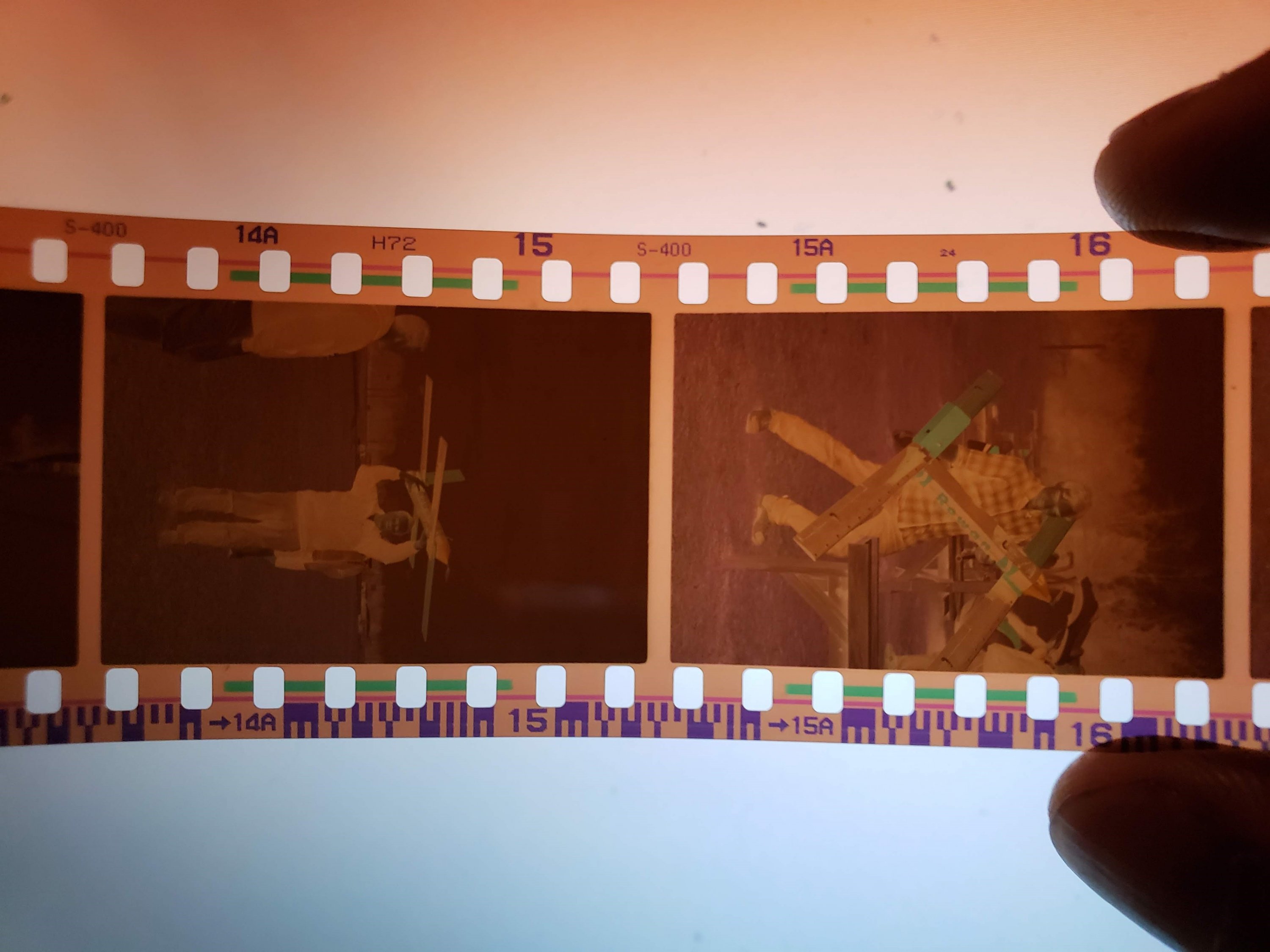

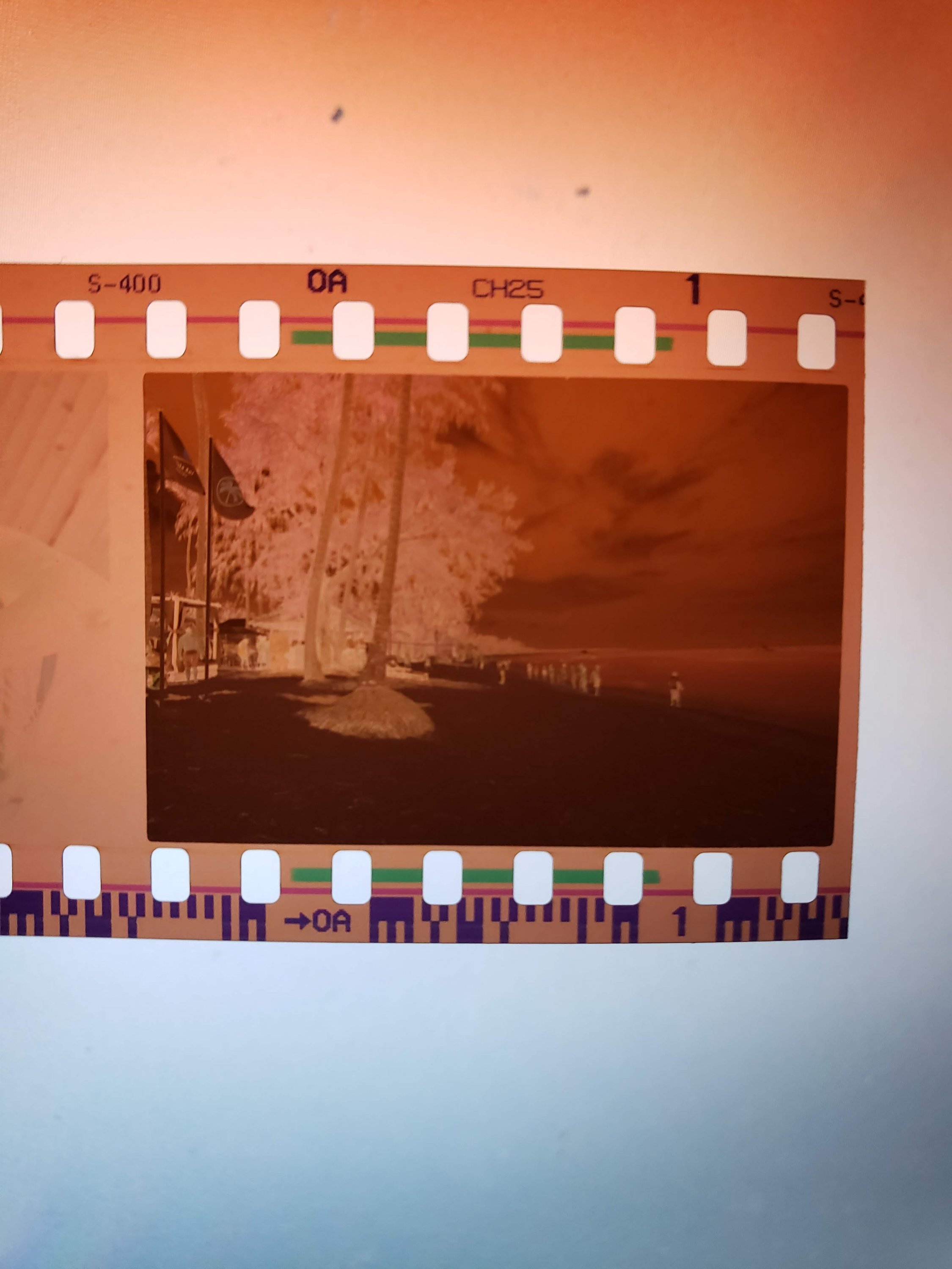

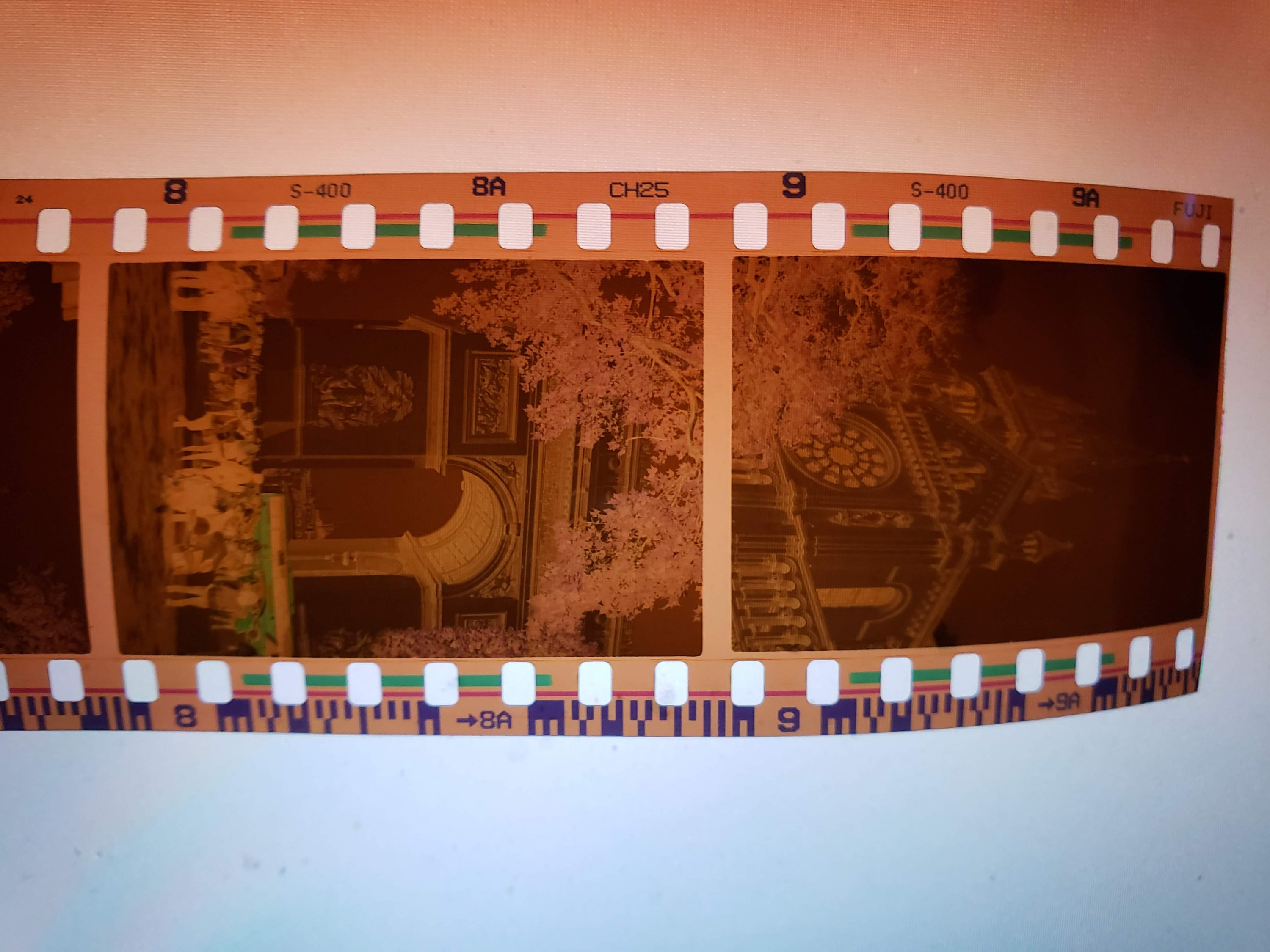

Hope these pictures are adequate. The last two pictures are from the lab processed results.

Based on the edge markings being similar, yours like fine. I'd wait for a more experienced opinion though.
Carriage
Feb 3, 2015
219
Melbourne
The text on the film in the rebates (the frame numbers, barcodes, etc) is put on by exposing the film with that pattern using light at the factory. If we assume there's no quality control issues, these should be consistent between rolls. Therefore, any difference between them as seen on different rolls can only be attributed to developing, not the camera. In your case, it doesn't look like the colours are different if at all, which leads to my conclusion that your developing is fine. Obviously, the white balance of your phone/digicam could affect it but given the very similar/almost identical conditions you took these photos in, its unlikely that the white balance is having an effect.
In other words, if there was a colour cast issue in developing, you should see the cast in the rebate markings too.

I do not believe the edge markings show enough information to determine if there is any crossover. Crossover is unwanted shifts in color with density changes, so one will observe or measure the color shifts only when such density changes are present as is the case with a typical image. The ideal subject is a gray scale. The rebate colors seen between the films are very close, so that is a good sign, but it does not tell all.
