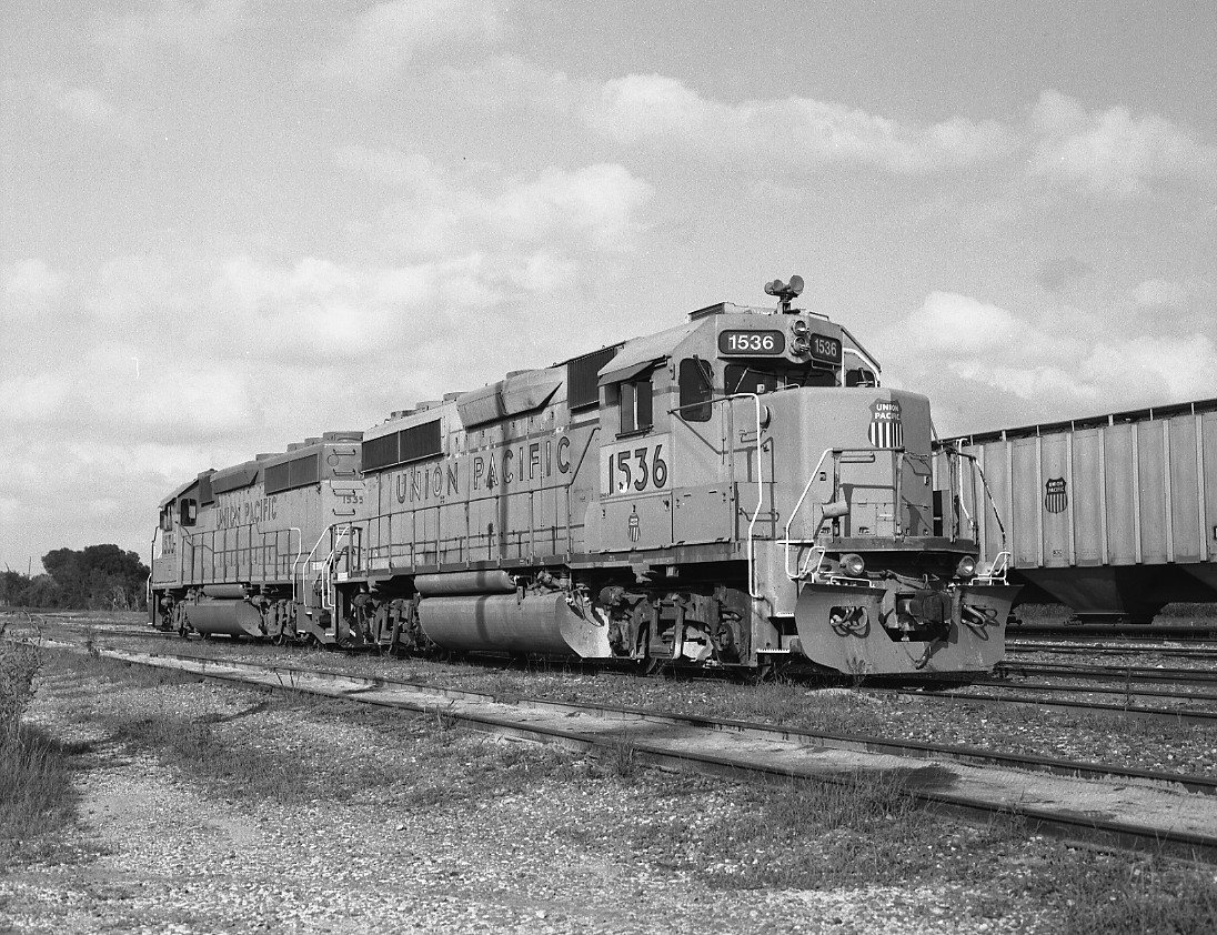

Arista.EDU Ultra 100 is made in the Czech Republic. The instructions in the box give a D-76 developing time of 6-7 min @ 68 degrees F, with continuous agitation for the first 30 seconds and thereafter 5 seconds agitation every 30 seconds. The film reminds me of Plus-X in the 1970s (the base even has a bluish tint). The attached photo (6x7 cm negative) was processed according to these directions, with a 6 1/2 minute development time.
Gary
