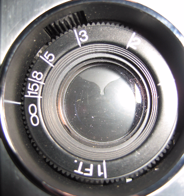

When it's closed you can see the "Pac-Man" shape of the shutter blade. In leaf-shutter cameras, this kind of mechanism is common. It opens partway to reveal a diamond-shaped aperture that varies anywhere from a tiny hole to a full opening.

Here you can see the "closed" SX-70 shutter blade with half of the "cats eye" iris showing.

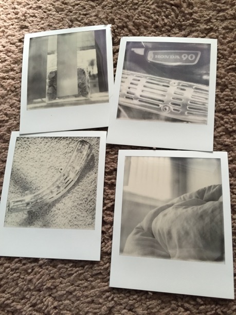

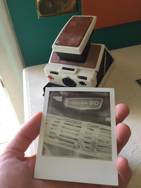

I just shot one off in broad afternoon (5:00PM) daylight in San Diego sun. Chrome and black subject. Here are a couple iPhone snaps of the mostly developed image. Should get a bit darker than this. Full dark setting on SX70 shown.
Also, I brought it out and pointed the camera to the sun. I can see it closing the aperture/shutter blades then opening them a bit and then closing again. If you plug in a flash it automatically sets it to stop down, so it definitely has an aperture.

Few more that I just took to show the darkening as it continues to develop.

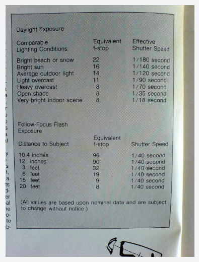

This Flickr discussion has some good information about aperture and shutter speeds. The image below is from that same discussion (I'm adding it here as photos often disappear over there, making it useless for future reference). This is for folding SX-70 cameras:
