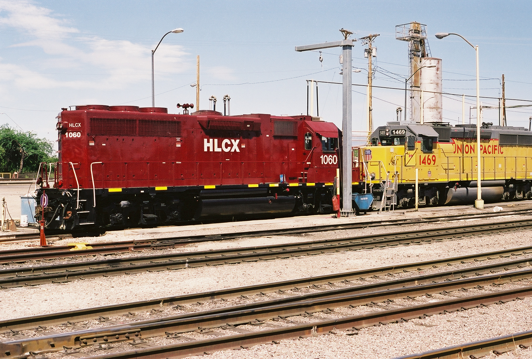

I don't do much photography of railroads and equipment, but I've done some. I recently took some photos at the Union Pacific Railyards in Tucson. I was using Fujicolor Pro 160s, which has unfortunately been discontinued. The characteristics of this film would, however, be quite close to that of Kodak Portra 160. I think you can see from the photo I'll post that the saturation and color of this type film is quite good, they're also much better for photographs of people with good flesh tones.
I'm not sure what photographic processing is available in your area, but I've had my negative film processed in Tucson with prints and a CD for $15.00, a nice package.
