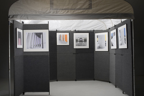

I use Pro Panels http://www.propanels.com They're expensive, but hold up well. I've had mine for about 14 years.
This is a booth slide I used for jurying, a few years ago (you'll see both light and dark gray panels. Given a choice, I'd opt for all dark gray):

If your looking for a cheap alternative, try something like this: Dead Link Removed Use large shower curtain hooks (the lockable kind) and some weight at the bottom. Use metal curtain hooks to hang the frames. This solution will work with a tent with a solid frame. It won't work well with an EZ- Up tent. If you plan on doing outdoor shows regularly, invest in a good tent. They run about $1000/new but are worth it. Cheap, light tents don't last, or protect you from the elements. The tent in the photo I posted above is a Craft Hut. There are 3, or 4, good tent makers.
