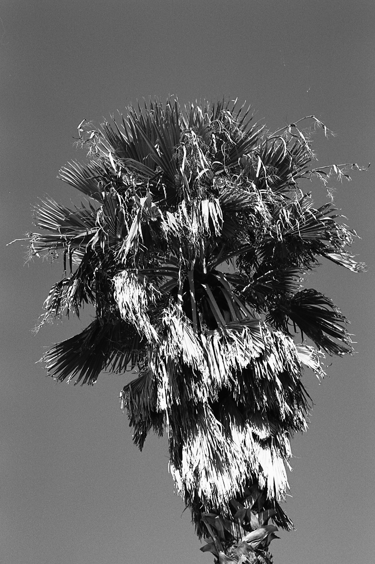

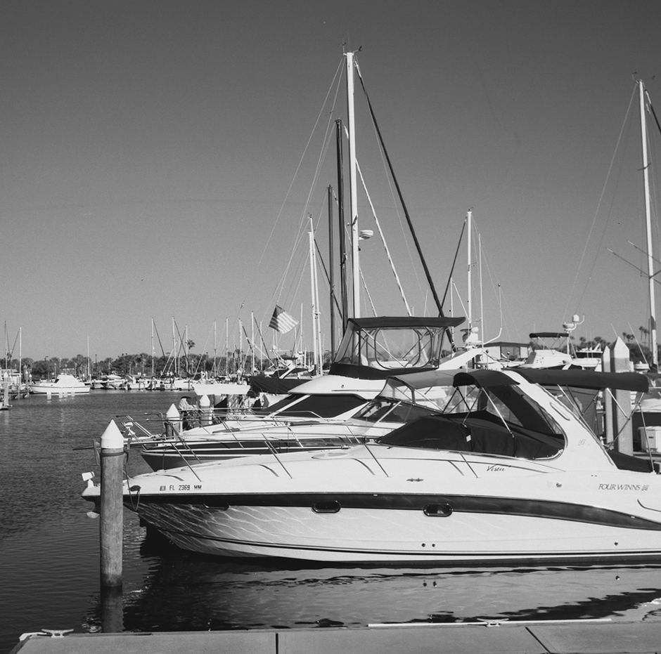

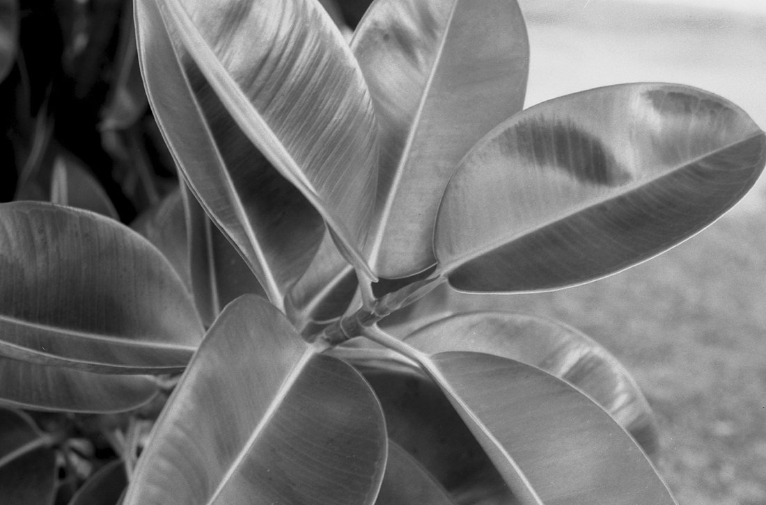

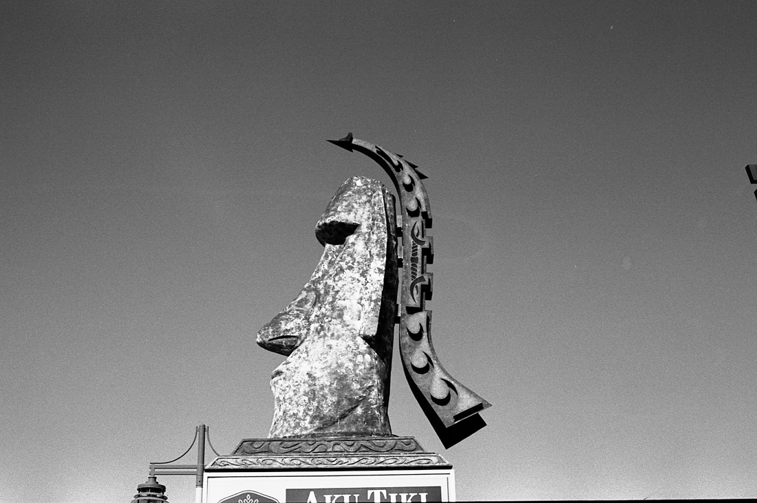

I developed some Tri-X negs in Microdol-X for the first time. They sure look odd. I followed the times and temps from digital truth....12 minutes at 68 degrees at 1:1, and added one minute to that. The agitation scheme was 30 seconds, then 2 inversions every 30 seconds. Strange tonality. These were shot in bright sun at iso 200 w/ a yellow filter, and I let the camera's meter take care of the filter factor. The shots I took at 400 seem a little better. These are just scans. I haven't got to the negs from the low light shots yet. Hopefully they look a little better.

look fine to me. in what way do they look odd? Adding a minute would pushed them a titch, adding to the contrast a titch.
But as I said, they look fine.

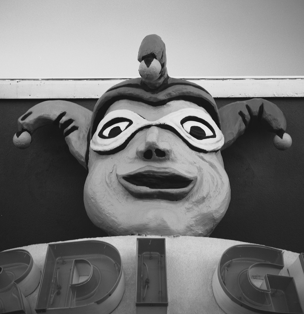

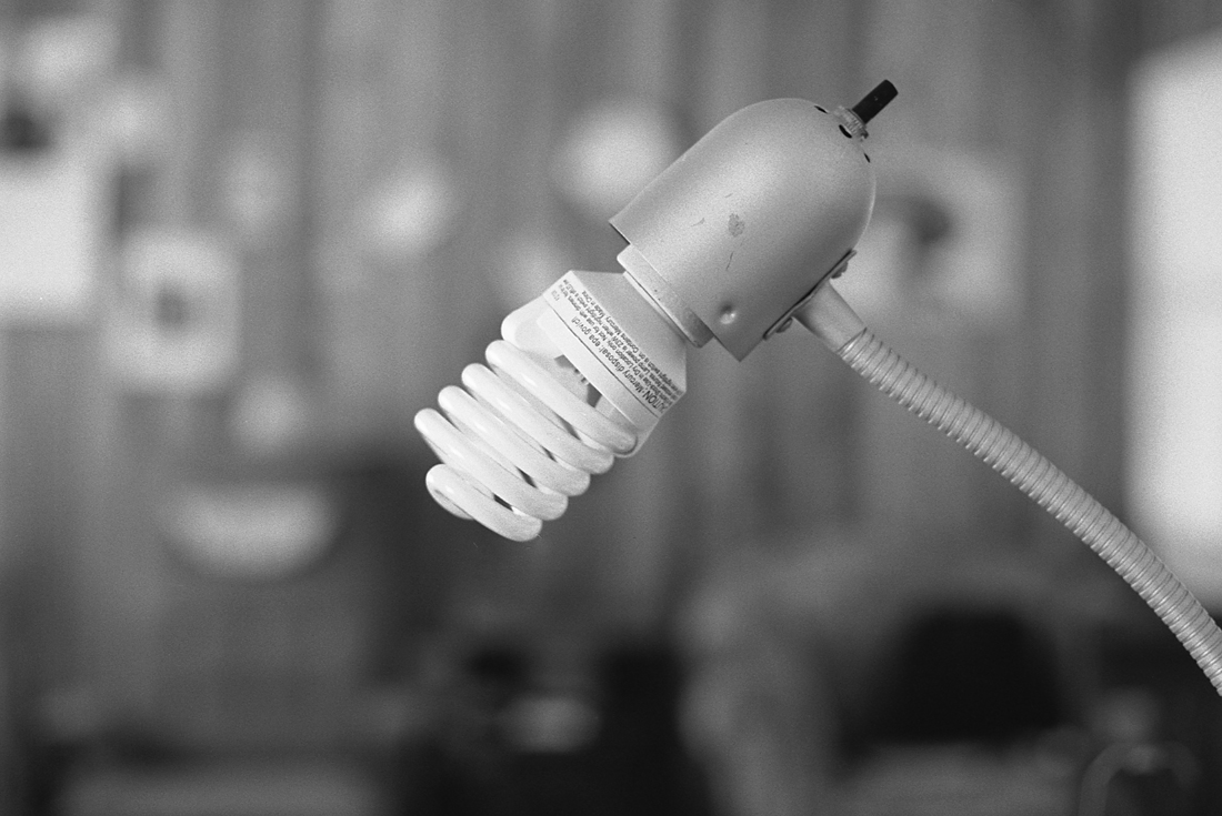

I suppose I'm just used to TD-16 (D76 variant) and Rodinal. The negs above look, to me, like what everyone complains about w/ this developer. Flat, and mush grain. Here's a couple of the low light samples that I took, and they look much better, but they still don't have any punch. Next time I'll overexpose it by at least one stop and add 2 or 3 minutes to the development time and see what I get.

"Mush grain" is how that developer works -- lots of silver solvent to dissolve the edges of the grain to give the impression og finer grain. I used it 1:3 for 120 film for several years. That dilution reduces the affect of the silver solvent. Nice negatives to print, but back then I was using mostly Pan X.
If your shadow detail is where you want it, do not change the exposure.

Thank you for the tips. It may just be that this is the way this developer works, as you mentioned Vaughn. I don't care much about shadow detail one way or the other, but I'd like to see more contrast and deeper blacks, especially as this is Tri-X. It looks like %$#& Acros in some of the shots! Gray, grey, grey. No tonality. I realize it's just the first time w/ this developer, but I suspect it's not going to be capable of giving me what I'm after. Several people here warned me of this, so I can't say I'm surprised. The camera was an AE-1P w/ a FD 50 1.8 lens by the way. I considered 1:3, but the development time was around 20 minutes, and I dislike using long times like that. Too many opportunities to mess up the agitation cycle.
I actually shoot Tri-X at 100 now and then, but develop it in D76. Really hard to screw that combination up. Yes, it blocks up the shadows a little, but the tonality is really quite nice, and the blacks are to die for. Works better w/ 120 film.

I got a look at some of the shots that came out better on this roll, and may (may being the operative word here) have a better idea of what is going on. On the shots where the exposure is nailed, all looks fine. It's as good as any developer. On the shots where exposure is off, even one stop, it doesn't look so good. These were difficult lighting conditions outdoors, what w/ the noonish sun and the beach, so I expected to have some problems. And I had issues w/ this lens once before giving somewhat erratic results down on the beach w/ another developer (FD 50 1.8 w/ a yellow filter), so that may be a factor. After looking at negs that were made w/ the same film (Tri-X) in the same conditions, but were souped in D76, it looks like if I get everything right exposure wise, it's fine. But the Microdol-X doesn't appear to have the same flexibility as D76. This developer doesn't seem to like brightly lit beach skies as much as D76 either, but w/ only one roll shot, who knows on that one.
If you look at the rock pic on the link below, I simply moved the camera's ISO from 200 (w/ a yellow filter) to 400, and got a huge difference on the neg. After going back to some ISO tests I did w/ Tri-X and D76, there was not this sort of difference. So I am going to buy some more Tri-X and shoot in in my Nikkormat to get the FD 50 1.8 lens out of the equation and see what's up. Anyway, on the shots that worked, it looks just fine.

I got a look at some of the shots that came out better on this roll, and may (may being the operative word here) have a better idea of what is going on. On the shots where the exposure is nailed, all looks fine. It's as good as any developer. On the shots where exposure is off, even one stop, it doesn't look so good. These were difficult lighting conditions outdoors, what w/ the noonish sun and the beach, so I expected to have some problems. And I had issues w/ this lens once before giving somewhat erratic results down on the beach w/ another developer (FD 50 1.8 w/ a yellow filter), so that may be a factor. After looking at negs that were made w/ the same film (Tri-X) in the same conditions, but were souped in D76, it looks like if I get everything right exposure wise, it's fine. But the Microdol-X doesn't appear to have the same flexibility as D76. Well, what do I expect? How do you improve on Tri-X in D76 for flexibility? I don't think you do. This developer doesn't seem to like brightly lit beach skies as much as D76 either, but w/ only one roll shot, who knows on that one.

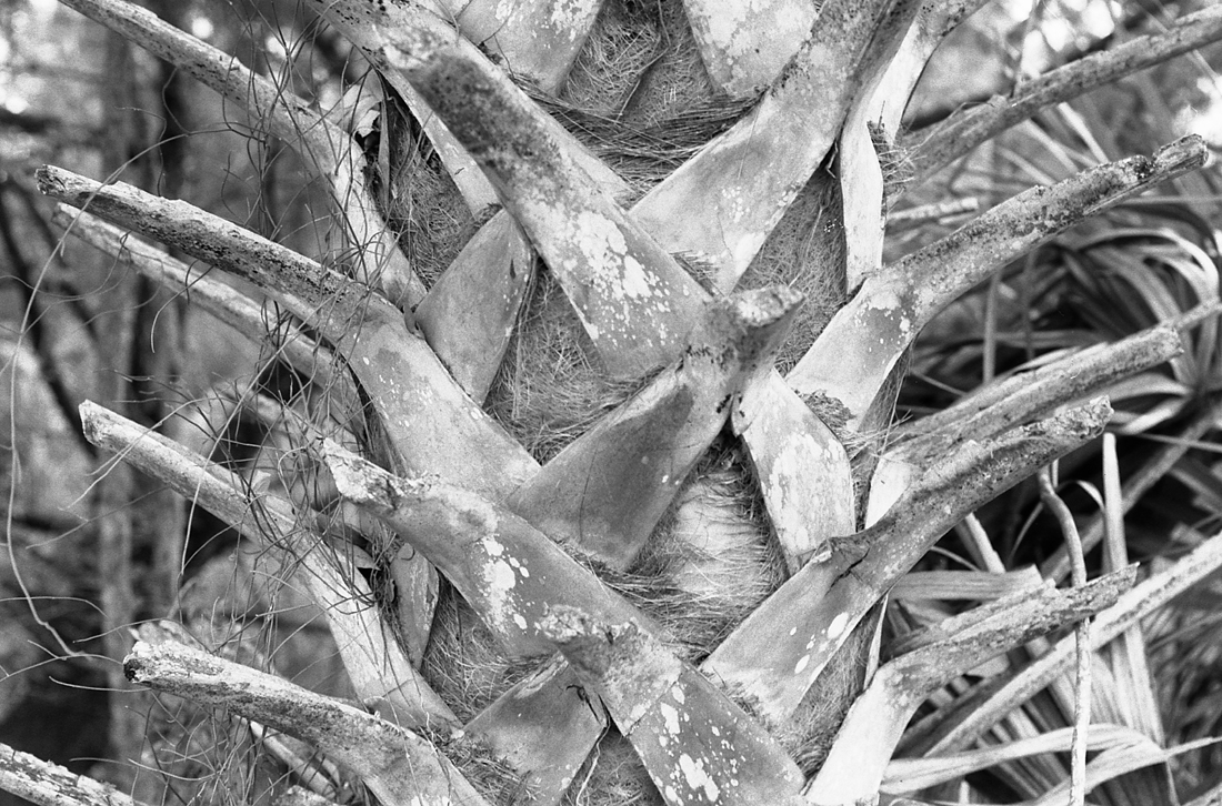

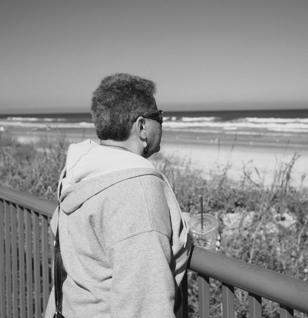

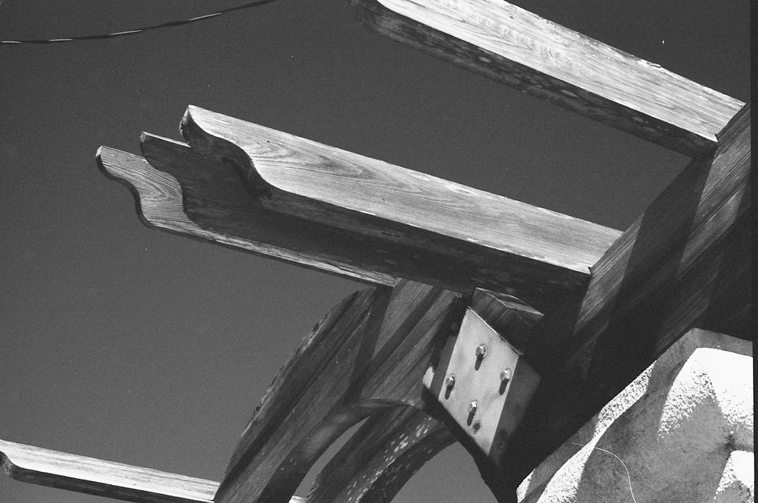

I switched over to using the developer full strength instead of at 1:1 (8 minutes at 68 degrees), changed cameras to a Nikkormat FTn w/ an H 50 2 lens (and halfway through the roll put the film into an FG that was hacked to shoot the non AI H 50 lens), and switched films to Arista EDU Ultra 100 that was metered around 60 (w/ a yellow filter). Much nicer. Very happy now. From now on I use this developer full strength w/ the Arista film in the Nikon, and stick to D76/TD-16 w/ Tri-X. That will work :]

I like these.

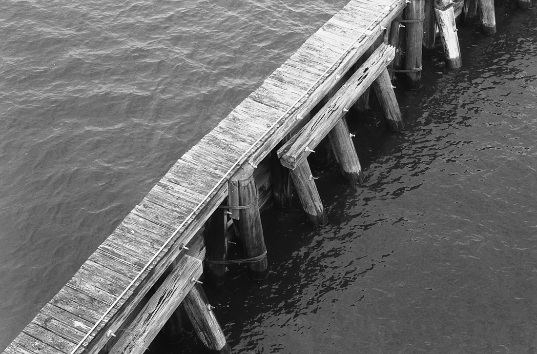

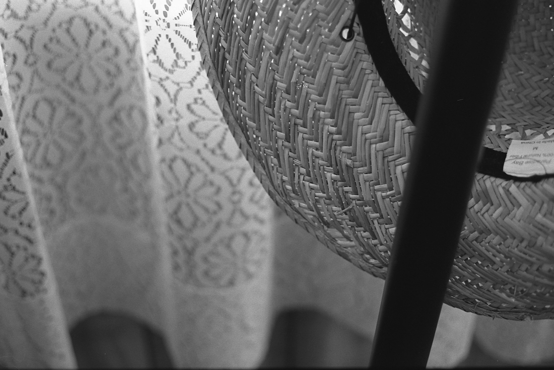

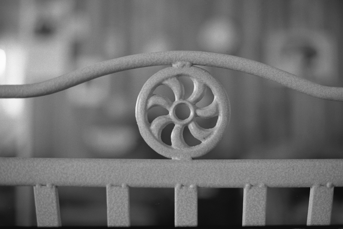

This is a very nice developer, but it works better for me at full strength, rather than diluted. These are my first attempts at developing Shanghai GP3 Pan 100 in it. They're over exposed, and over developed, but show promise. If exposed and developed correctly (there are no times on the massive development chart for this combination), it looks like 10 minutes at 68 degrees might be good. From an Agfa Isola w/ a yellow filter at high noon. These got 13 minutes, which turned out to be too much. The contrast is off the wall, but the grain is very tight. The Shanghai film in this developer looks very similar to Tri-X in D76 to my eyes.

I know MD-X is a very flexible developer. I use it 1:3 as everyone does but full strength is very useful over here in the bright Hawaiian sun; shaving off a bit of real film speed comes in handy and 1:0 especially Replenished gives a very soft yet clean look to those bright white bridal gowns (especially those UV enhanced ones LOL!) in full sun. A similar look can be from Xtol replenished but Tmax 100 at 50 in MD-X 1:0 either fresh or replenished gives as close as I've ever found to Panatomic-X and was Kodak official Panatomic-X replacement when they discontinued Pan-X. Perceptol 1:0 is close but that mystery X (see my persistent inquires of Photo Engineer over the years LOL!) really does something when used 1:0.
