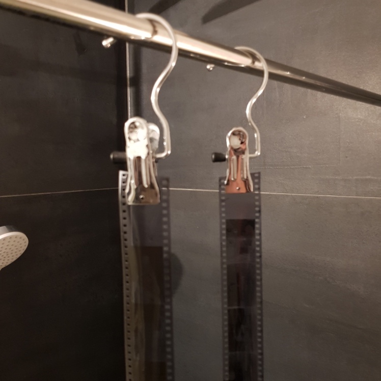

I also use the Mod54 clips, like them even for 135 film. Get some stainless steel hanging clips in the local hardware store and peel off the black rubber tip. Then you have the Mod54 clips right in your hand... .
They hold the film safe, don‘t damage it and have the weight you need for 135.

I hang sheets of film and paper from a corner because it drains best like that. Using mod54 clips you only need a tiny bit of the corner, especially for film.
