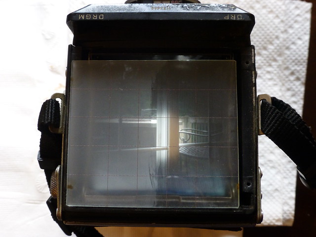

I've heard of waxing before, but have never tried it. Do you just apply the wax to the ground side of the screen?
That is all there is to it. If you have solid wax you will need to thin it. I wipe it on then wipe off any excess. You only need a light coat. It is completely reversible as well.
The other way I have heard is to use shellac, but I think that is too much trouble.

I wonder if Johnson's Paste Wax would work? Guess I'll be trying this tonight. Thanks for the tip!

Thanks again, everyone! Did some more work last night, including waxing the screen (used Minwax paste wax). Amazing difference. It's a toss-up though - creates a hot spot on the screen, but more definition and brighter overall.

Fast, I'm not sure what's going on with the waxing, as it makes the screen more transparent than translucent, but there's a dramatic increase in "pop" and brightness. Downside is that it creates a hotspot in the center of the screen that seems worst in dim lighting conditions...
It seems to reduce the spread of light so more of it goes perpendicular to the glass. the result is a brighter image but a more narrow viewing angle.

It looks like the hot spot in the waxed screen is actually because the screen is now so transparent that you can see the lens.
I think that's accurate, but I don't know that there are varying degrees of applying this wax to the screen (i.e., varying degrees of transparency/translucency). I might try stripping the wax and applying a light coat of dewaxed shellac (I've read that has a similar effect).
Jul 31, 2012
3,355
If the screen has a hotspot then you put too much wax on it. The reason why older screens are dim is because the grind of the screen is rough. The wax fills in some of the ridges thereby increasing the transparency. If you use too much, you fill in all of the edges that refract the light. If you have a hotspot, you need to thin the wax so use whatever solvent you need to do so. Keep in mind you can take off the marking on the screen with some solvents. Be careful.
The other alternative is to place a fresnel over the screen or of course just replace the screen with something modern. The wax trick works though if you do it right.

I need to strip the wax off of the screen. Hot spot is too distracting, and too difficult to compose around. I may try thinning the wax, or just leave the stock screen as-is. It's way cleaner now than when I got it, anyway...
