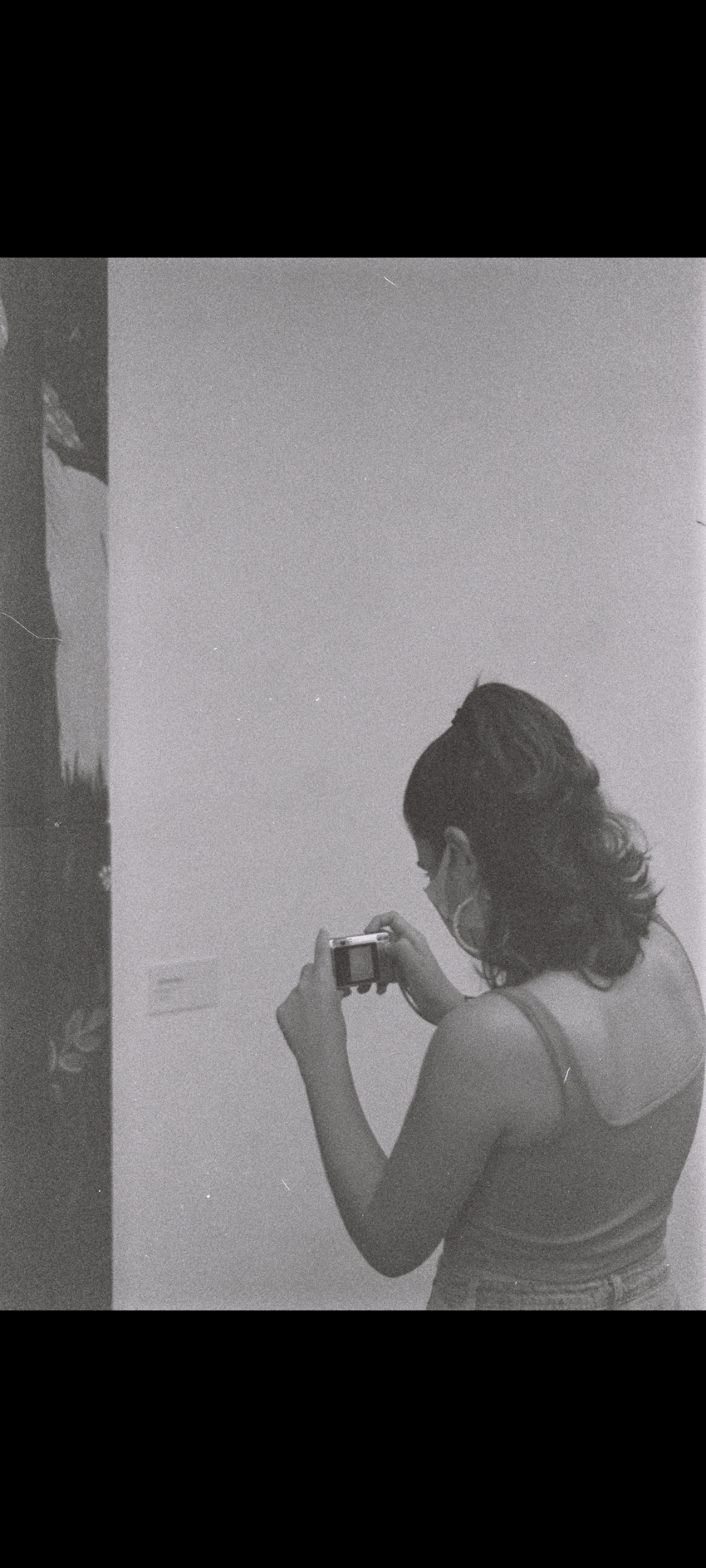

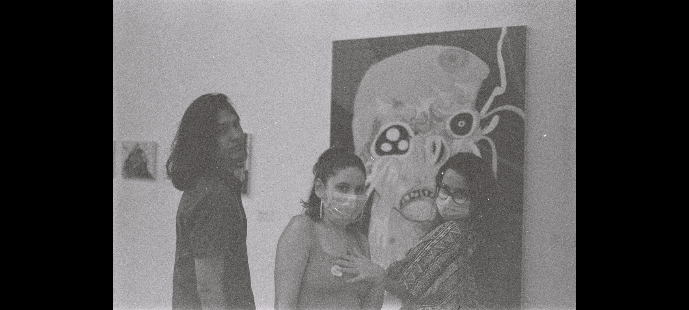

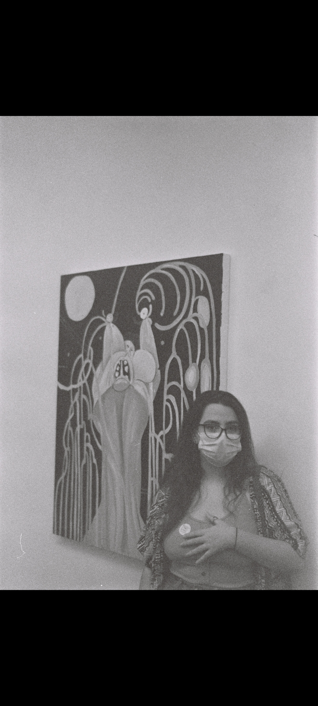

Hello. It's been some time. Finally processed my first roll of film. As I said on a previous post, I tried pushing one stop, since I was afraid I had underexposed some (it was 250 ISO, so, having decided to push one stop, I shot the rest of the roll as 400). It was a show and I couldn't meter very correctly, so at the time I just tried to make it as bright as I could. I'll attach some of the pictures!
I have only one question though. Is the low contrast (kind of a washed up feel) on some of the pictures an effect of having pushed the film? Or is it maybe just the film I used? What are the other effects? More grain?
Also (like a stupid FOOL) I mistakenly opened the back of the camera with the film still inside and lost half of the roll. Just thought it would be fun to mention.
Anyway, I kinda liked the result. No point in shooting film for it to end up looking just like digital, right? Already shot another roll and I'm sure it will end up way better than this one.
* black and white cinema film, 250 ISO (shot as 400) - Nikon Fe - Nikkor 50mm f/1.8 *

It's just underexposed. Live and learn.
You can boost contrast in Photoshop of course. It will fix the "washed out feel" but it won't bring the shadows back.
Don't expect images that come directly from the scanner to be the final representation. Some post processing is always needed unless the scanner software does it automatically for you (which is the case with many scanning setups).

If you shoot the 250 film at 400 exposure index, you will have to increase the contrast be either using a higher # grade paper or increasing development time.
For example if your posted image was printed on a #2 paper, a #5 paper might look like this:

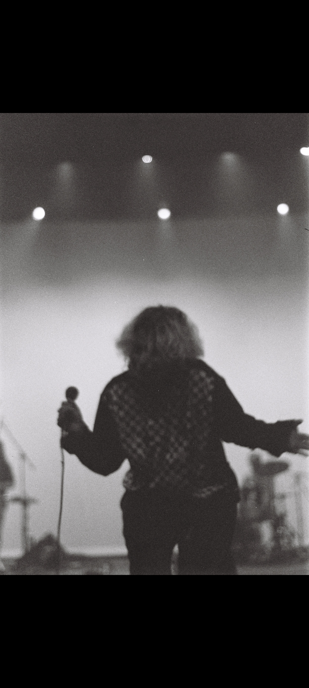

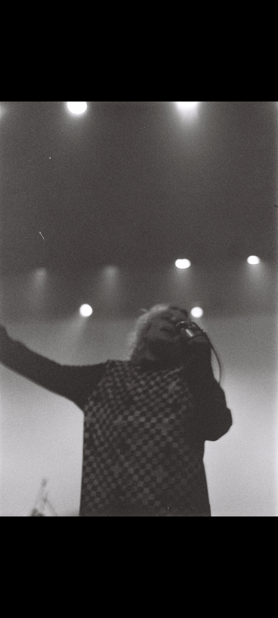

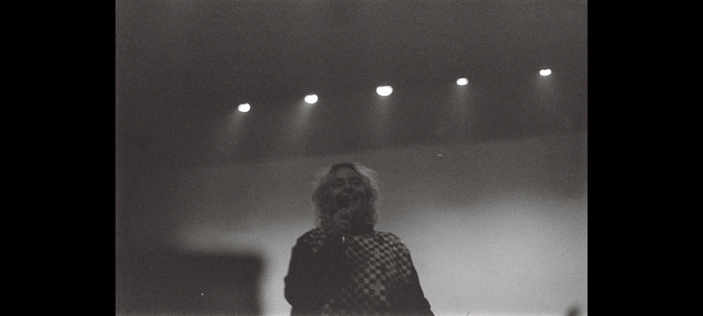

It is important to concentrate on the light. It is better not to depend on the film/development/scanning/printing to improve one's lighting.
It takes experience to draw out quality images from difficult lighting conditions that you are working with in the examples you showed. The singer is back-lit, for example.
Also, you should learn to meter 'correctly' in these types of difficult lighting situation (you might have benefited from bracketing your exposures). You can get away with a lot more out in the landscape than indoors.
As @Vaughnhas said, backlighting will cause you problems unless you know how to handle it.
Most concert/stage photography, taken from the front of the audience area, is looking up at the stage and this image usually includes some of the stage lighting. Light coming from behind the subject will give the camera a light reading that can cause the subject to appear silhouette.
No amount of film development and compensation will correct this fully. Better to expose correctly (easier said than done). Concert photography is notoriously difficult.
A member @Agulliver has plenty of experience shooting in small jazz clubs, etc, under difficult lighting. I hope he doesn't mind me suggesting you could ask him for some advice.
